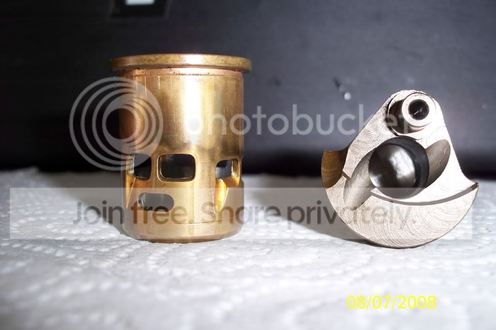

This is Jeremy`s Sure Fire .32 R sleeve & crank

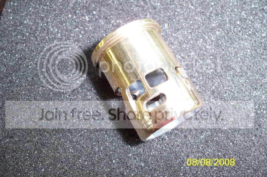

I did a simple mod on sleeve, removeing sharp corners and rounding the base of the cylynder
to promote smoother air flow.
To squeze a little more RR`s I widened the exhaust port at the top outside corners slightly

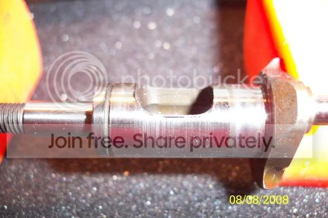

I removed .2 tenths of a mm from closeing side of crank throat , This will make the engine
better in accelerating and will run a few more rpm's.
conclusion: IMO this mod made a good improvement in an already great engine

Very nicely done. I'm sure it will rip. The little modding you have done will make a killer engine. The video you have posted shows ho snappy and powerful that motor is. Looks to have great low end and I'm sure has great high end power. Very nice work on the crank modding as well, this is where it bets more difficult.
Great work and thanks for the thread. I can't wait to see the vid when running it and to hear Jeremy's response when it's back in his hand.
Benny, I just did a Mach .26 if you look at the other forums in this section. The motor rips. It is a much much stronger mill that it was before. I am currently working on a S-25. Will post picts when ready in a new thread.
Nice Job Crash, I love seeing modded engines, and nice work, should see some great improvements over stock, especially with the timing change on the crank, I like working on the .32 sleeve/crank. I'm gonna be taking my LRP apart tonight and see what improvments I can make, likely just some flow mods and a good polishing. +rep when I can.
That looks like a nice job you did there crash, you will see a gain in performance from the crank timing for sure.

yes, its a sure fire 32 R
The R means it has some fancy porting from factory (notice the fangs)
I did very little to the sleeve
this sleeve and crank are identical to the axial 32 set (except the fangs)
