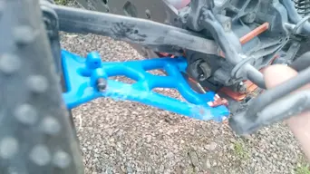

New clutch shoes today and the car is running again. Or was, until I hit a concrete pole with the right front wheel at full speed.
Broke the metal axel holding the a-arm to the diff housing, cracked the diff-housing, broke the front alu-bar straight off, popped the shock right off and twisted the new RPM a-arm.
So, basically, the only thing that didn't brake, was the new a-arm from RPM, it is indeed gooooooooood stuff :) And on top of that, after a short visit in the vice, it could be twisted back into position again, really good stuff :)

Damn did a good job that's for sure....lol yeah sometimes the fixing time out weights the drive time :D. Not so bad if you already have the parts to fix it not so much when you don't lol.....nice carnage there though.
