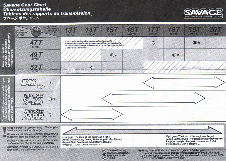

Would anybody know if 47/16 would fit the savage without modifications? I have a spare 16t clutchbell. I'm only asking before I pull the engine out or decide to order another 17t clutchbell.
James, it will fit. Here is a chart that gives some idea of the ranges that fit without modification. The 16/47 combo is a bit on the outskirts of meshing correctly though.
47/16 requires a steel spur to work. I should have said that in my first post. I ate the teeth off of several plastic spurs but had no problems with a steel one. It was my favorite gearing with the 4.6 and Big Joe tires.
