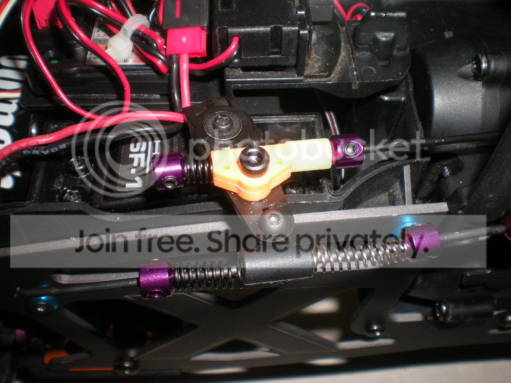

Kind of like I have this one the lower linkage with the 2 collars and springs, you can use fuel tube also and it works just as well, I do not have an octane, but possibly this may help, also a stronger throttle servo will help alot as the throttle servos on the stock rigs are notoriously weak on the savage nitro models and i am sure they are just as weak on the octane version...
@Jam Racing 1 thanks for the picture .. Looks like a heavy duty mechanics .. I decided to start with the simple stuff .. I add two nylone rings at the heads of the screws. The mechanism is now totally working with just the smallest move of the lever. While the drive shafts are rotating freely while not applied.. Looks as the good of all worlds .. Doesn't it ?
