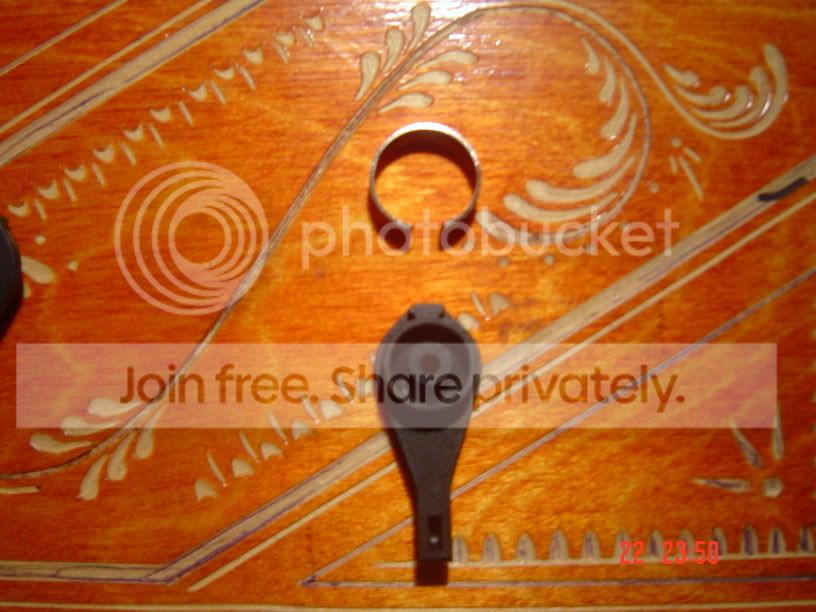

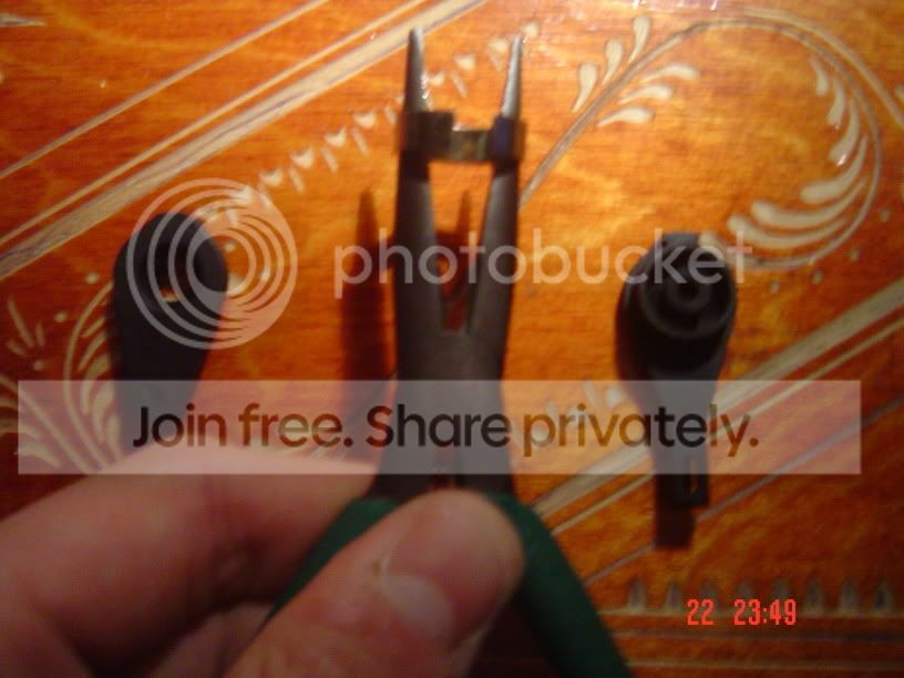

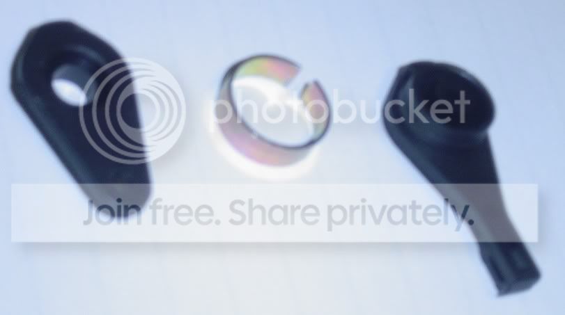

first take the throttle set up off the car
then take it apart, into the 3 peices...
then take the metal ring and plyers and just stretch it a little... just enough so that if fits over the plastic part without having to stretch it.... this way it stays on yet doesnt require as much effort to move...
if u needed u can stretch it a bit more, although once its over the size of the plastic thing it starts to become a bit unstable... just wobbly, but other than that go for it... i have it set up so the car stops nicely yet not too strong so that the car flips brakes the body, front diffs and scratches the heatsink... well thats just what i found if u also have your slight mod post it fun to see :p i don't mean like a throttle mod kit, more like homemade/ cheap versions...

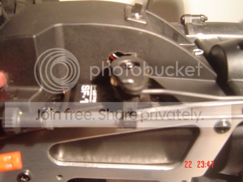

My servo doesn't go into the nuetral position like it says in the book or like in probers pics in the post above, it is about 1 cm off. Any idea how to fix that?
Aslo from the pics, I put some fuel line between the spring and screw, but I see that prober replaces the spring completely. Which is best?
