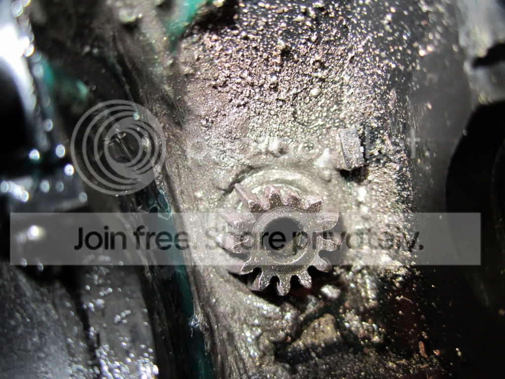

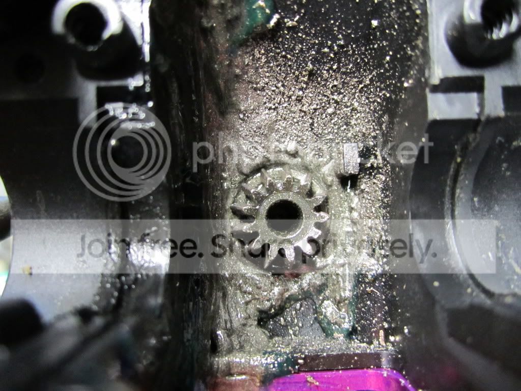

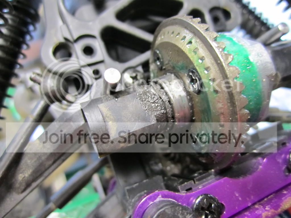

A bearing failed in the front differential. And stripped a couple of gears.
I look have research a little with the bullet proof. I am running 2 wheel drive right now. I cant stop bashing I have to stop now cause a stampede is on the same freq as me.
I highly recommend the bp diffs, lost a couple bearings on the bp's and they lived through it. My standard diffs always ended up like in the pics
Ok, thank you. Just curios what is the bearing for in the pic. I plan to use Boca bearings in the diff. The one bearing in the pic has me thrown off.

The one bearing included is intended for a plugnplay experience being that the id for the ring side is smaller.

You should replace both if you are going with the bullet proof diffs.. The BP's are 29/9 and the stockers are 43/13 i belive..
Oh. I didn't realize that. I guess I will have to order another. I will be taking the rear apart any way to replace bearings. I was just trying not to spend a lot of money.
