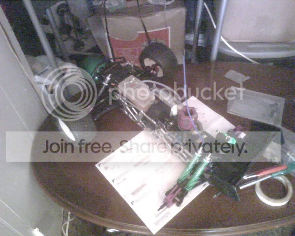

Okay the truck is spotless thanks the the wife. I have it put back together minus what I cant do till I get the RSC. Looking good guys.

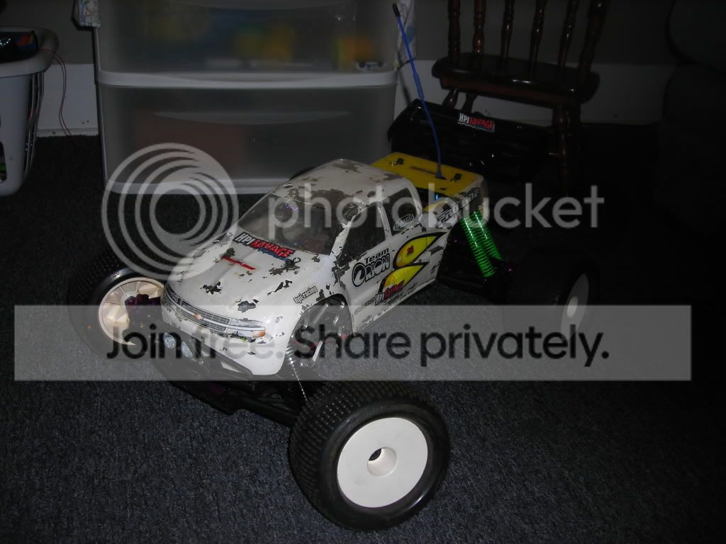

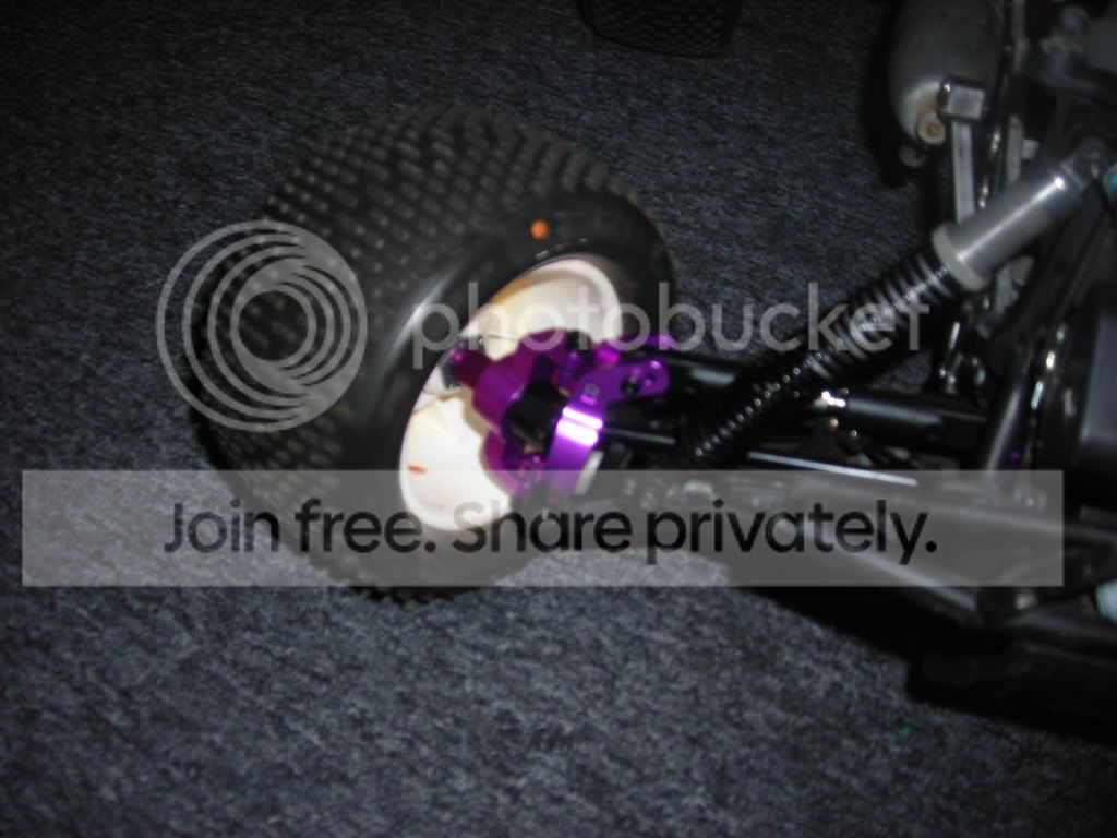

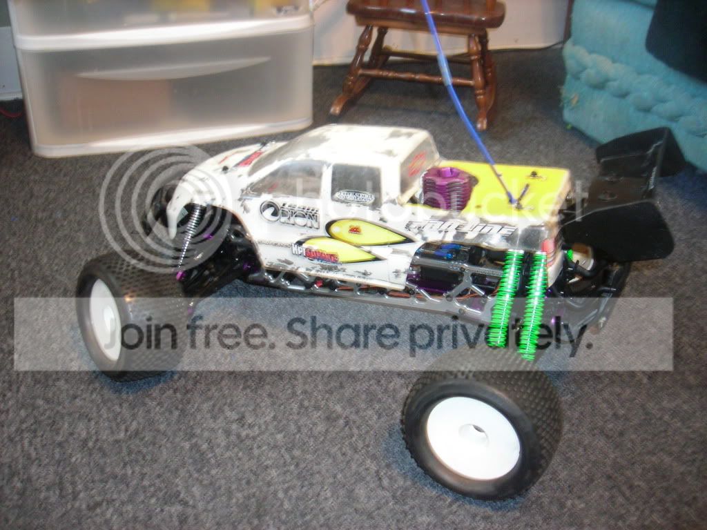

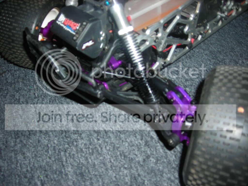

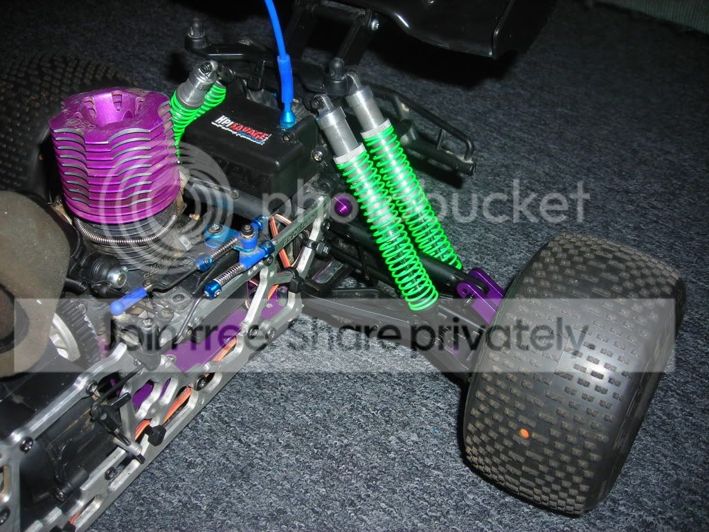

Here is a pic I snaped this morning before leaving for work sorry I only had my cell and was in a rush.
What I did:
New Diffs w/ alum housings (10000wt in rear 20000 in front)
Front and rear sway bars (lst sway bar kit w/ some moding)
RSC (Thank you HPISF)
New bowtie tires (Thanks Bank)
Shock rebuild (40wt in front 30wt in rear and green springs in back 1" spacers in shock in front 1/2" in rear)
New savage XL dogbones and axles
Complete break down and cleaning of the truck (A big thanks to my wife on this one.)
All total about 4 hours of work on my wife's part and 11 hours on my part.
Yeah, now your talkin! Savage Race Truggy. Gonna feel like a whole new truck on the track. Nice work Mr. & Mrs. The Pope.
