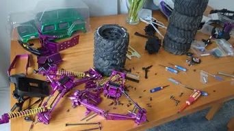

Deconstruction began in vein yesterday
Found a few nasties, but this was the worst...
Time is hard to come by at the minute as i'm trying to pack to move house, so this will be slow.........
