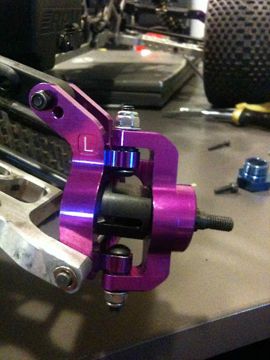

I was not able to get the nut on to clear the XL outer with the tolerances I was comfortable with, so I just inverted the process:
Instead of going from the top down, I went from the inside out. All it took was 2 M4x20mm button head screws, 2 washers, and 2 lock nuts - and voila!
Hope this helps 🙂
Bob
Whoops just thought about it and I guess if they are hex heads a standard allan wrench would do the job, can't tell what they are in the pics LOL!
Yup, they are hex heads, and i used a ball driver yo get them in place. I was able to get them installed in 5 mins per side, once i got done scratching my head like Homer Simpson trying to figure it out 🙂
Bob
Hope this helps 🙂
Bob
Looks familiar. That is what I did to mine
Crap! Wish I had known that, would have saved me 20 mins of tryin to figure out how many washers to stack on the bolt to keep the nut out of the axle LOL.
Hey, no one ever accused me of being the sharpest tack in the box...
Bob
Great write up! I had the same problem and I fixed it the same way. I like the locknut idea too. Stock screws are way too short.

Helpful thread guys, reversing the screws is the first thing I thought of after the first few posts. The obvious fix. :stickpoke:😛eace:
