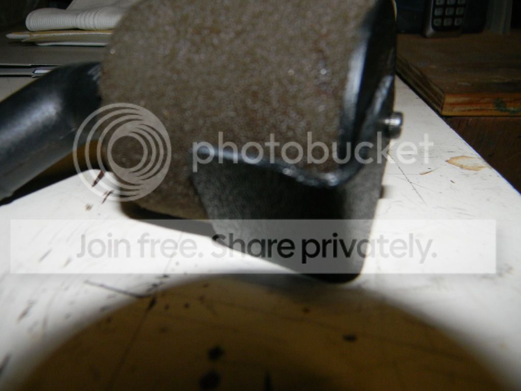

Recently I found out that the clip used to lock the radio box digs into the air filter foam on my Savy's filter and leaves a gap where dust can eventually enter the filter itself:
I double-checked that my air filter was fully seated, and it was. So I thought of a fix:
I took a small piece of plastic, heat it with a hair dryer for a while to make it more flexible, then bent it to a 90 degree angle. I then CA-glued the soft side of a velcro stripe on it to prevent rattle. Finally I CA-glued the tab to my air filter cap, like so:
I hope this tip can help people who still have the stock air filter!

Here's an update:
The protector tab holds very well and it does prevent the air filter from deforming and letting dirt in. If I had to do it from scratch again though, I'd probably make it wider so the protector is always in contact with the radio box clip. While the protector works very well and there is no deformation in the air filter foam, sometimes when bashing the air filter moves from side to side and the protector doesn't line up with the clip.
I ran about half a gallon with this and it holds up very well to date! Overall this is a very effective mod I'd say.
Here are some pics of the post-bashing protector tab:
