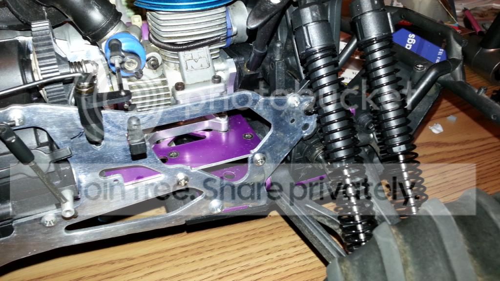

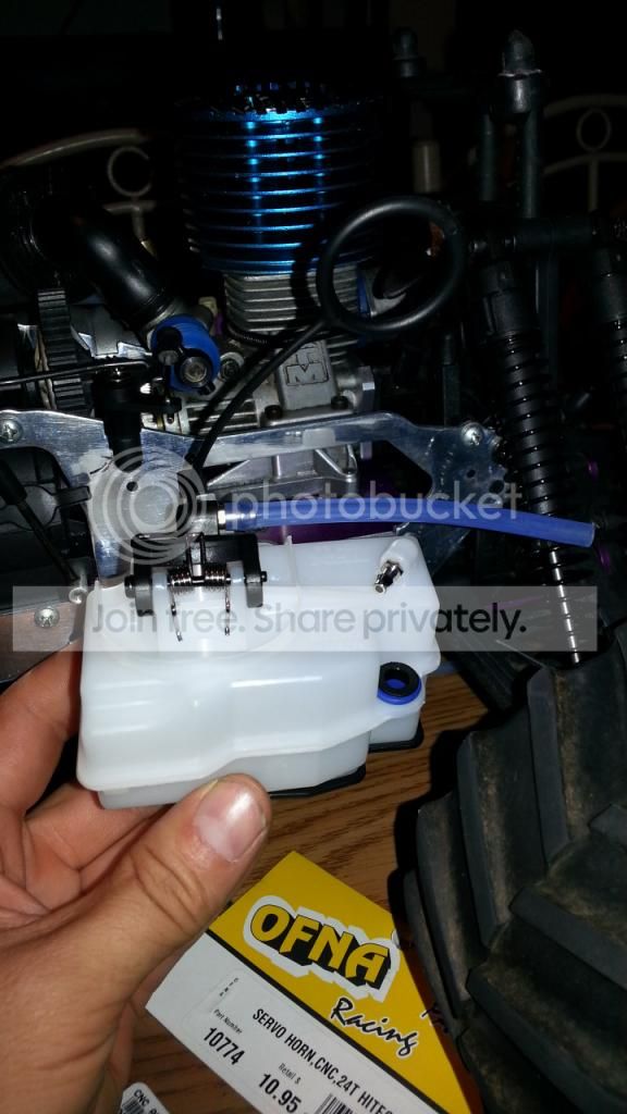

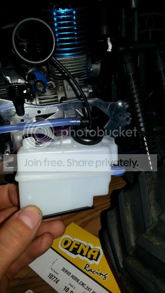

Not getting far tonight. New shocks is all so far. Really having a brain fart on figuring out a way yo mount revo tank.
How about the steering setup, did that at least go well? maybe post a pic or 2 of that revo tank ya wanna use and maybe someone will have an idea for ya......

Also how does that revo tank mount, thru the bottom or on posts of some kind ?

Yes..revo tank mounts same as a savy does on posts.
OIC well thats a great score for 60 bux on the wheels and tires, now for that tank mounting and maybe soon you will be breathing some nitro fumes again......
