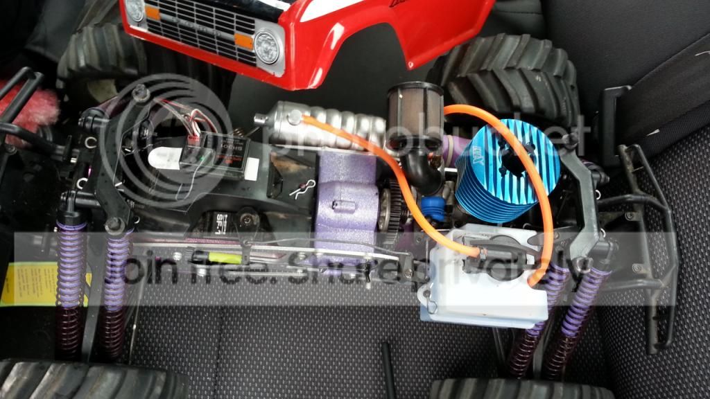

Well I ordered up a complete Revo 3.3 tank and gonna go against the grain and try this out. The volume difference between the Revo and Savvy tank is only 10cc. I was experimenting with the tank that is on my revo last night and I think I have an idea for mounting so it doesn't stick out angled like it shows in that link. I also ordered up some fuel line and an extra long Novarossi fuel filter and bulb primer. I am reading a lot about it being beneficial to have more tubing between the pick up and the carb...so it shall be.
Haven't had a chance to get the Losi 3.4 installed and I want to tear the engine apart and seal it. It did wonders on the Revo. I had some issues getting the carb linkage hooked up on the Revo to the Losi carb but I dodn't see that being an issue on the Savvy. The stock XTM and the Losi are the same size and that is not the case with the stock Revo carb, it's smaller than the Losi. When all the parts come in I will do that project too.

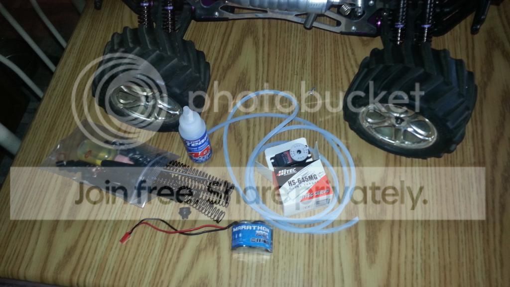

Today's project kids. Adding fuel line, installing the new Hitec Servo, installing the hump cell, and get the shocks built. Picture taken last night, I do have 4 of them done.
I seem to have misplaced a bag somewhere that had the bulb primer and Novarossi fuel filter. I got stuff in about 4 places so I am bound to stumble on it eventually.

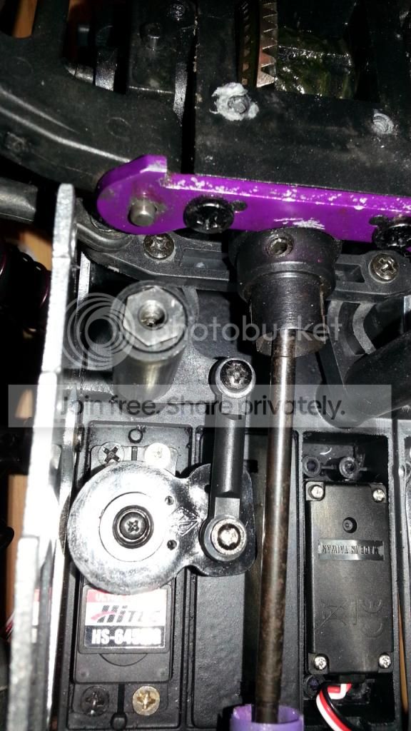

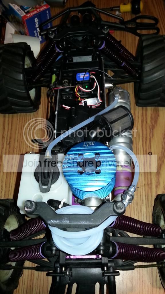

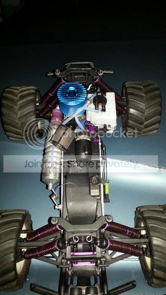

Did make some progress tonight thanks to @Jam Racing 1. Came through for me on the steering issue. So tonight I got the new Hitec 645MG w/ Kim124 servo saver installed, Shortened the tubing from the tank cap to the pipe, lengthened the tubing from the tank to the carb (wrapped around the shock tower for a minute while waiting for a new roll bar to zip tie it to), small Dubro fuel filter installed til I can find the Novarossi, installed the failsafe and tidied up the radio box.

You are WELCOME to all the advice i have, it is free here :) I do think ya got a bit carried away with the fuel line though, only need a small loop in it, but whatever workx for ya there :lmao: one piece of advice I have for ya is to turn around those screws for the rear shocks, else they will surely puncture your fuel tank at the wrong moment in time whilst bashing :)
I do think ya got a bit carried away with the fuel line though, only need a small loop in it, but whatever workx for ya there one piece of advice I have for ya is to turn around those screws for the rear shocks, else they will surely puncture your fuel tank at the wrong moment in time whilst bashing :)
Saw a post somewhere, maybe it was on HPISF, where a guy said a dude they knew was using a whole package of fuel tubing. What I used only looks like a lot because of how its wrapped around the shock tower. It's 16". Duly noted about the shock screws on the rear. I will flip em around when I install the new shocks.
