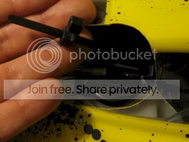

Now, take the first zip tie and attach it to the edge bar of the fuel tank lid, BUT do it so that the zipper edge faces down when folded across the top of the tank.
That means you shove the tail of the zip down through the with the zip UP when when you bend it across the tank to connect it, the zip will be facing DOWN.

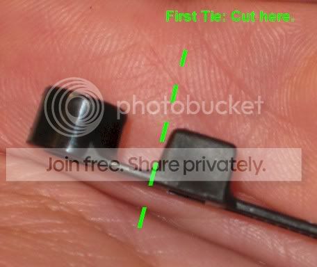

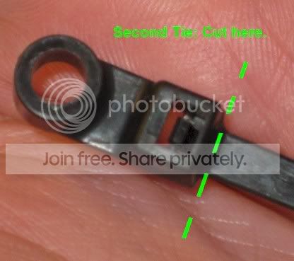

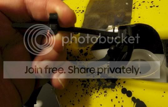

Once that's on, NOT TOO TIGHT since it spins on the end of the fuel lid, take the second zip tie and slowly feed it onto the end of the tie you just attached.
With both pieces on, it should look like this:
With the body on, I checked it out for function and then I trimmed the end down some after I slowly moved the second zip tie head to an appropriate position.
I used nail clippers to trim the zip tie, but I left some of the tie on the end of the finished pull, so that when I am just driving around, I can tuck that inside the body and not have the tie flying all over the place like a rodeo cowboy. Then I looked closer at the picture and trimmed my own nails.
This is what it looks like when tucked in.

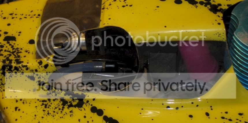

yeah.. this is the correct way of doing it. Check the fuel tank pic...

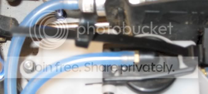

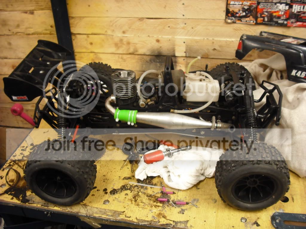

I love the handles, they make fueling alot easier. Although on mine I used an old pullstart handle on the end.
kinda hard to see in the pic but you get the idea. Oh btw in I used a piece of fuel tube between the handle and the lid.
Thanks Tarn!
i think its time for a little bath! LOL
Just alittle :) LoL
That was last year, I was lucky enough to meet some of the members in Houston. Even Hop! Nick (sunkenmetal) found a great place to hang out for the day. In the end I didn't break anything though so I thought I'd get alittle dirty :)
She's clean now. Due to the complete tear down I ended up doing a budget mid-tank after that.
