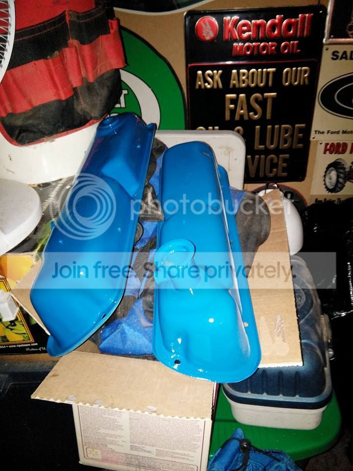

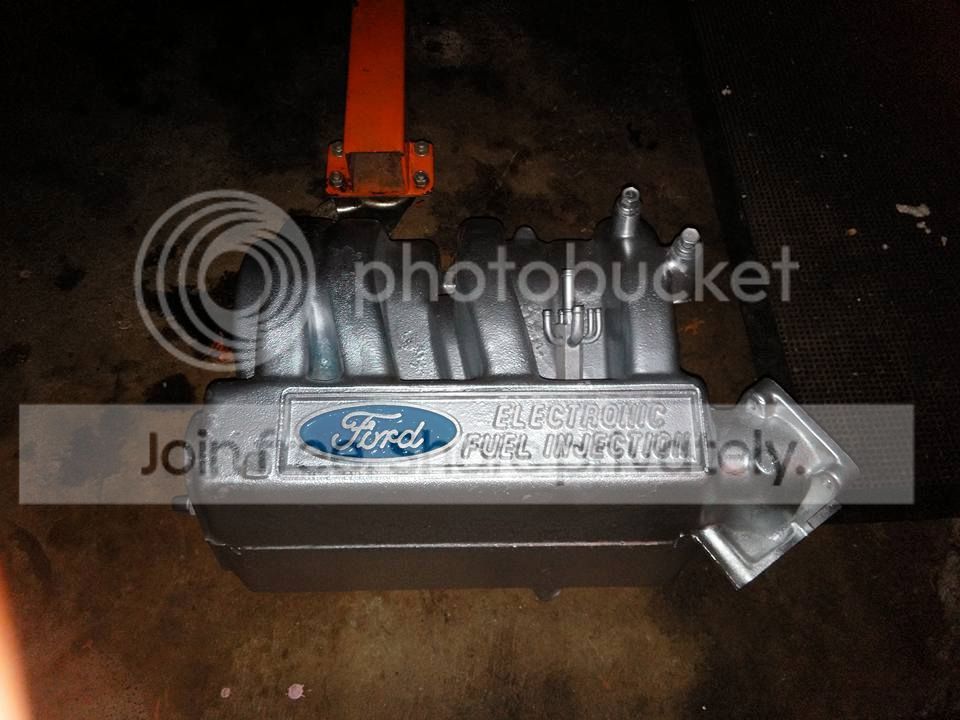

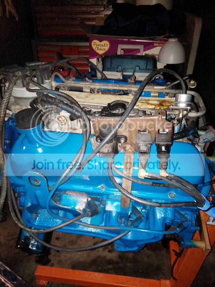

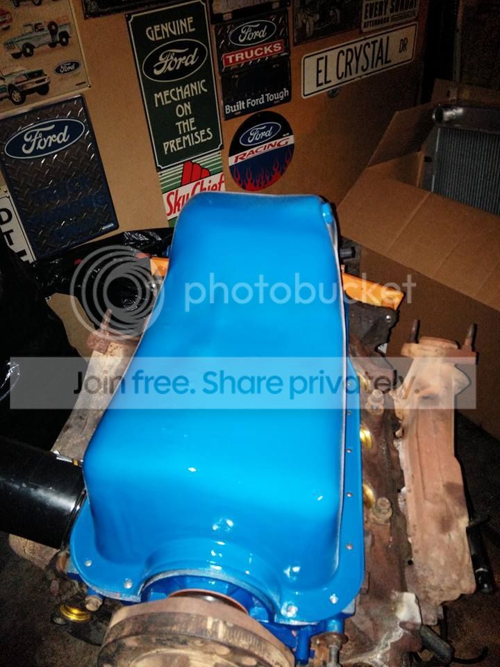

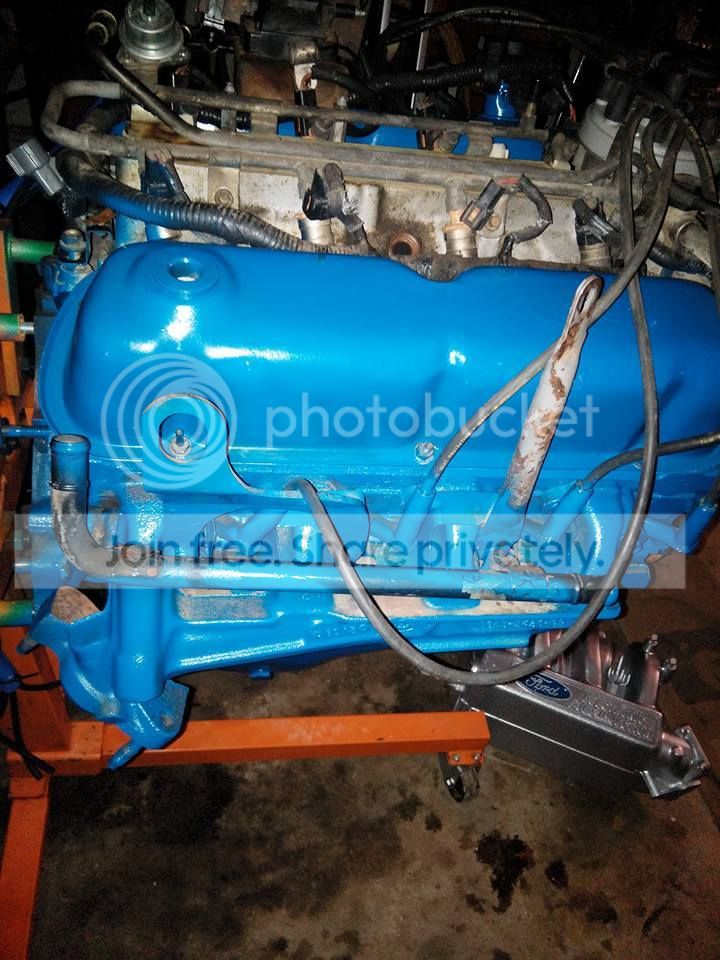

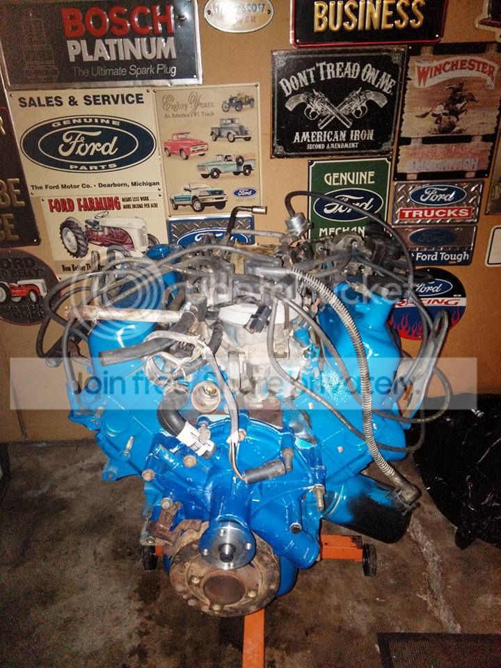

Ok this mess started with a couple of water leaks and has progressed thru pulling the 302 engine out of the chassis and doing alot of work on it, on Christmas last year my kids truck an 88 F 150 blew the water pump and as I got into repairs I found all the engine freeze plugs were rusted thru and leaking, so instead of fighting the stupid things in the chassis we pulled the engine and decided to do some work on it, well the timing cover had broken bolts and the chain and gear set were sloppy so we did that, new timing cover had to be gotten due to broken off bolts that someone had tried to do a hack repair on...I installed all the freeze plugs timing chain and gears and we pulled the upper intake to do the valve cover gaskets too, found the motor mount rubber is bad so he is getting those, while it was in the driveway we power washed down the engine and the engine bay so he could paint it up pretty I also stuck the wand in the coolant passages and got rid of all the goopy rusty mess in those...
we have been taking our time because my son has little money to do all at once, but now we are coming together and hope to install the engine back in the truck this sunday and then work on all the periphals and hooking up all the crap that has to go on one of these efi engines...

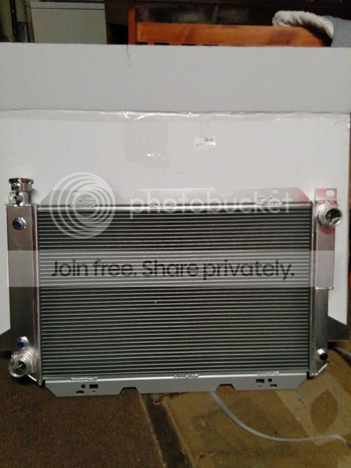

He did get a new radiator for it a nice aluminum radiator than the plastic tanked crap that was in there before....
Here are a few pics of what we have so far, I can say is a sight better than what was in there before 😀
so thats where we are at right now I will have more once we put it in the chassis and get it running again......
