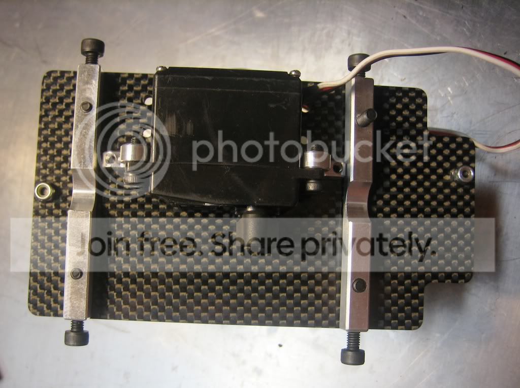

My prc125 is made to accept the OFNA 250cc tank. It is not a direct bolt up to the Xl chassis but would fit with no issues. The only thing you may have to do is either drill a hole in the chassis on either side toward the rear or what has to be done to the X/25 TVP's is use a flat washer and use it as a clamp, clamping the TVP's between the PRC125 plate and the washer. This has worked great for many who have done it. Your throttle servo will bolt directly to the bottom of the plate via FLM Servo Mounts Here is a shot of this.
Now to mount the throttle servo you will have to come up with some sort of mount for this as I am unsure of what will fit. There are many who have done this so I am sure you can find pictures somewhere to mount the servo to the TVP in the stock tank location. Otherwise you may be able to drill the TVP so the FLM Servo mount will work.
