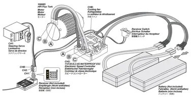

I'm not finding the manual for the blur at the moment, so here's a picture of the waterproof ESC.
upload_2016-3-18_8-53-58.png\
As you can see, they use all three channels. CH1 is steering servo. CH2 is likely throttle. CHB is battery power to the receiver from the ESC.
