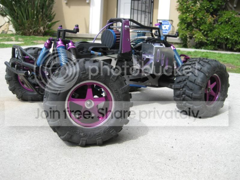

pretty sure stock clutch shoes savage 21 i think is what this truck started as..49 tooth.. not sure whats on the motor hpi threaded shock with shock mod .. blue and black springs.. thanks for the help oh yeah stock hpi tires

remember shock mods help lower the truck so that may refrain it from lifting so easy. Id check those shoes / springs.
Jack the suspension up high, put in the spacers to compress the springs so they are hard and it should wheelie. Aluminum shoes will also help.
I would go to alum shoes that would help and yes lowering it will cut down on the wheelies. If you want good hadling though that is not a bad thing.
yeah the shock mod made my truck a whole new beast.....don't know if i want to give that up.......on a side note will the new save x skid plates fit on my car
