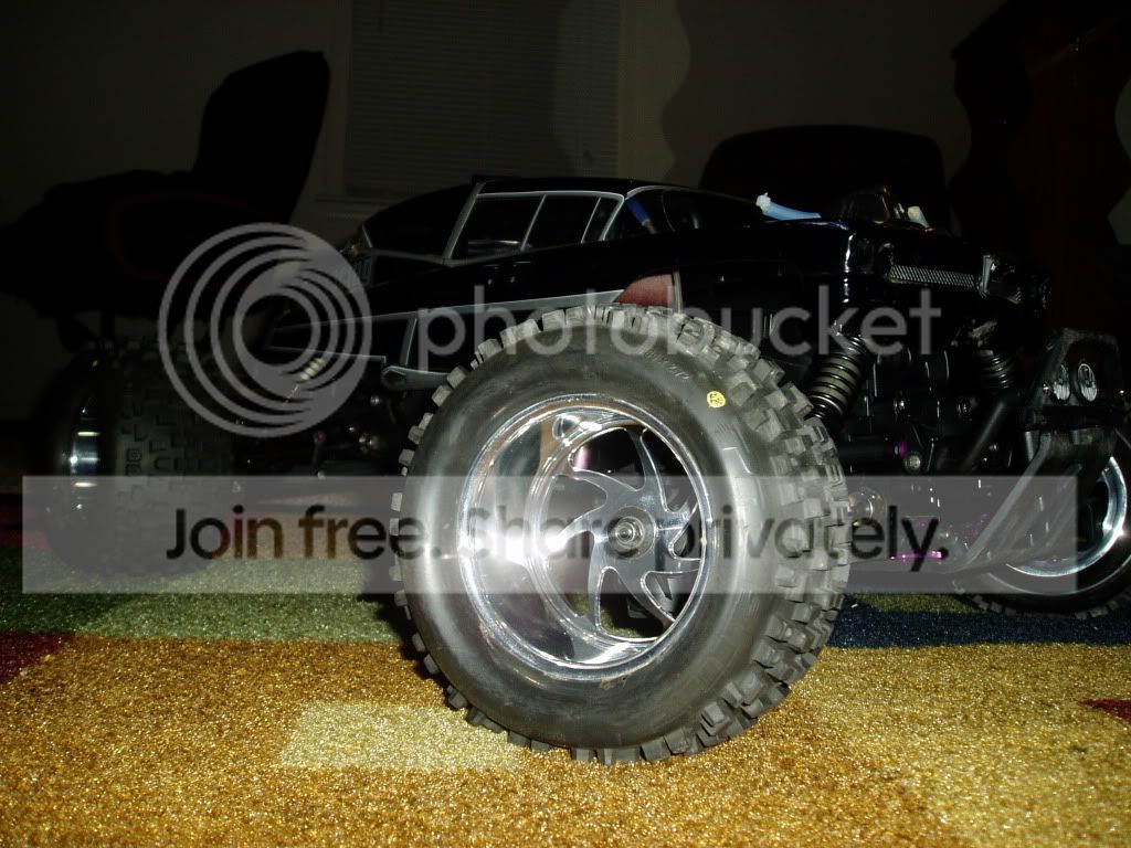

ps. i will post up a pic if you would like to see the stance that my truck has
sure, if you got a pic on hand and could upload it. Know i can take of the plastic clips to lower it a little. Still waiting for a new OWB for my tranny so i can drive my car again. How much oil do i need for 4 big bores? 35wt silicone oil should be good?
yepp :) and i used team associated 35 wt silicon oil and had some left over after all 4 shocks were filled. just remember to lube all the o rings before you fill them so your shocks wont leak. if you have any more questions just feel free to ask
Derek
sweet car:) how big are the bottles with oil? i see 2oz 35wt from TA on ebay for like 7.33$ included shipping to norway. is that enough for the 4big bores? haven't changed/put oil in shocks yet since I'm very new to the hobby.
2 OZ and my mistake i have factory team silicon oil. And when you fill up the shocks twist the shock shaft once you have the fluid in there to insure that all the little air bubbles are out. let the shocks sit upright for a while and remove the caps and see if you need to add fluid.
Those are knock offs, but if i recall correctly someone here on the forum purchased them and said that their quality was pretty good, might want to try and search the forum to see his review of them. I run 2 sets of the Flux big bores on 2 of my trucks and have had no issues with them, this is one of my trucks, it has a 1/4 inch piece of tubing in each to lower the stance and i run 45wt in them..
