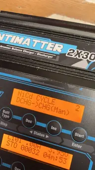

maybe your battery is no good anymore or not fully charged and you should put it on a good charger and cycle it 10 times to refresh the battery. over time if all u do is charge the NiMH and nicad batterys they don't actually fully charge and they need a good deep cycle to get them back to peak charge.
this old hpi 12000 battery that I'm using after sitting for 3 years only would charge 200mah and wouldnt last so i cycled it 10 times and now it charges back up to around 1100mah almost its original peak. you can do that same thing with the dubro nicad glow igniters when they don't work so well anymore, as they develop a memory. i do this with all my batterys and igniters for my planes as those must have a proper charge so i don't lose a plane lol
