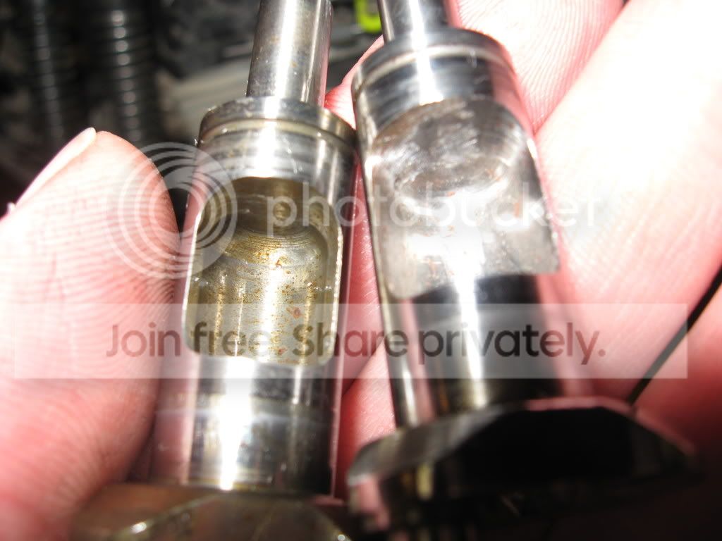

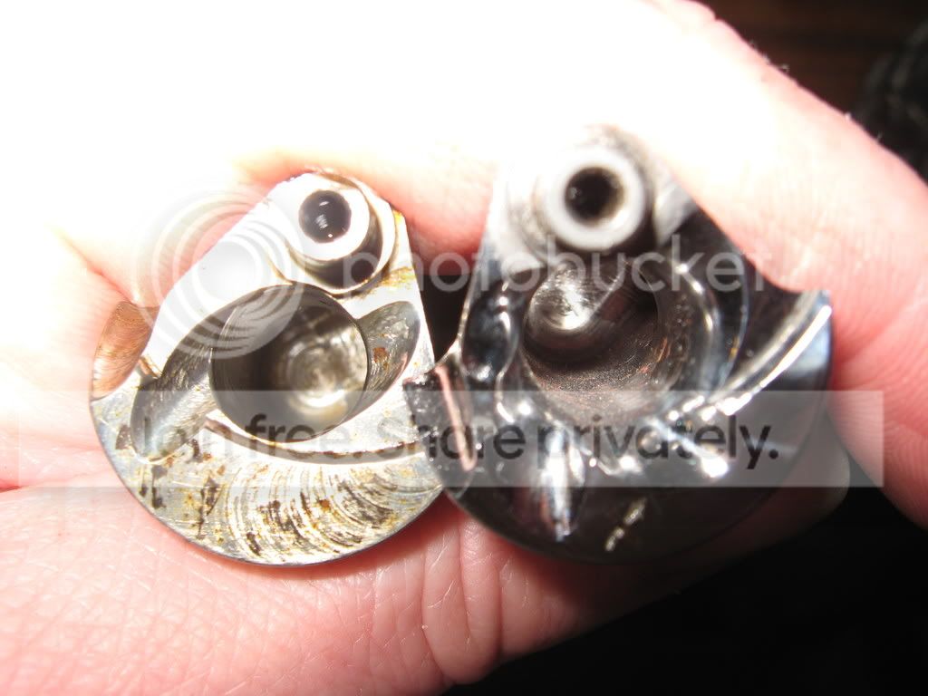

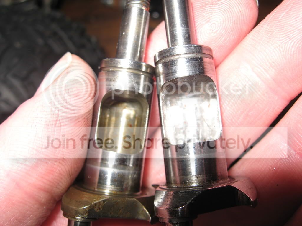

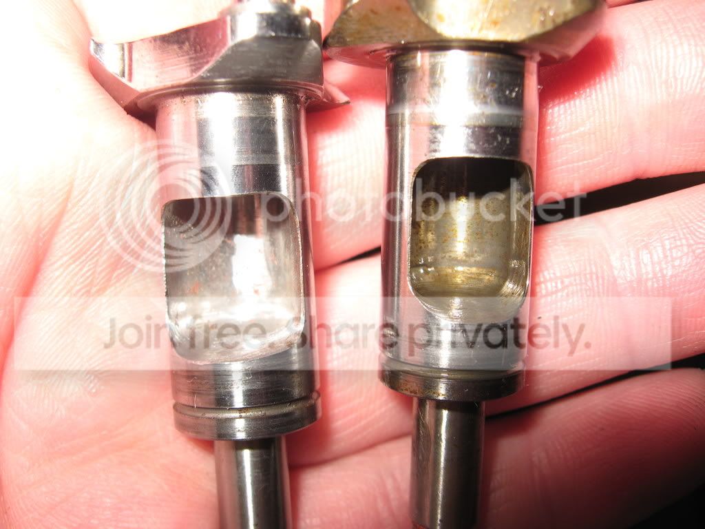

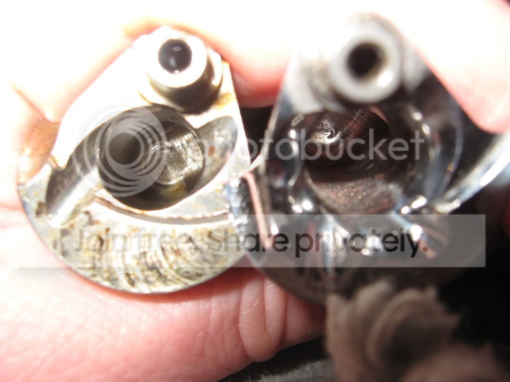

So I have a crank that purenitro sent me; Modded like crazy..
And a crank that crash did some modding to .. Iam putting a new piston/sleeve and c-rod in my surefire .32r
Just wonder what you guys think I should use. The sleeve is very mildly ported from the factory. And purenitro crank is advanced to the nuts. I'm hoping that it wont cause issues if I run it ? What to you guys and gals think I should run ?

Id try both to be honest. Just to see the difference. And of course use the one that runs best. Don't be surprised if Crashes tunes easier than robins do to the stock sleeve. But who knows.. get wrenching
SJ I would go with Pure's crank all the way bud
Back when I did that crank pictured, I had not been tutored by Pure
after many phone calls and pm's Robin showed me how to get evan more power out of these mills then when I did yours back then.
Have fun with that monster
is that some rust on crank of crush moded??
let us know the feed back if u r going to try both cranks
It is rust .. sufrace rust tho .. been sitting in a cold grarage for a few months .. I will give feedback when I run it
you can take that rust of with 00 grade steel wool. it shouldnt affect the tolerances on the crank. we use that on chromed shafts and surfaces at work, because it messes up the allowable clearance between the shaft the the bearings. have fun!!!
where's Pure?
He would know the most about his crank.
I know the one I did only had a slight timing change, I had yet really learned what a timing wheel was at the time....lol :slapped:me
