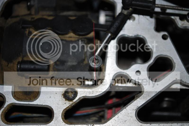

Also in the vid that brake arm is straight. do you know what i am referring to ?
Here this arm: (red line is where it would be stock)
