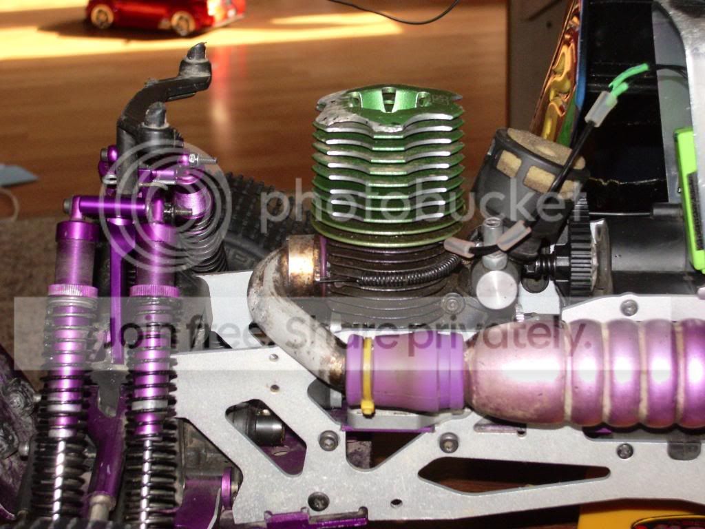

Ok for all the savy racers out there I need som help. I am new to the world of rc and i have built 2 savages and i want 1 racer and 1 basher. here is the truck as it sits
it has the following
Picco 27 motor, extended tpv, intgy shock towers, savageX diffs, 3 speed tranny.
Now looking for things i can do to lower it and make it handle better and stuff. can you include links to any info provided. \
P.S i might put my spare werks calario 30 in not sure yet.
Thanks in advance

What uppers are good to use. And i have a 1200 hpi pack as well. are there any links to buy the mid tank mods. The towers have 3 points. and the lower arms have 3 points. was wondering where to put them for a lower stance.

thanks for the mid tank links. I was thinking of trying to build my own but we'll see. as for the lowers they are integy. not much plastic left on the old girl. now my basher is stock 25 except for the werks 30 motor

Nice truck. thats how i want mine to sit low
