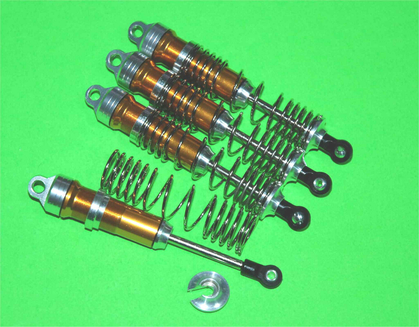

I had crazy expensive Integy shocks on my Savage 25 back in the day, and I figured. NO. Not again. So I went the cheaper option. Hopefully they will do better than the stock ones.
4 shocks
Although they aren't fully metal, they do look to have a good design, I like the dust cover for the shaft. And the price...
Wonder if they come pre filled with oil?
I'm contemplating going fully aluminum again, like I did with my Savage25. but I'm somewhat torn...

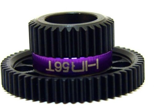

I already put it back together, the new idler gear is not sintered/pressed metal, but cnc milled steel, much harder, so if anything another gear will fail before this new one does.

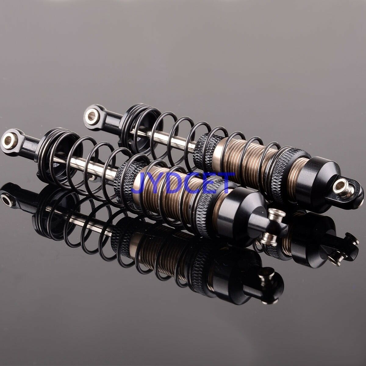

So, I changed my mind, I didn't actually go through with the order of those shocks... I got a different set in stead:
2 x shocks for HPI savage XS
May be the worse than the others, but I like the look of these better... lol Price is about the same though.
I also ordered some 35wt silicone oil for them, in case they don't come pre-filled,..

I replaced the new idler gear, cleaned off the old one, and took a couple of pictures...
@shutah
You can see the top small part of the gear has damage to the bottom part of the teeth. Yes, it's still usable, but I don't wanna chance it, so the new hardened gear should work great.

The first set of shocks I ordered came today, as I knew, they didn't fit.. lol
On the bright side, they did indeed come pre-filled with oil, and seem to be of high quality.

Finally, I got the new shocks.
They are superb, really love how they feel...
