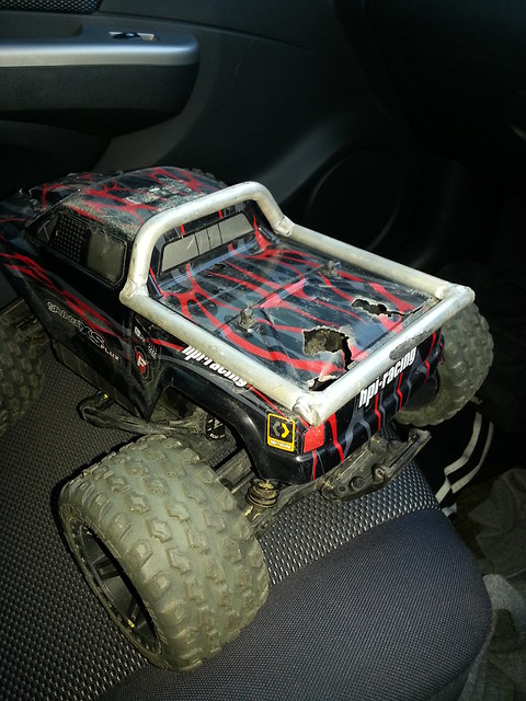

I've begun to make an external roll cage, using my old body as a template. It's not mega flash but it should help keep my new body looking good.

I drive this as a basher, and I beat up on it a bit! It takes heaps of beatings, such as;
Landing square on its roof from 15ft
Landing on concrete, on one tire, from 10ft, after exiting a skate park bowl.
Driving flat out, hitting a small jump and slamming into the next jump roof first
Not one of those times did any part of the chassis let me down. The chassis design is excellent on this thing.

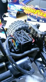

And finally the biggest issue. I cooked my esc. But I was running the truck at high speeds for long periods that day. My advice is: if u think your truck isn't performing as usual, or doesn't have as much power as usual. STOP DRIVING IT. I didn't do this and kept running it. Bad mistake on my part.

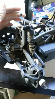

First of all. If your running your truck at a skate park or even in the street nodoubt there will be some poles or posts around. A vulnerable spot on the truck is the front shocks. This is easy fixed by moving the shocks to mount on the back of the arm. It's a tight fit but everything does clear and it bolts straight in. U will need to protect the ends of the top shock bolts with whatever means u have on hand. These bolts mar wear thru your body if it's sliding along The street

To avoid motor wires getting cut up from the body mount pins. U can either simply turn the body pins around. Or you can take the cross brace off the top of the esc mount, unstick the esc and turn it around. I have a feeling this is how it was designed to be but hpi changed their mind.
