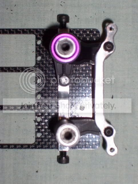

ok so I started working on my savvy a lil bit last night... I didn't get to take a whole bunch of pics my digital camera took a crap on me... so I'll be taking more tonight. I did run into a bit of a snag.

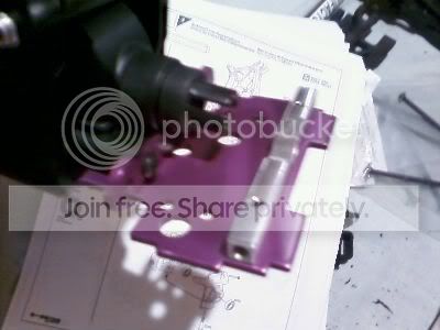

When installing the aluminum cross bars that came with the FLM tvp's onto the hpi bracket it seems the screw holes on the flm are a bit small so the screws I use for it have some play in them. Unless I'm totally mounting them wrong!
in this pic I have the screws in the bar but there is a lot of play
any insight on this would be gratefully appreciated. Its been awhile since I've built an RC car, and this will be my first savage.
sorry for the bad pics... from my camera phone

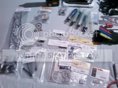

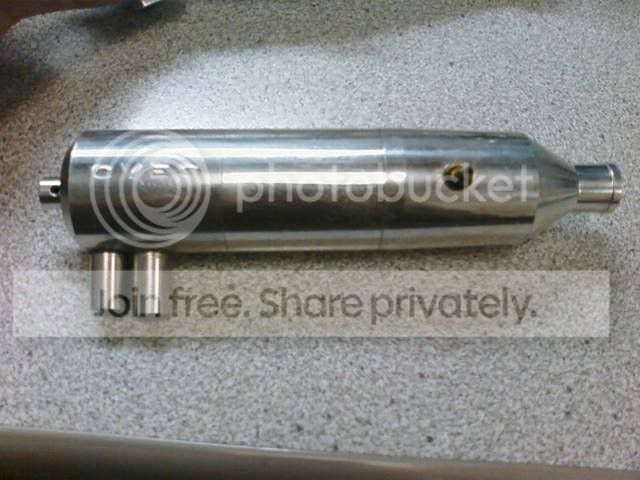

Today to my surprise one of our Techs brings in all his T-maxx and misc bits to sell because he is loving his 1/18th rc18t. So I snagged these off him
and
The CVEC is for a .21 engine but I snagged it regardless.

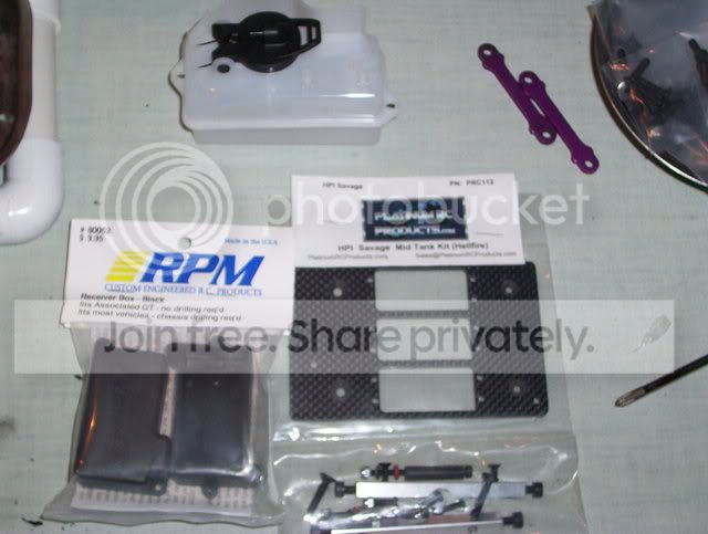

ok so I recieved some goodies when I got home today to help finish the build... Got the midtank kit from PRC Thanks to Larson. The quality of his CF bits are top notch indeed. Kit included all the necessary hardware to do the job. Also got the Hellfire tank and access. and RPMbatt box.

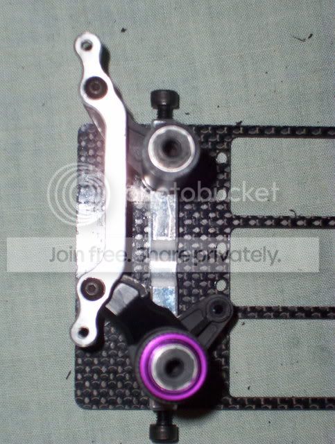

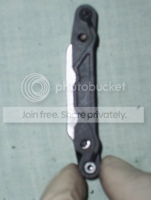

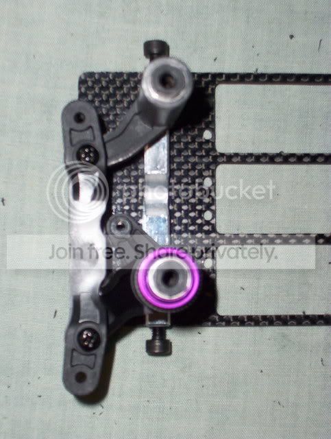

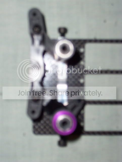

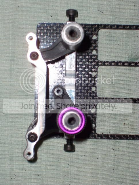

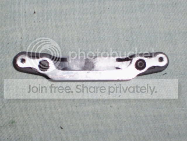

during the assembly of the steering assembly don't know if those using the FLM drag link have come across this. But the link binds against the saver arm when at left turn full lock.. as compared to the right lock the link moves quite a bit further.
stock piece
the factory drag link has recesses in it to accomodate this problem as the flm link does not? I was thinking about shaving a lil on the bellcrank but didn't want to take away any strength of it.
stock link overlayed over the flm
flm overlayed the stock link
Looks like you have a great build going on and good luck getting it back together. The one thing I noticed is in the first pic where you have the aluminum cross bar on the bracket. Unless you upgraded it, there should be a plastic brace on the bracket, and the FLM brace you have gets mounted on the engine plate, which is why the screws are smaller. Sorry I cant help you on the FLM drag link, I do not have one of those. Hope this helps you out and good luck. Keep us updated as you get further along.
Allan beat me. That brace goes under the engine plate. Nice work Q.
thanks for the input Allan. I figured I either got the wrong braces with the FLM tvp's I just used the plastic stock braces for the time being...
I may just use the stock drag link instead of the flm piece for now... hmm looks like I'm spending money and not using these parts LOL blah!
Glad to help out. from what I hear those FLM drag links are good and I am sure someone will post up a fix to help you out.
Turbo, don't shave anything & use the FLM link, it mounts like this VVV
gotta save up & get me some of that carbon fiber for my savage
thanks frddyj... I have mine setup the same as yours just the view I took the pic is from the bottom of the rack assembly and not the top view... I'm gonna mess with it some more this weekend. Thanks for the input.
