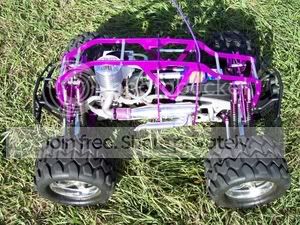

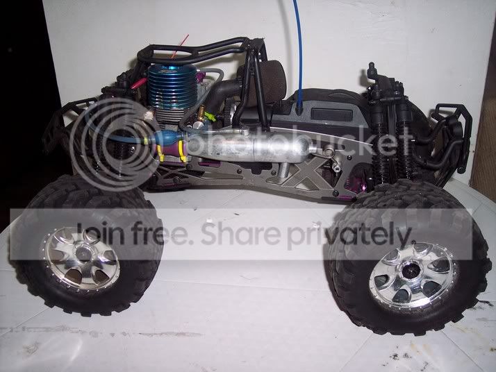

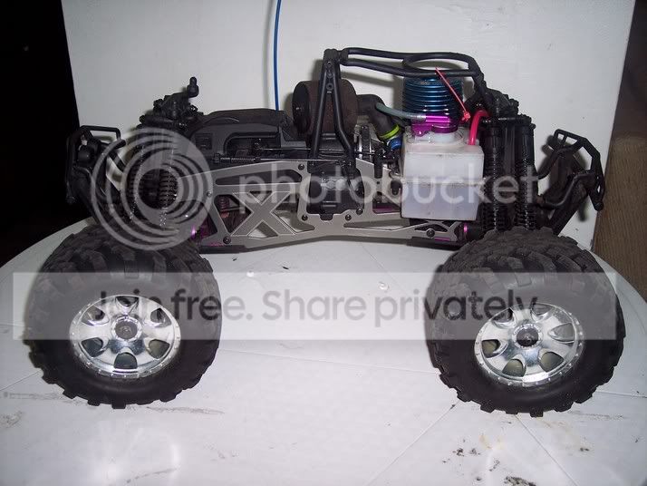

This is a factory savage X except for the motor and pipe. Here is a pic of it before it was converted to be my basher Twisted Toys 1/2 inch extended low center of gravity TVP's plus a few more things.
Well it got TT tvp's, skid plate, and upgraded 15K diff fluid, shimmed the diffs, 35wt shock oil, Hitec 645 for front and Hitec 311 for throttle and brake, 3 speed tranny, fail safe, savage .25 upper arms, GS25R motor, hpi tuned pipe.

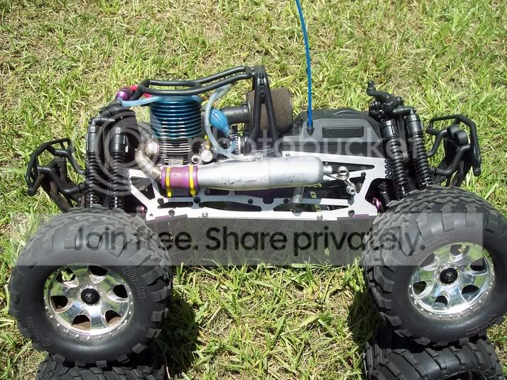

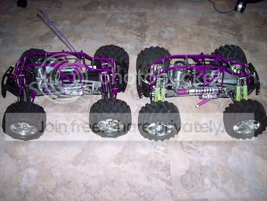

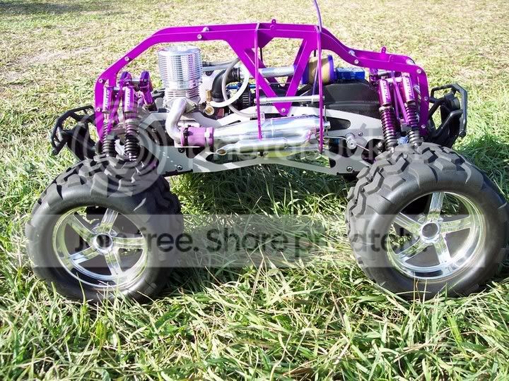

Here is a few pics with my 1inch ext lcg TT TVP's plus more with the X
So let me know what you guys think. Any thing else i should do?

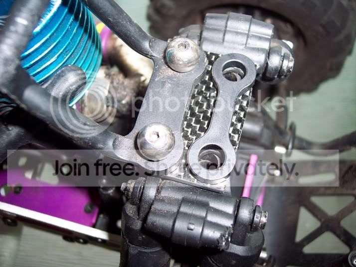

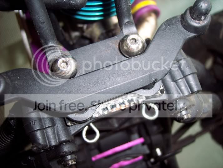

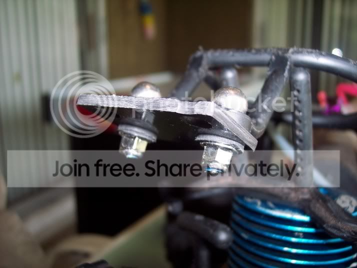

Extender made of carbon fiber for the head protector.
Well i used ball ends from a t maxx knuckle. LOL It ball ends go in the holes for the head protector great. about a perfict fit when tight. Then used rubber washers and a wheel nut off a revo for the bolt. I did it this way so there is some flex in the ball end and the rubber washer.
Then i used the shim to make up the little gap it had.

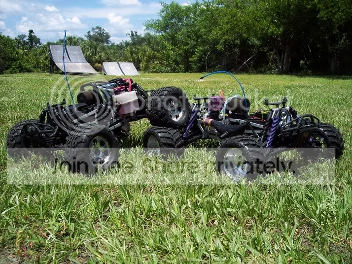

Well here is a pic of it all together.
Now its time for the 1" TT truck!!
Let me know what you think.

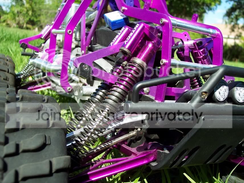

Woow, sweet trucks, both of them. I don't know what I would do next. I would probably get everything color parts so it stands out, I love that.
Thanks guys for the kind words!!!!
I'm more into go then show. If it dosent make it faster or stronger i don't want to know.....LOL
Before i knew what was what with the savage i had these trucks. I found out aluminum isnt the best answer for my driving style. LOL
