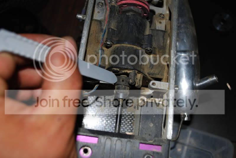

The dog bone is fine. Sorry for asking this newbie question, where is the "grub screw" located? will I see it by flipping the truck over? Is it suppose to hold the rear drive shaft cup?
In that hole the scalpel points to is a screw. that is a grub screw and on every cup there is one. don't forget there is one under the brake disks too
WOW I'm missing a steering post screw thanks for making me take the pic! its a freebie now..
