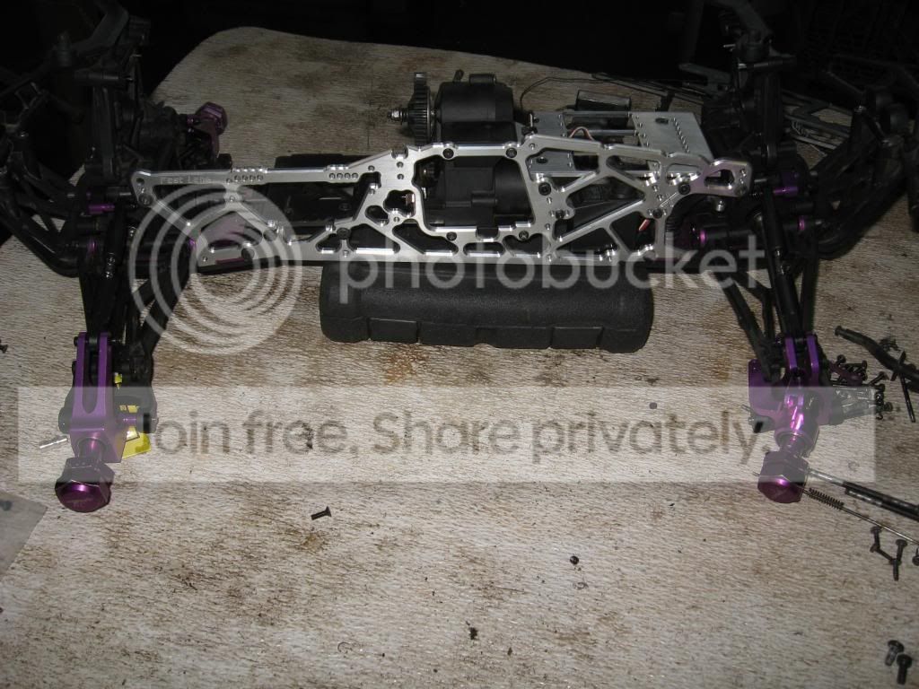

Here is what I am starting with.

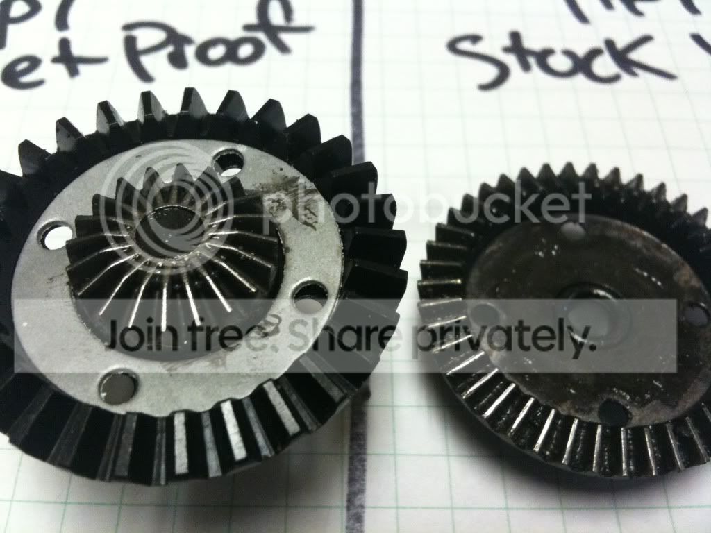

I already had the bp diffs but am waiting for the rest of the stuff to come in the mail.
Those bulletproof diffs are seriously beefy looking.
:rock:
Those bulletproof diffs are seriously beefy looking. :rock:
Yes they are, I'm getting mine tomorrow for my XL. I'm hoping those bigger bearings last a little better on the ring gear side. I've never even come close to stripping teeth on the stock XL diffs but they start slipping when those bearings go. Your filter looks a little dirty in that one pic LOL.

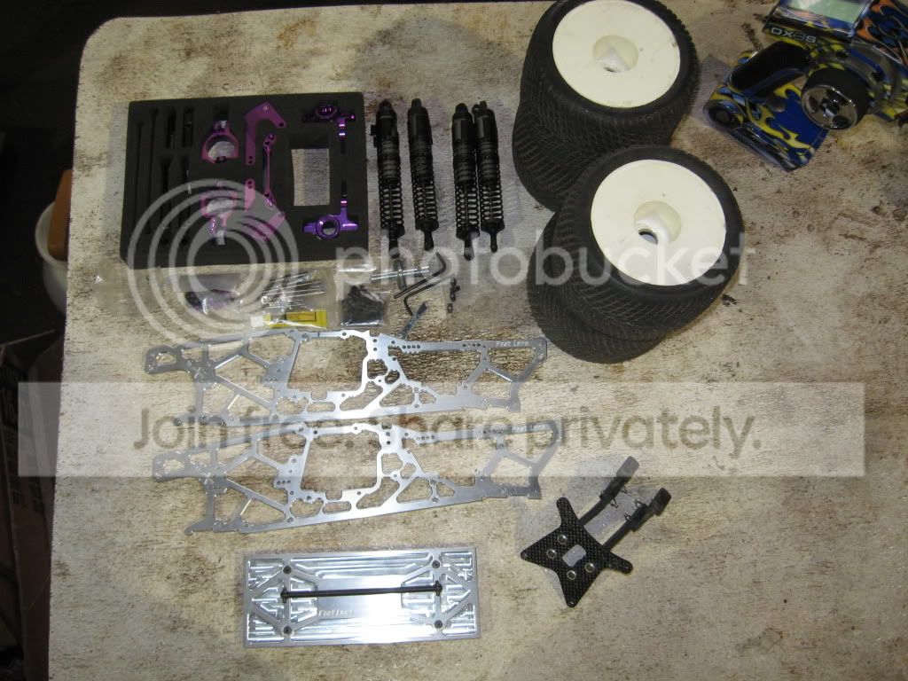

Got some parts in today!!
Well the mail santa came through today with a couple packages of parts for the savy build. This should get me going. Hey there is no instructions for the rsc. Can I assume the stuff pretty much goes where it looks like it goes? LOL I mean is there any tricks in the instructions I need to know? I am still held up by a mid tank setup. I contacted Prc and he is out of stock for now. I can do the rsc and shocks but don't really want to do the tvp's without the mid tank setup. That way I can locktight mt way as I go. Maybe I will look into a different mid tank plate or possibly make one myself. Any thoughts?? Thanks, Tom

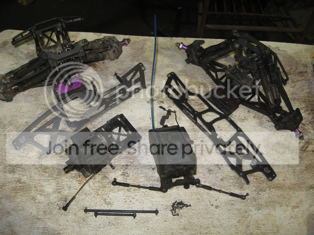

Still waiting for a few things so its been on hold. I think I will have most everything tomorrow to get going. Messed with it for a few minutes tonight after getting all my stuff out on a work table. Got it tore down now. She needs a good cleaning before reassembly. I should get some decent progress on it this coming week.

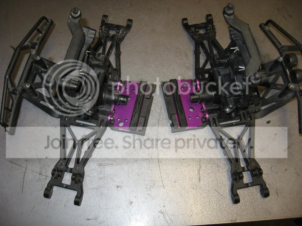

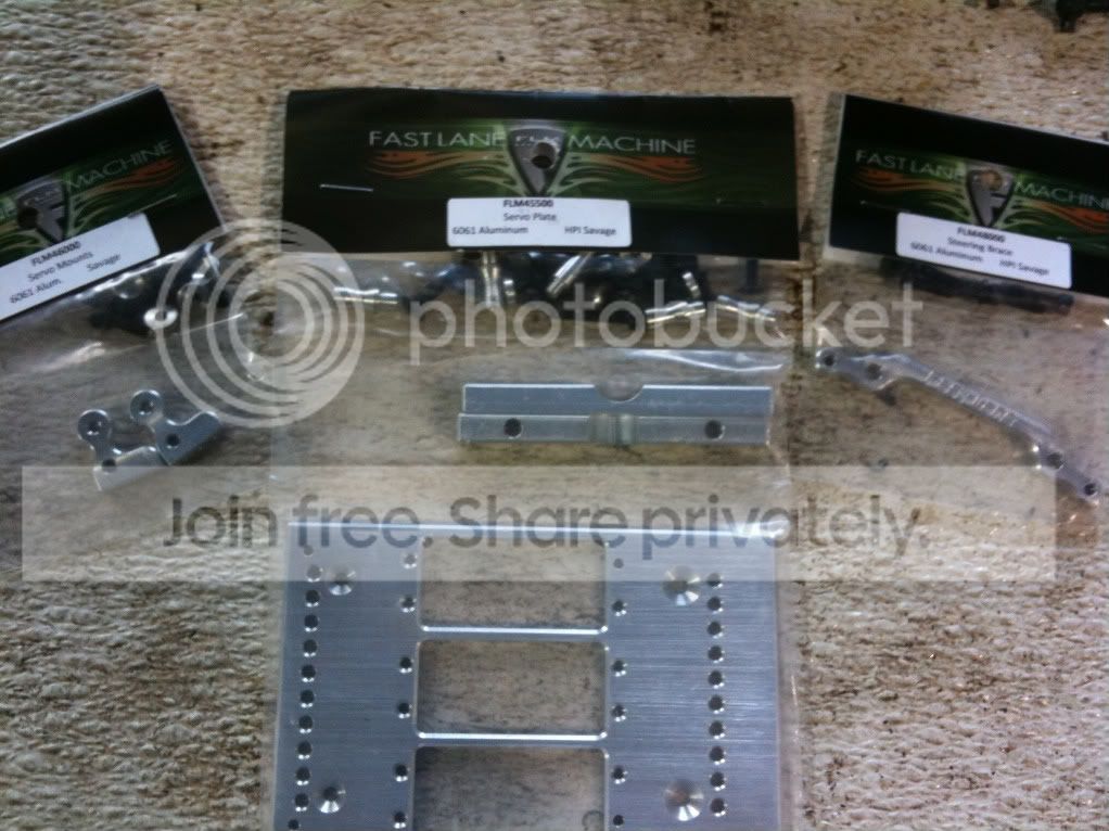

Ok guys You asked for pics here is a start. I got a few hrs in the build yesterday. Had to do a cleaning to start with then I worked on the rsc install. Got the rest of my flm stuff in the mail this week from rc monster.

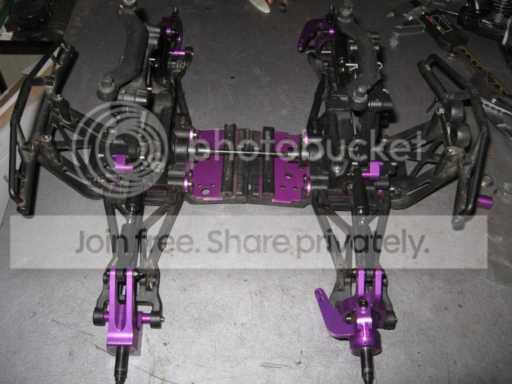

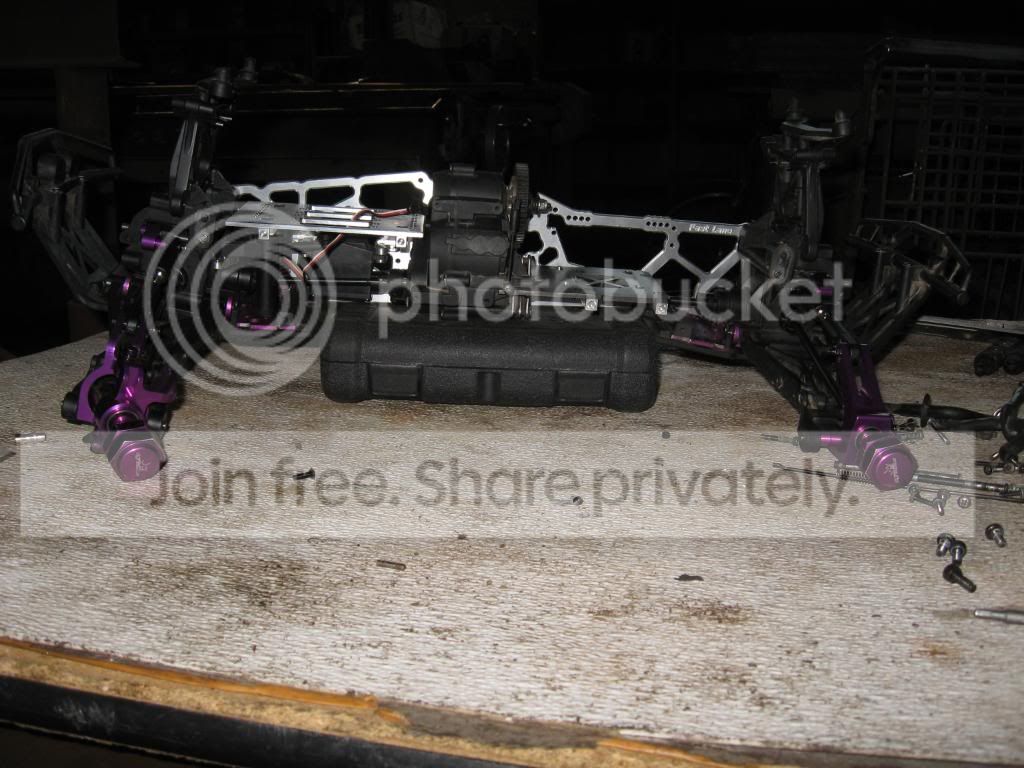

I started with the stripped separated front and rearend.

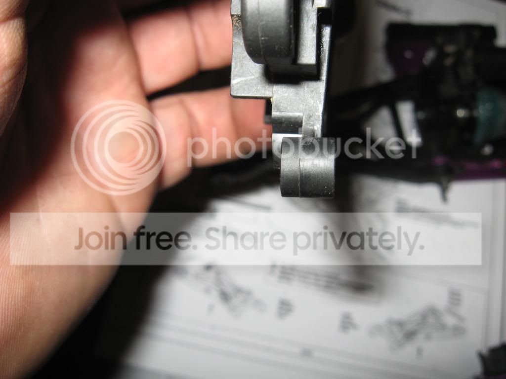

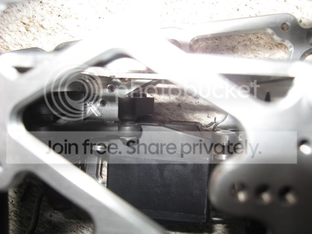

I then had to trim a few places on the bulkhead for clearance.

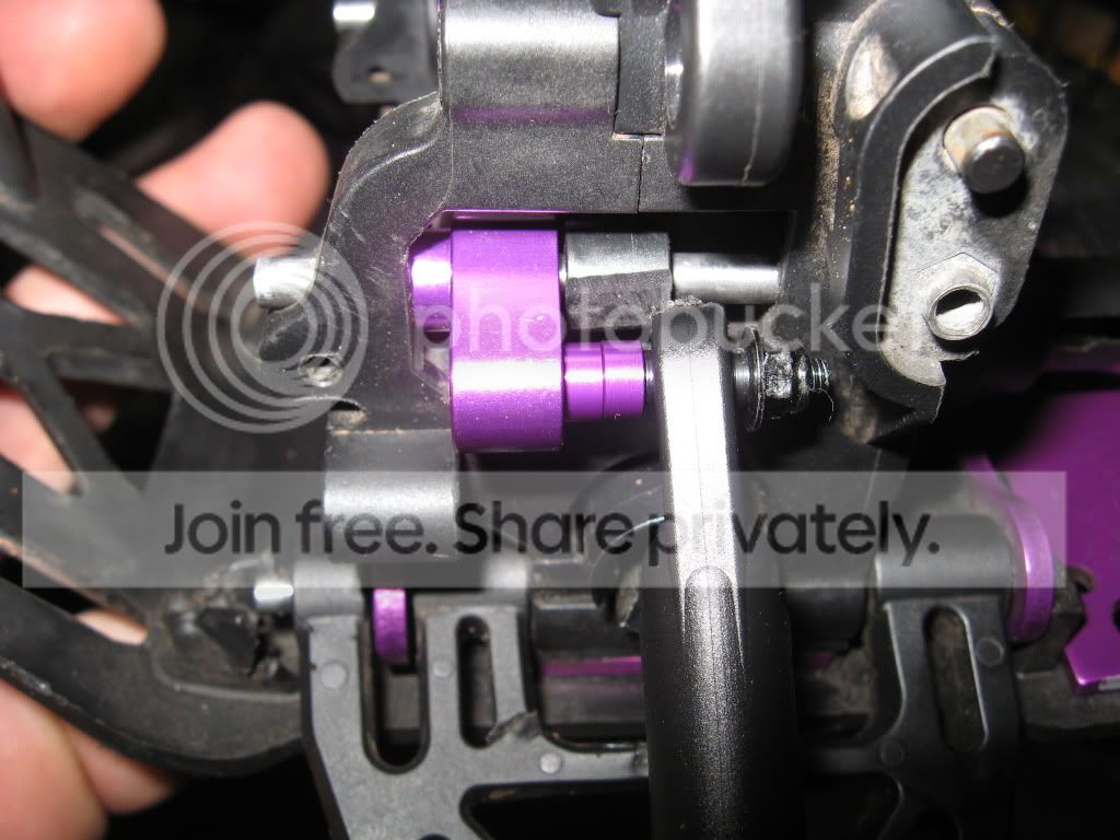

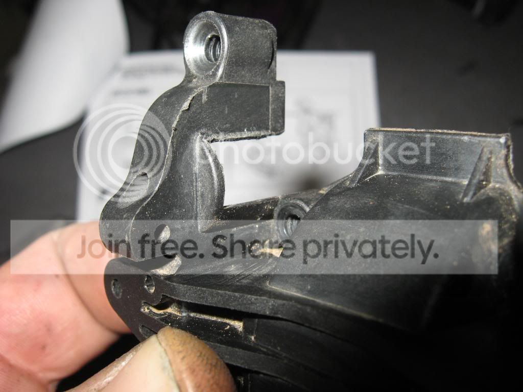

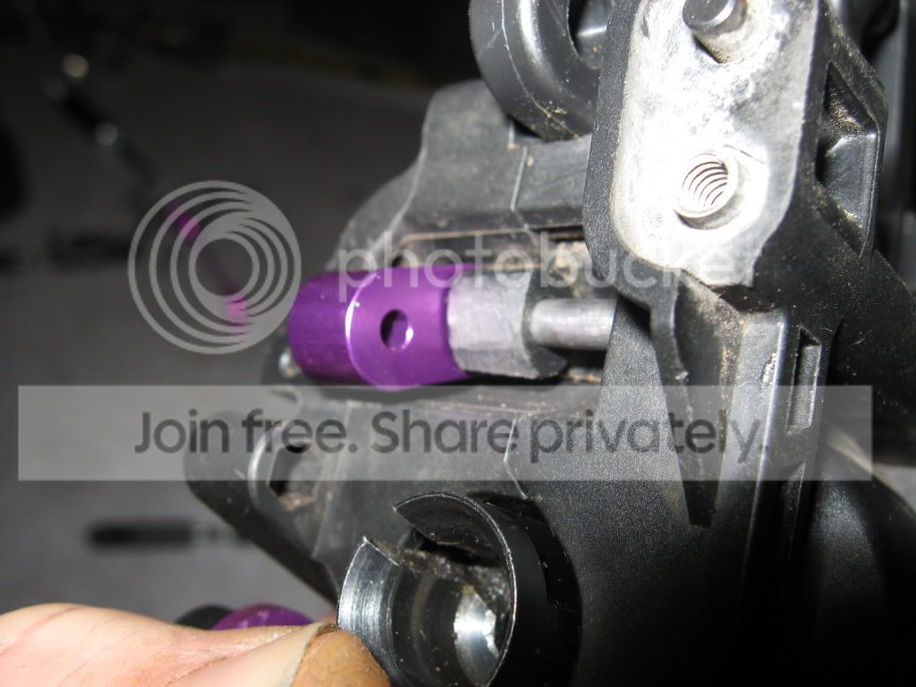

This tab on the shock tower needs to be slightly trimmed as well. I will show before and after. I learned on the front that I didn't need to take as much as I did.
And the assembled parts as described above.

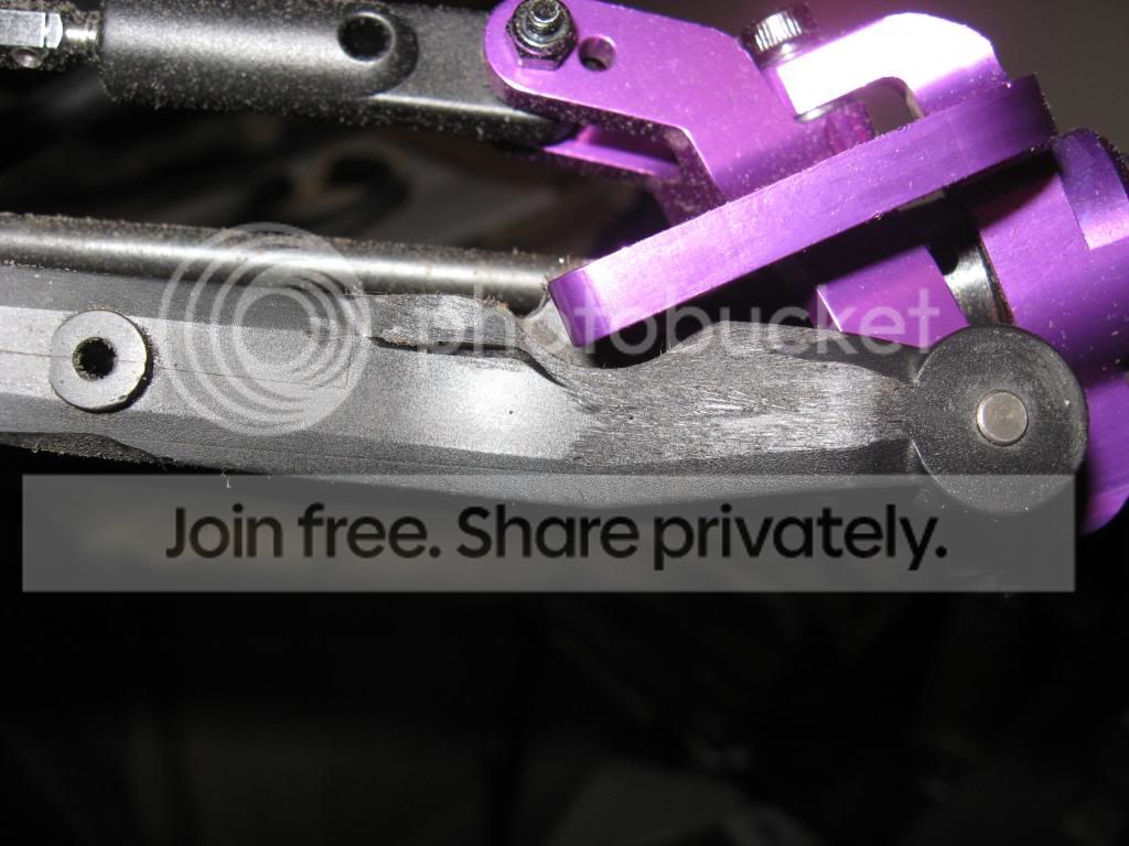

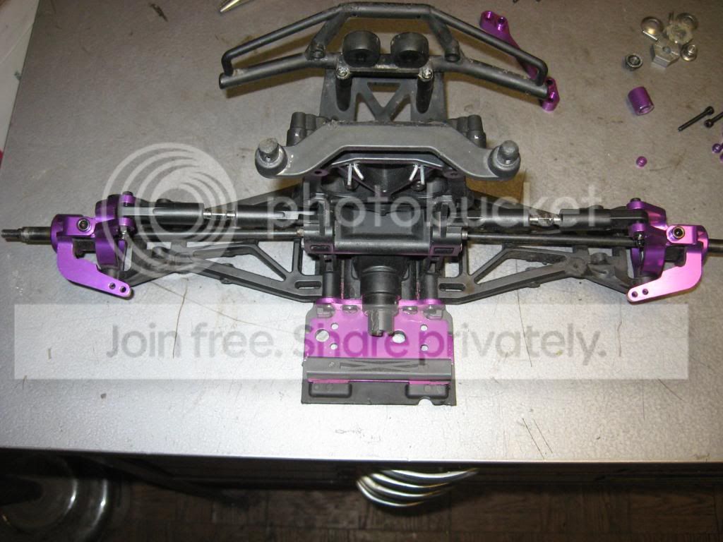

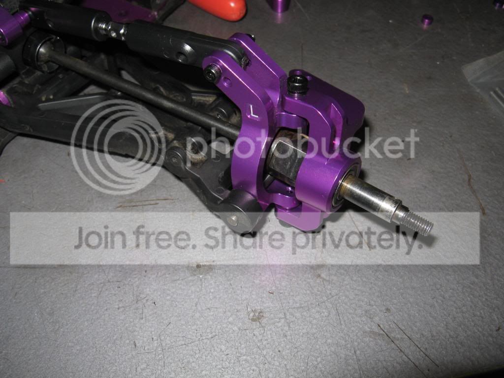

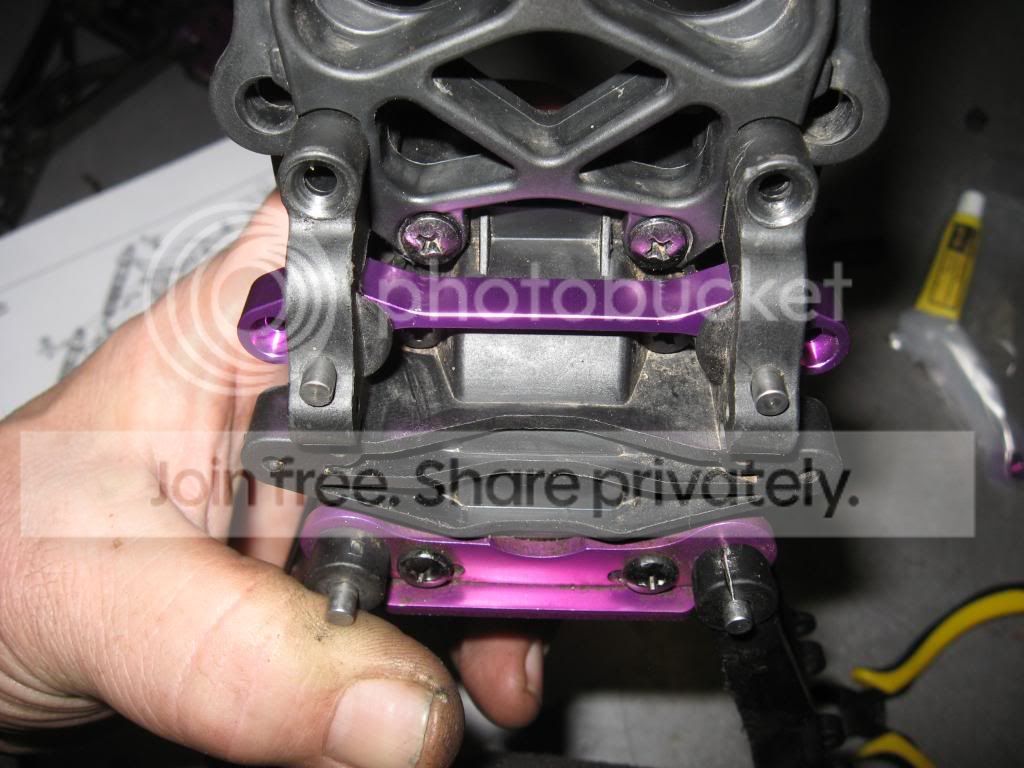

Now to complete the front a-arm needs some trimming to clear the steering arm.
Once this is done the hubs can be assembled and installed per rsc instructions.
Complete front end

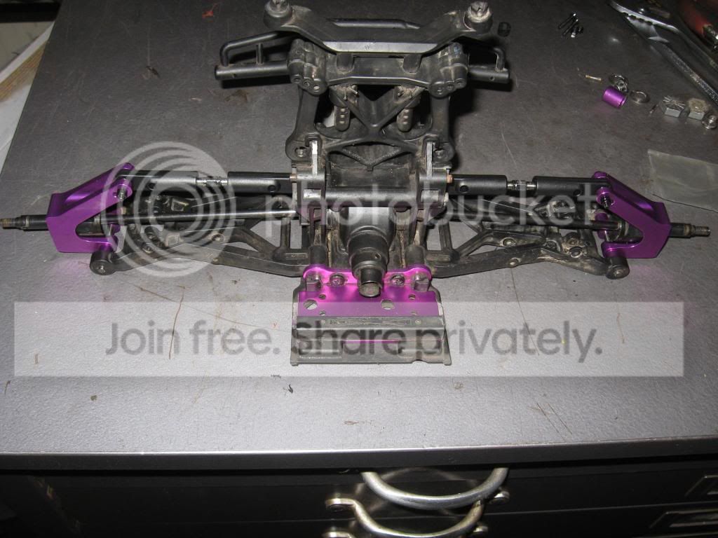

The rear is straight forward with only the bulkhead and shock tower trimming.
Ok thats all for now Here she sits awaiting final assembly.

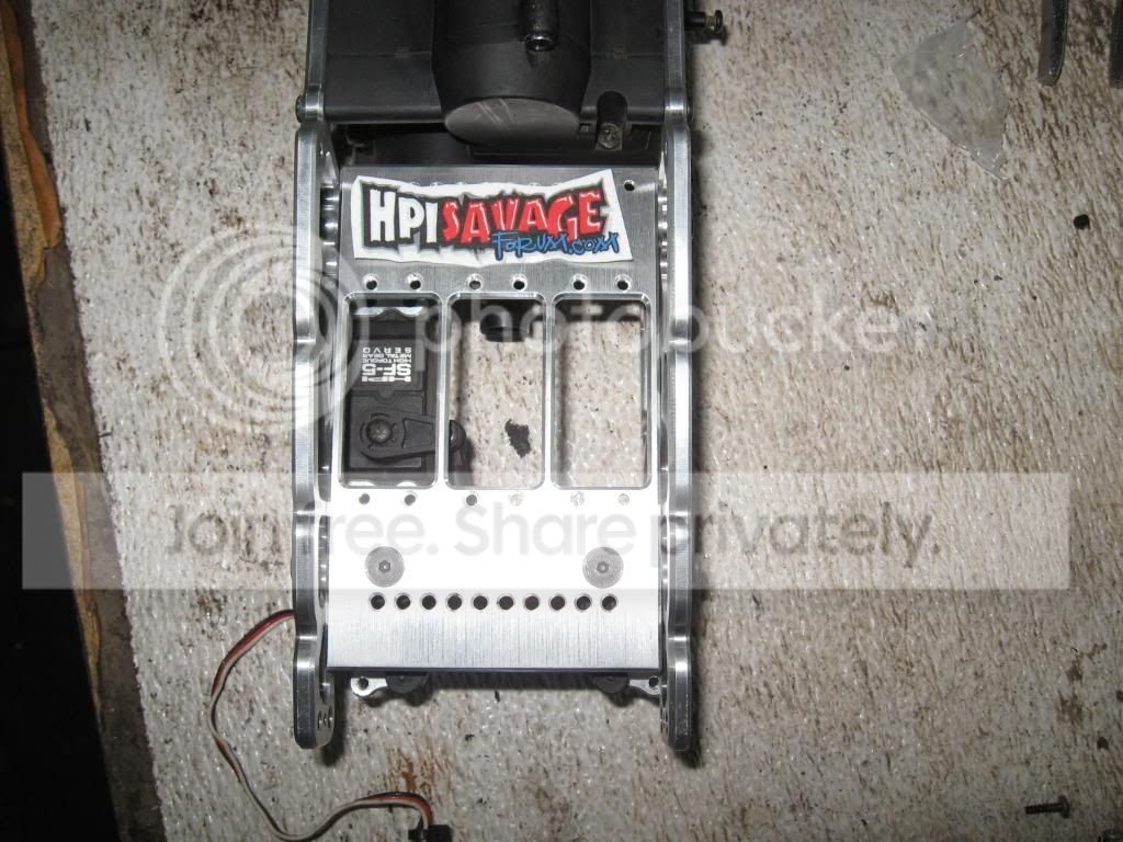

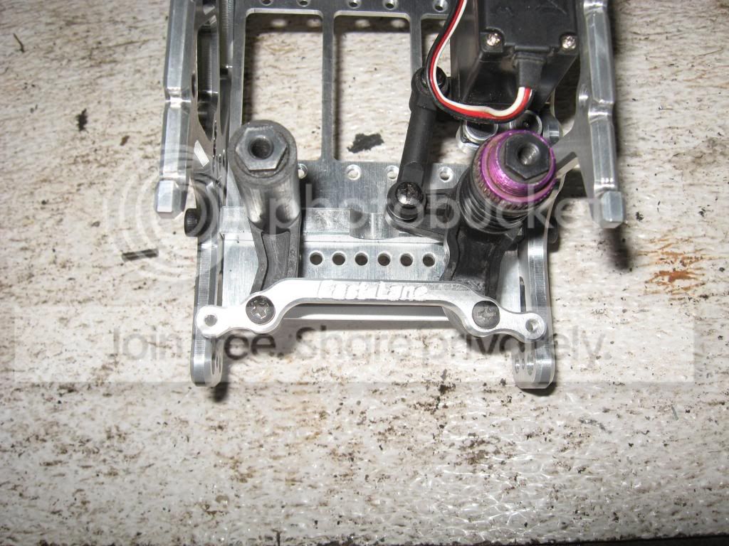

Flm steering link.

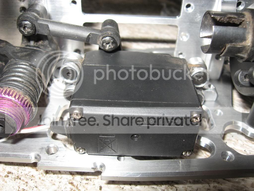

Tvp mounted steering servo
Suspension installation.

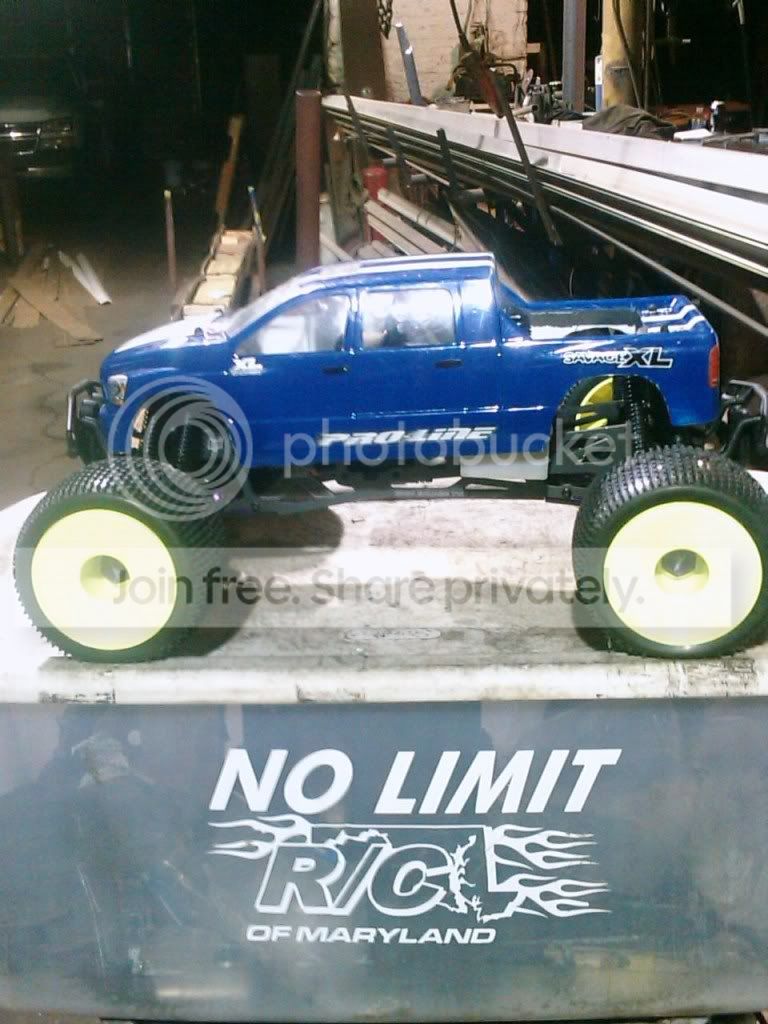

She is on her way!!
