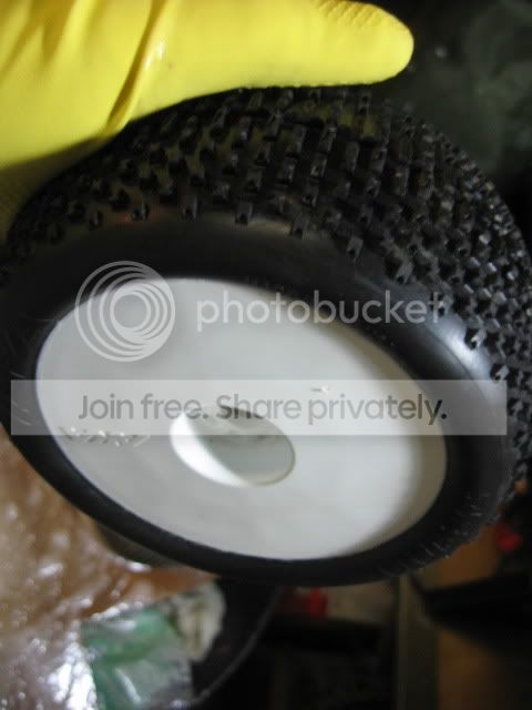

The way my tires are setup are as follow. I either get the wheels with no holes punched or I just tape the wheel from the inside, then I take a 3mm hole punch and put the holes in the tire at the 12 and 6 o clock. These hole allow air to escape from within the tire/wheels assembly.

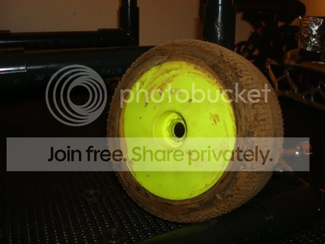

Some of us will not wait for the weather to clear or sometimes the track conditions are tacky and hard pack dirt which leads to this at the end of the day.

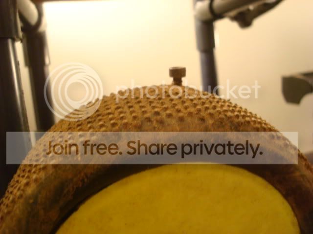

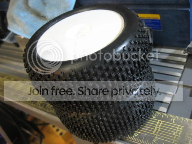

This is the way I clean my tire which have increased the longevity of my tires and foams. But first I wet the external of the tire, then using an air compressor to check for holes, cut or just the glue not selaing the tire to the wheel. I then take a clean cloth to wipe the area of the tire with alcohol and glue that part to seal. Once complete and dried I take a 4mm bolt to seal the 3mm holes.

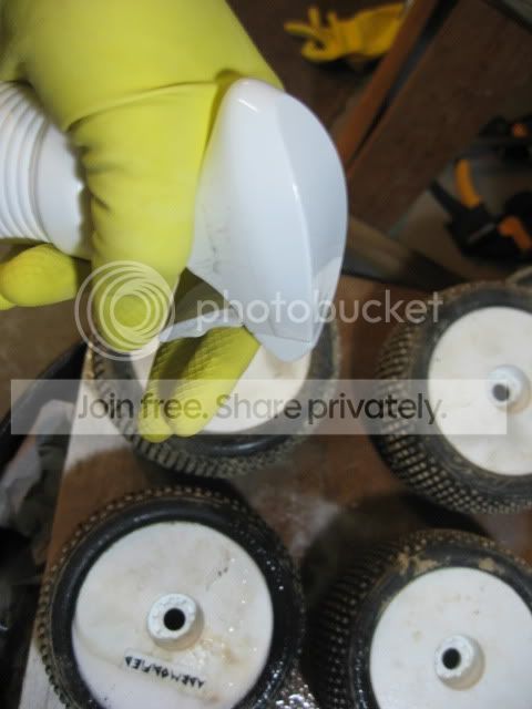

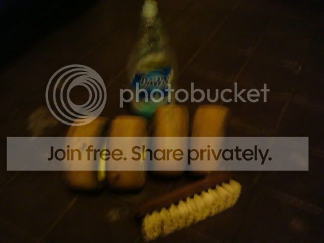

Then I start the cleaning process with soap and a brush.

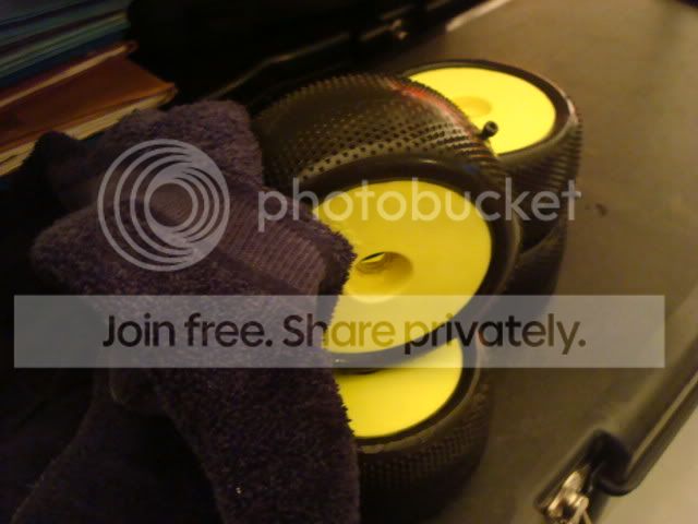

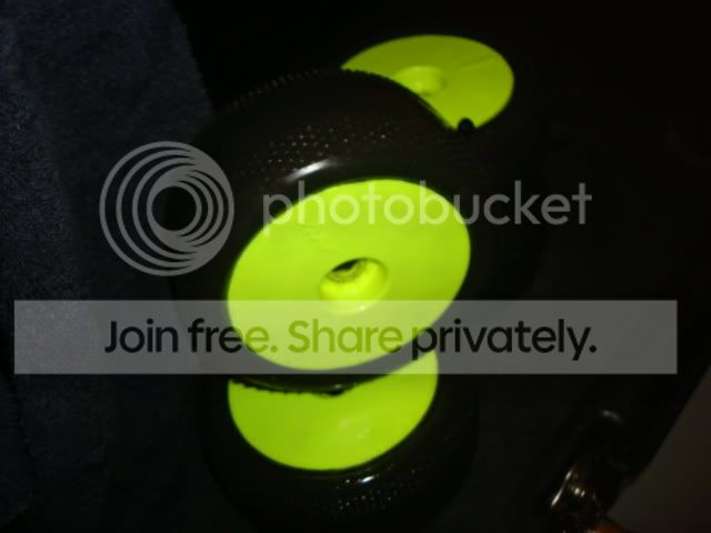

Result
s
Wipe it to near dry and remove the bolt
You could go futher and spin the tire at a high velocity or vaccum to remove residual dirt or water

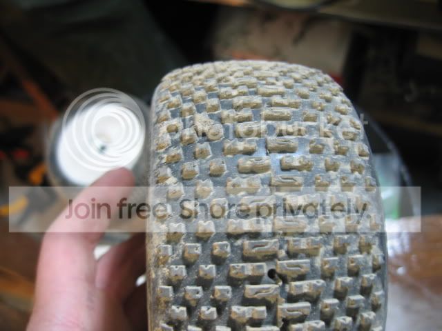

My tire weren't as dirty as yours but still dirty -
I used Miracle spray to clean my dirty parts -
I also have holes at 12 & 6 o'clock.
