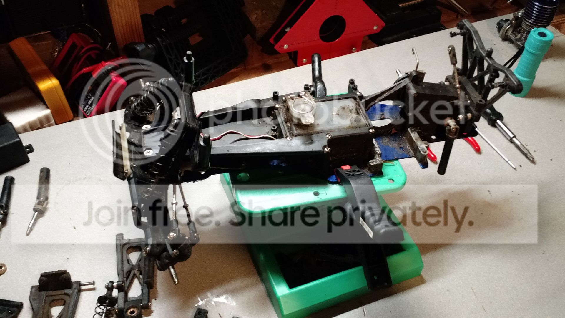

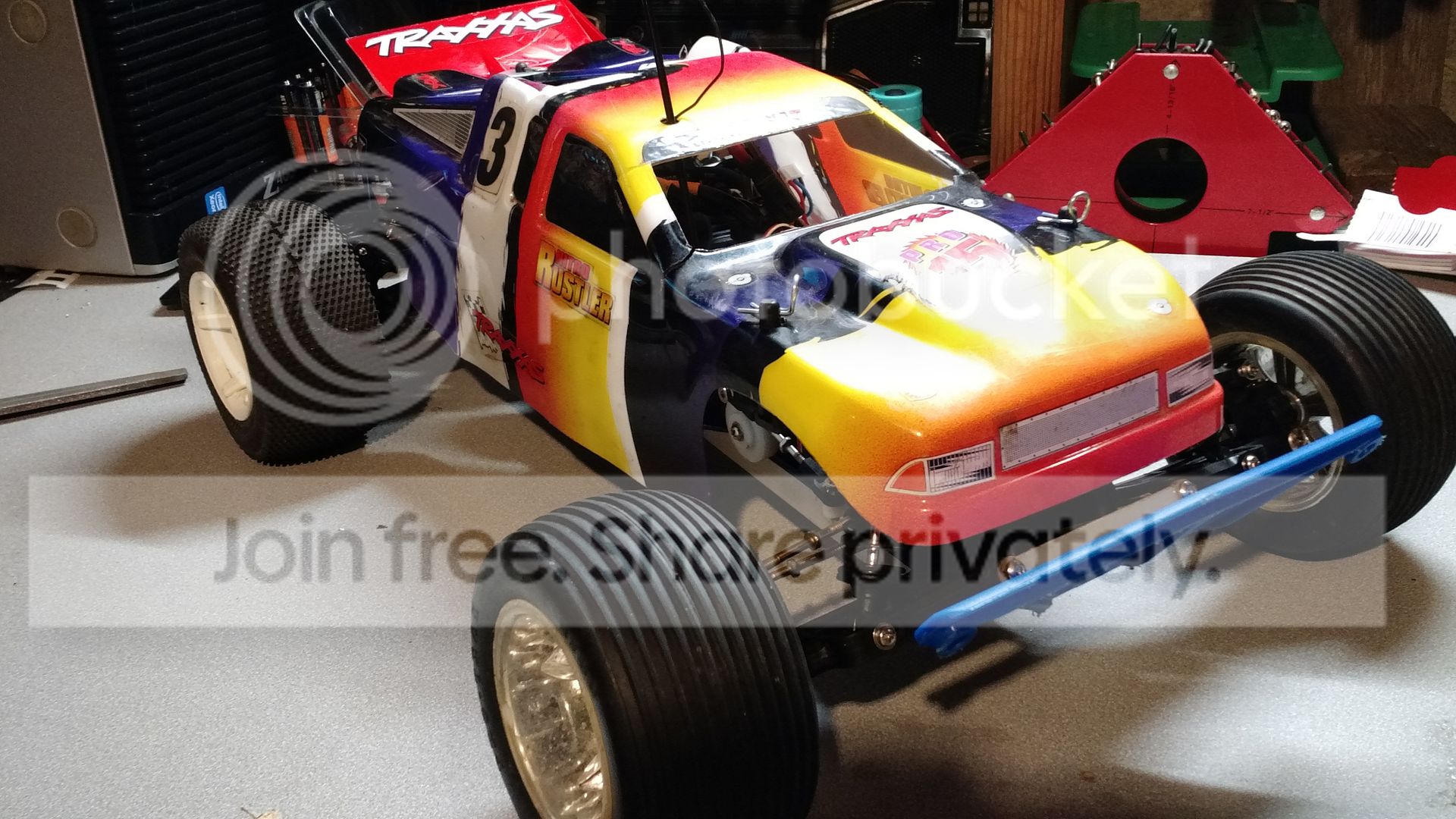

Anybody wanna guess what this is? I'm calling the build Identity Crisis. Why? Because this is a nitro rusty but won't end that way. Picked the rig up for $25. All works, engine ran great. As the truck was sitting on my workbench my 10 year old daughter asked when she was getting a truck. I thought about it 15 seconds and said.....right now.
The Identity Crisis project was born. This is getting converted to a brushless electric. She's too young and impatient to learn the finessing of nitro...and I got the parts for the conversion.

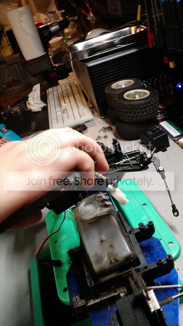

This is after about 20 minutes of tear down with she did mostly herself.

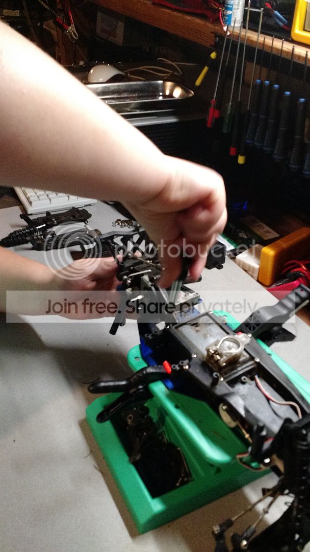

Yessir....got my son into it a couple years ago and he built the Blue Ice project. I believe in keeping my kids constructively involved in something lest they turn into hooligans. Meant to post this pic in the thread starter and forgot...but proof she is wrenching herself.

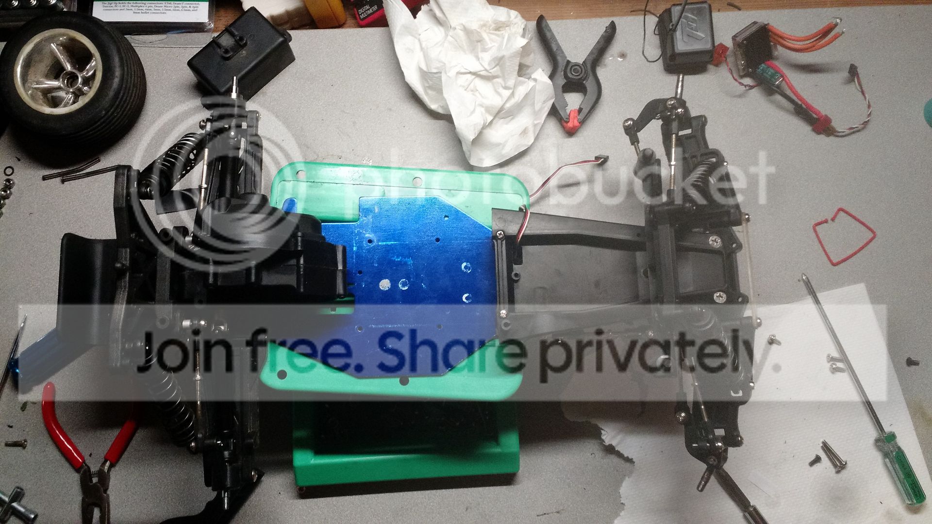

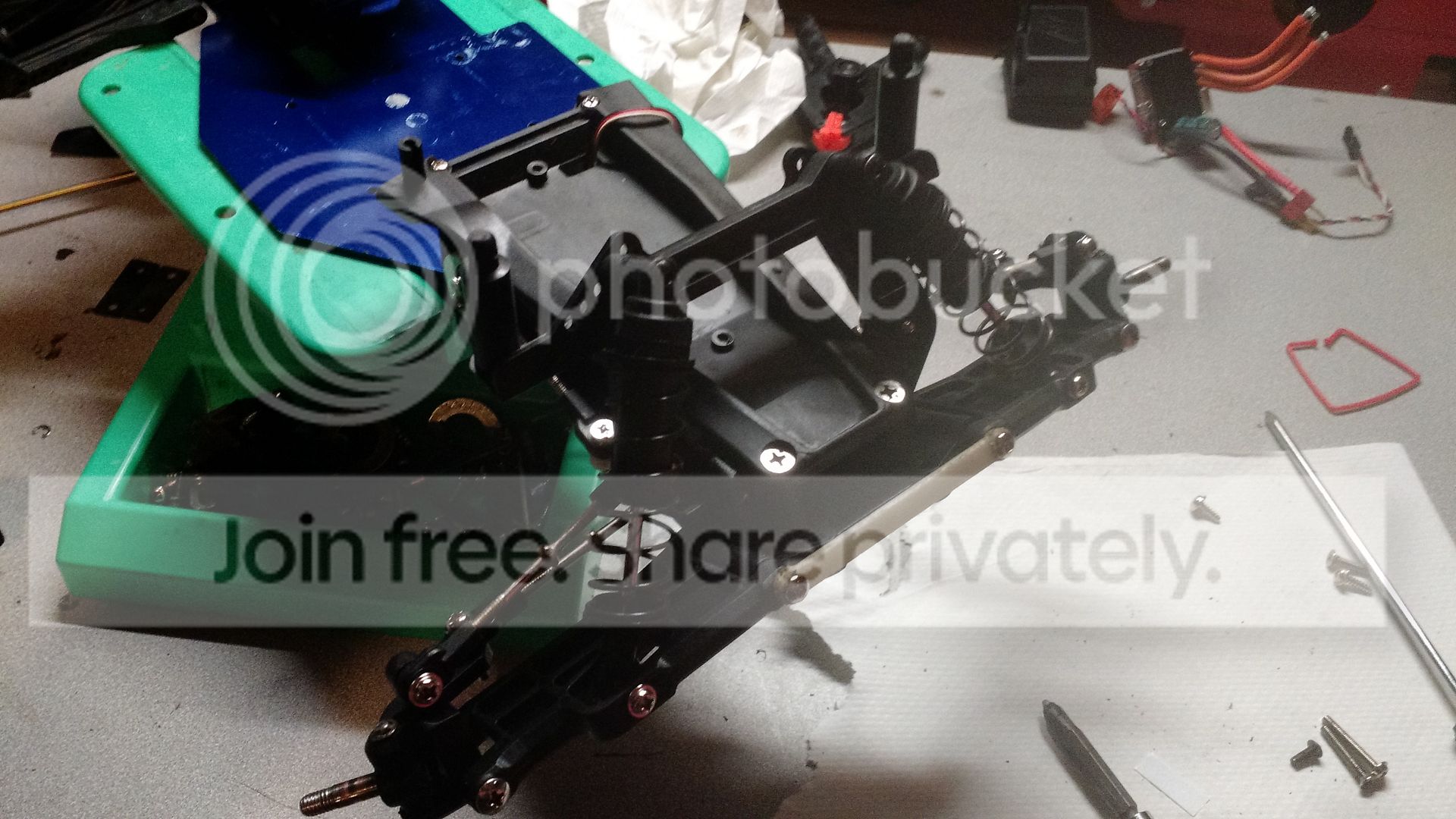

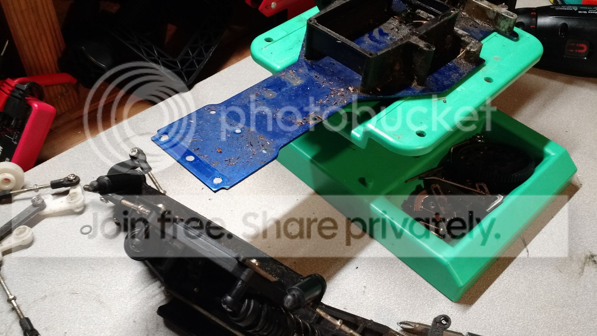

First steps to today's work log was to finish tear down.

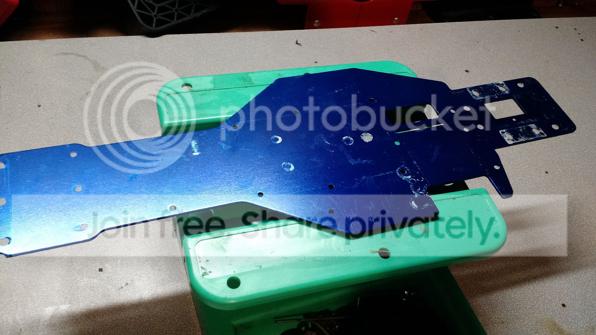

Cleaned up the chassis

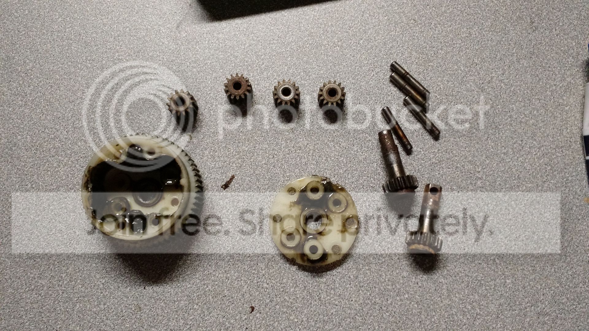

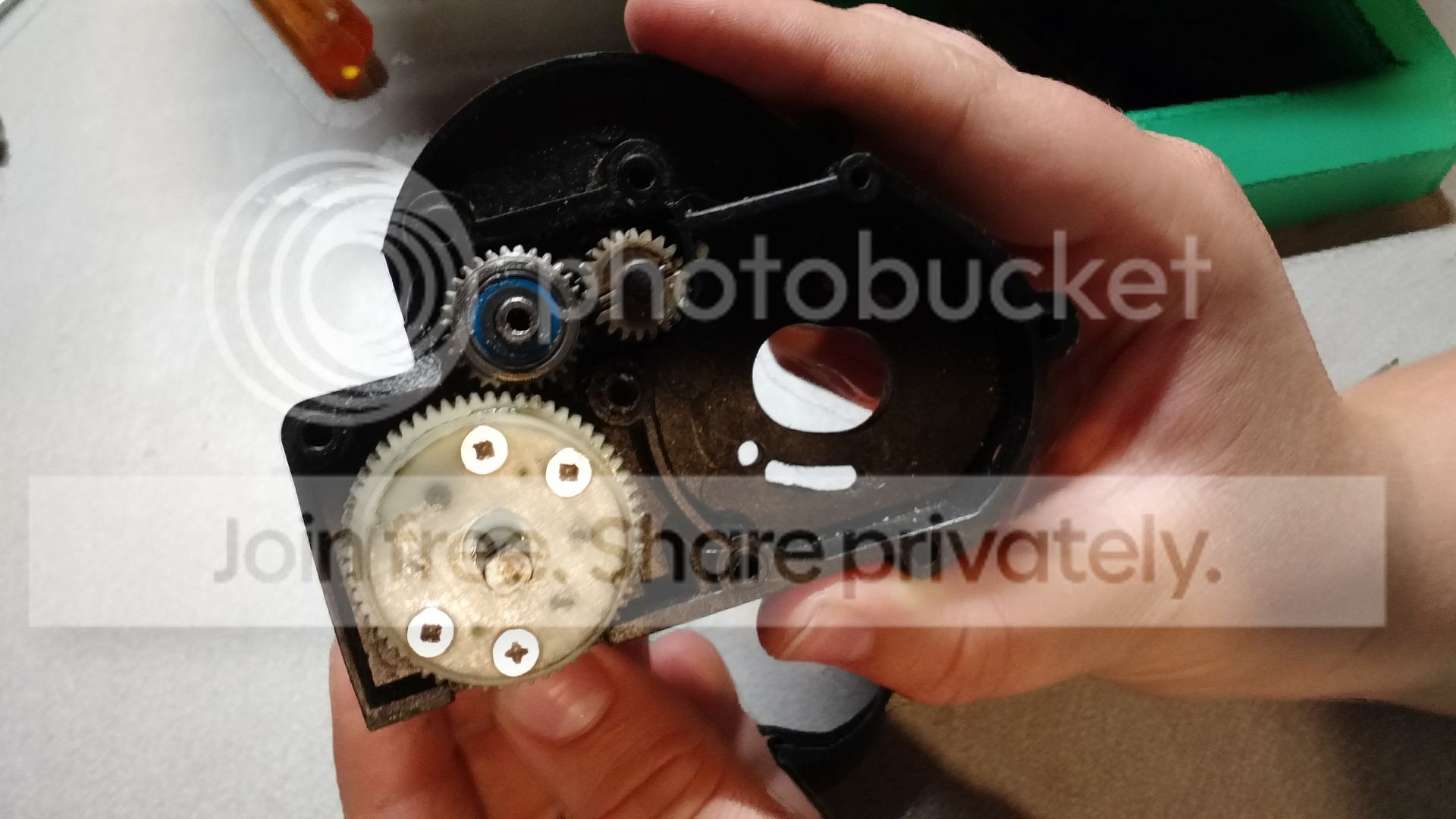

Next up we gotta build a transmission. Elected to re-employ an old traxxas stampede 2wd transmission and brought it up to brushless standards. This was all polished before putting it back together. Differential up first.
Putting the transmission guts in the housing.

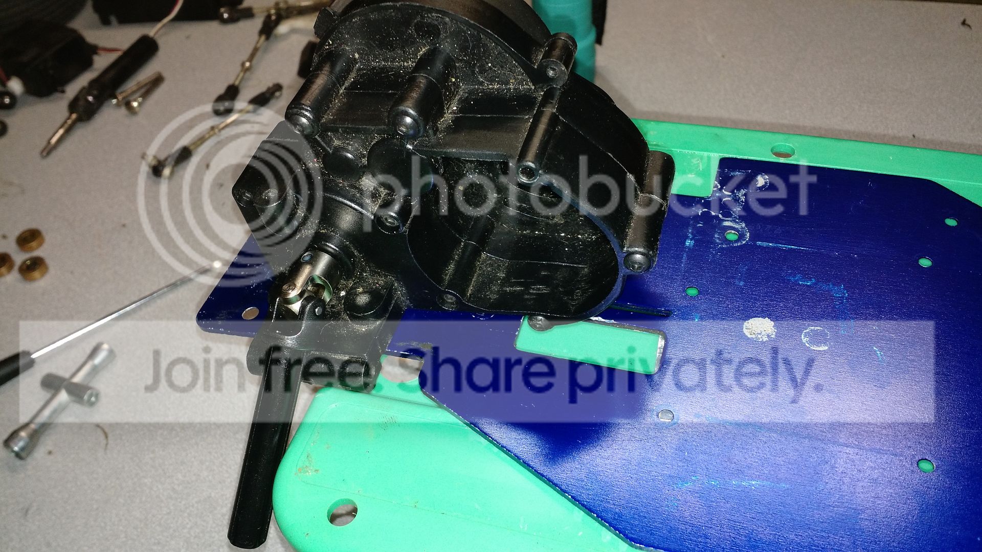

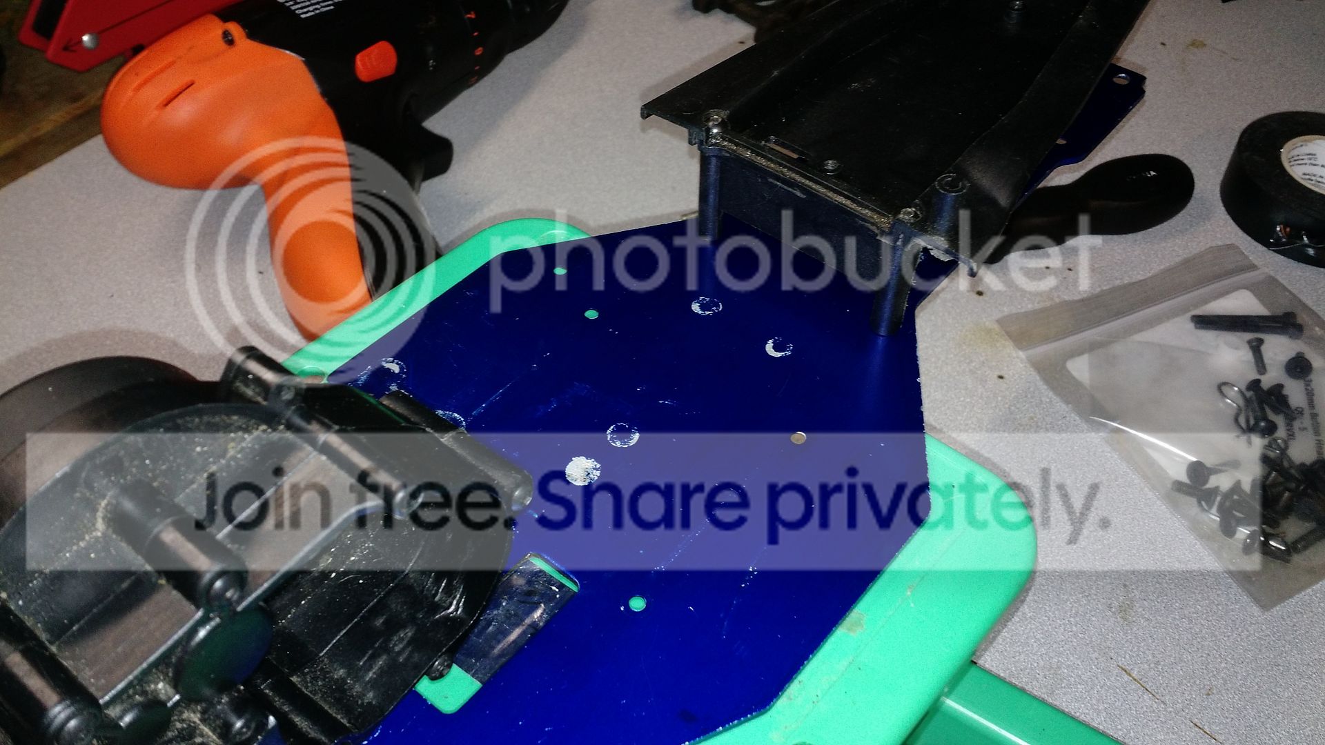

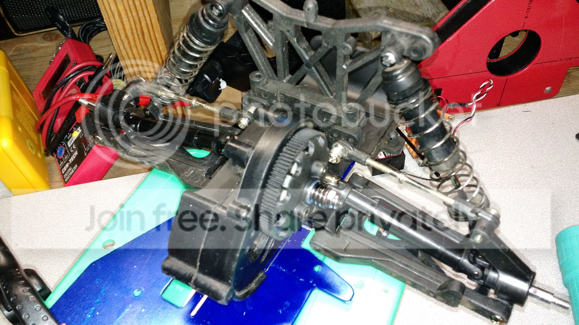

Next we we got the transmission mounted backwards on the chassis plate. Installed steel output yokes and will be using slash 4x4 HD half shafts. The rest of the rear end will be nitro rustler parts.

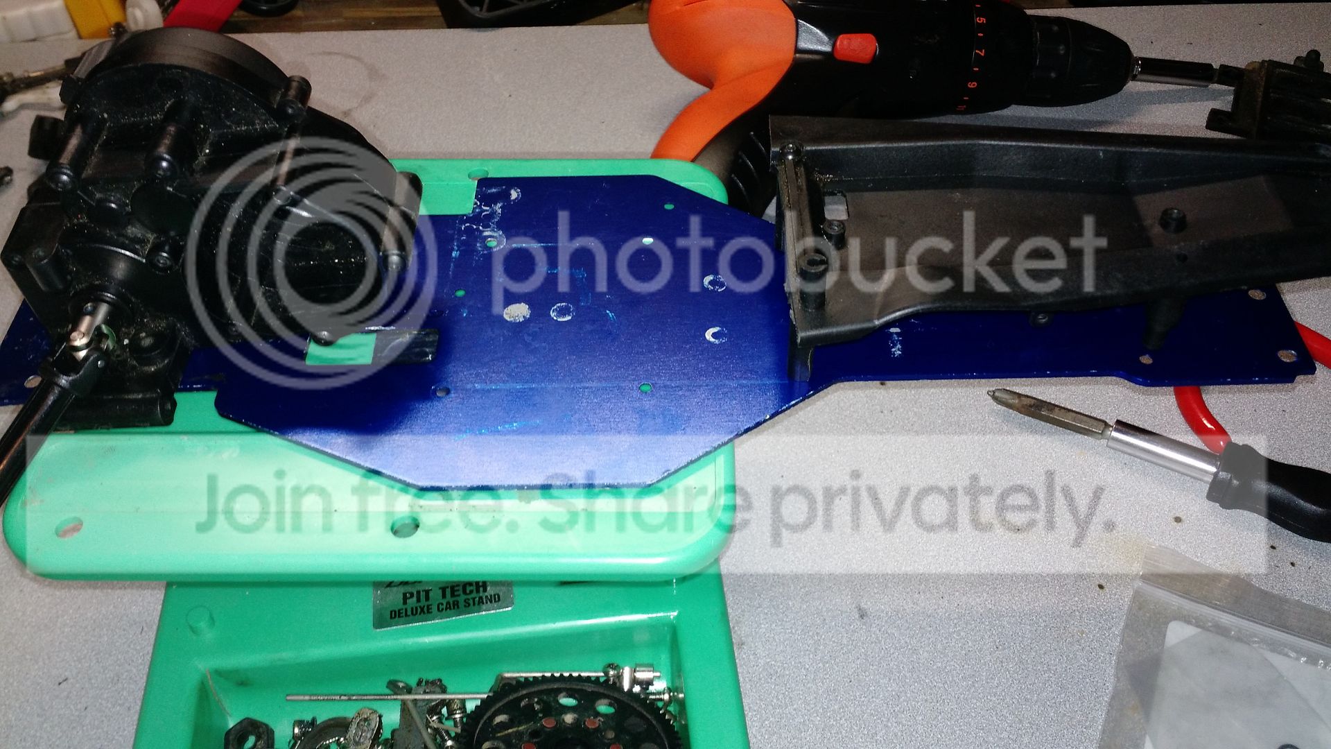

Modified the upper deck to accommodate room on the chassis plate for battery and electronics. Basically the fuel tank box was removed and the upper deck bolted on the chassis in the factory location.

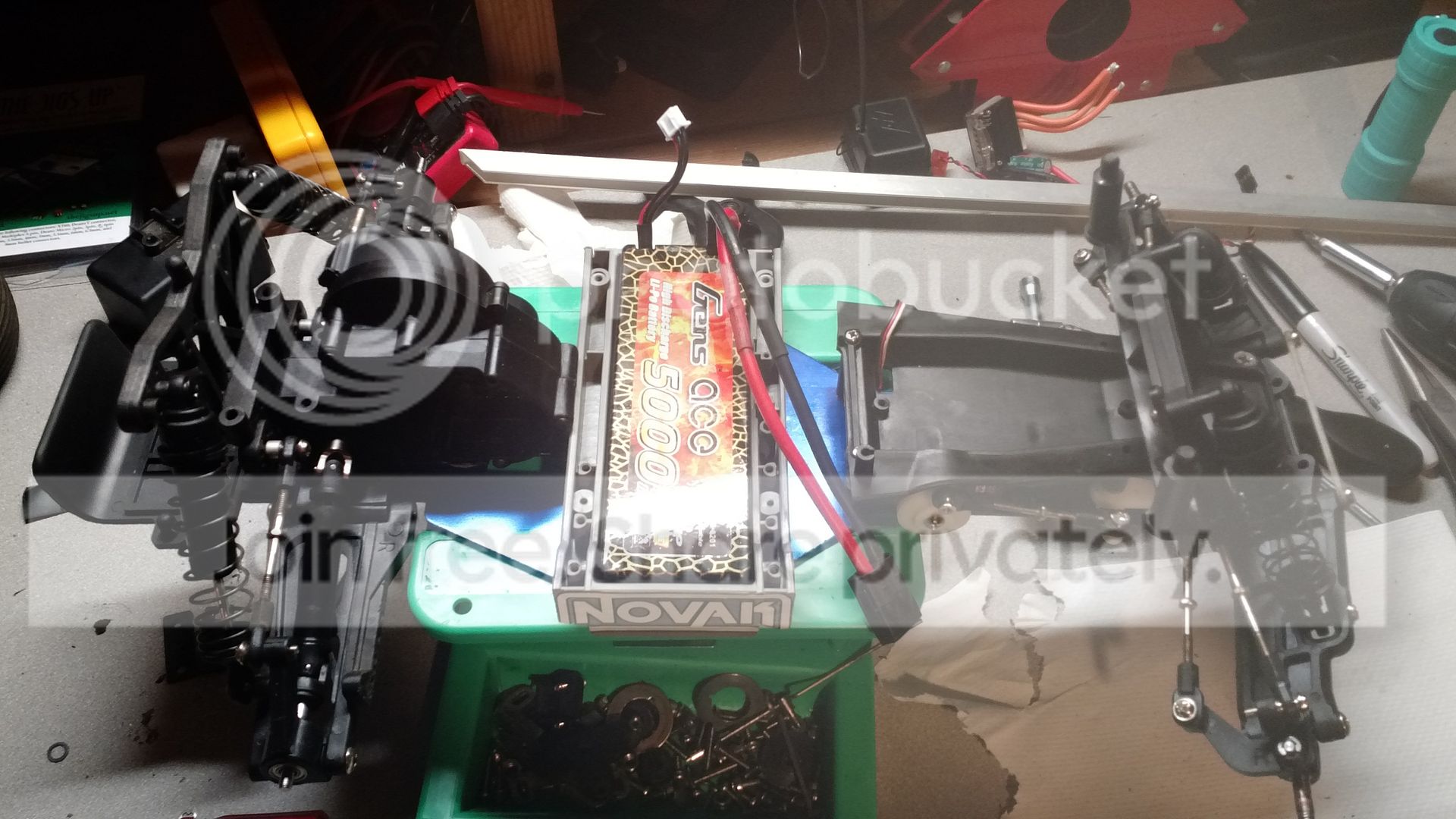

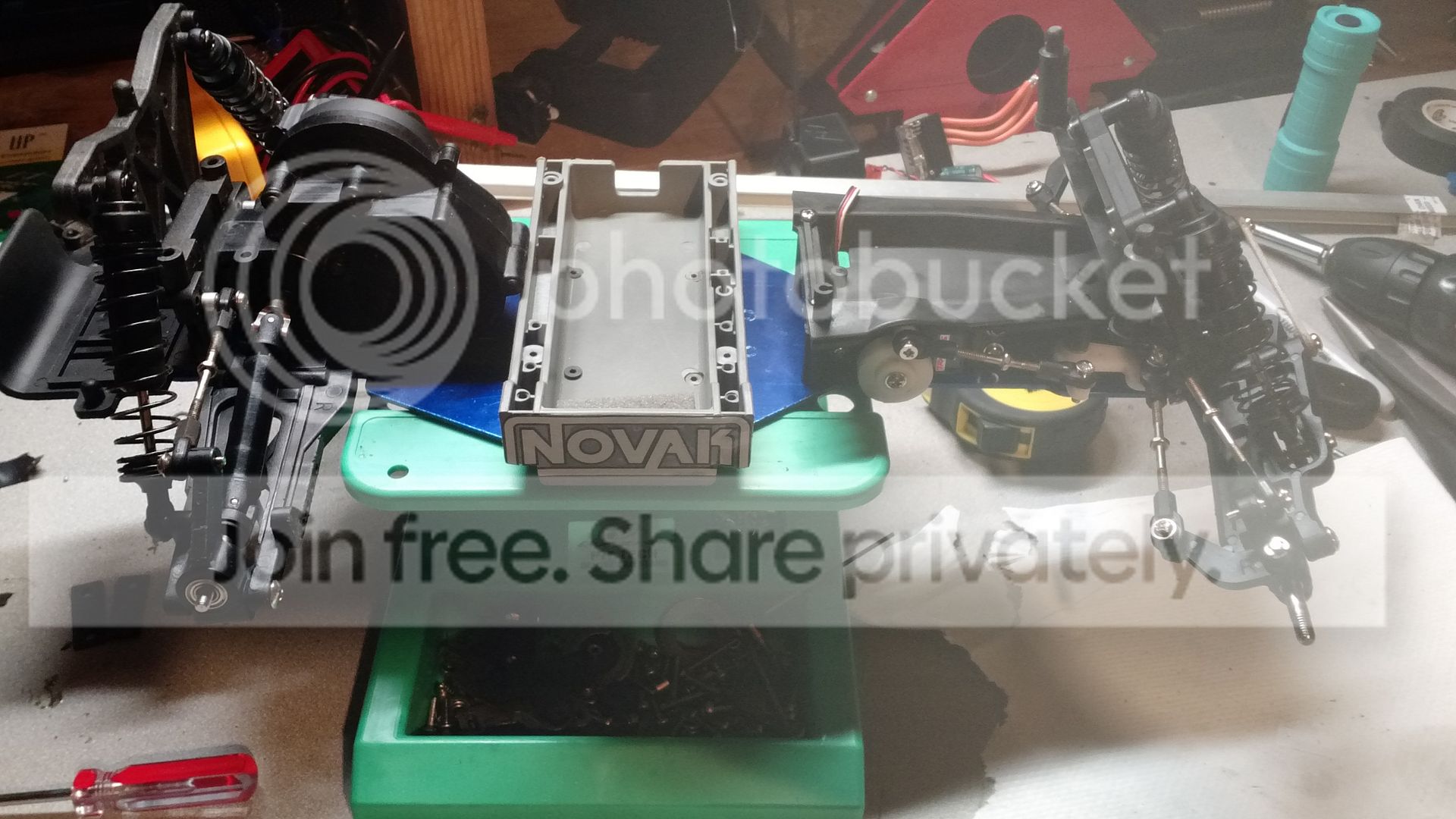

Next we mocked up some electronics to get a feel of where things will go.
At a stand still for the night. I gotta come up an idea for a battery plate and box and a radio box. The youtube video we watched used a ghetto method for the battery plate and box so I am going to come up with a better idea. I'm leaning towards lexan plate and aluminum c channel for the box. Another idea I had is maybe the center of a stampede chassis which is designed specifically to hold a battery. Pretty happy with the turn out so far.

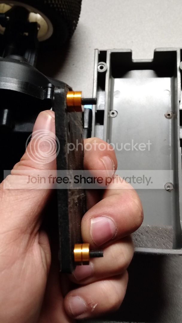

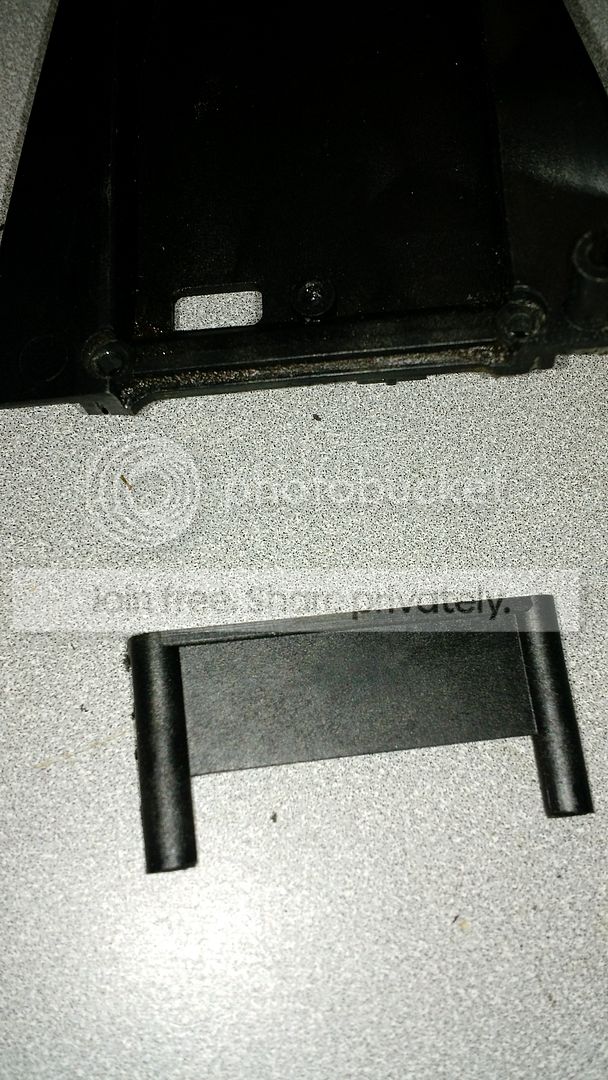

Well we worked the last couple hours getting the rear end ship shape. Rebuilt the shocks and got the rear end pretty much done. It's basically the stock nitro rear end behind the Stampede transmission. No modifications. I did have to make a shim to go under the transmission because I noticed it wasn't sitting flush to the aluminum plate and would have put the control arms at a weird angle. Lexan fixed it right up.

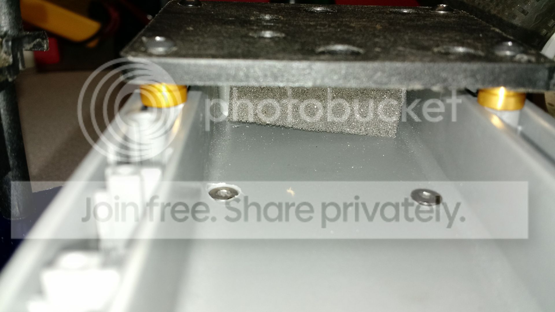

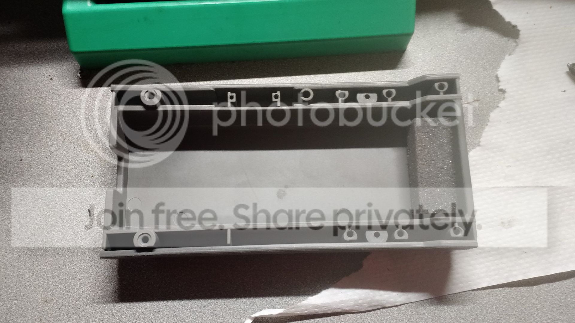

Well, managed to work some HPI into this build. Found a perfect solution for securing the battery. These are the battery "boxes" for the Vorza Flux. will keep the weight down and allow an ides I have to beef up the middle of the chassis plate with some 3/8" aluminum C channel.
I think the radio box from a 1/10 HPI Blitz will work into the mix too. Both items on ebay pretty cheap but I will swing by the LHS and see if they have em in stock.
Well the youngster doesn't have patience for and eBay order to arrive and the LHS didn't have the vortex part ibwas hoping for so I picked up the 2wd Stampede chassis and will go with our 1st idea to mount the battery. Also picked up the radio box for the build which will be from a duratrax something or other.

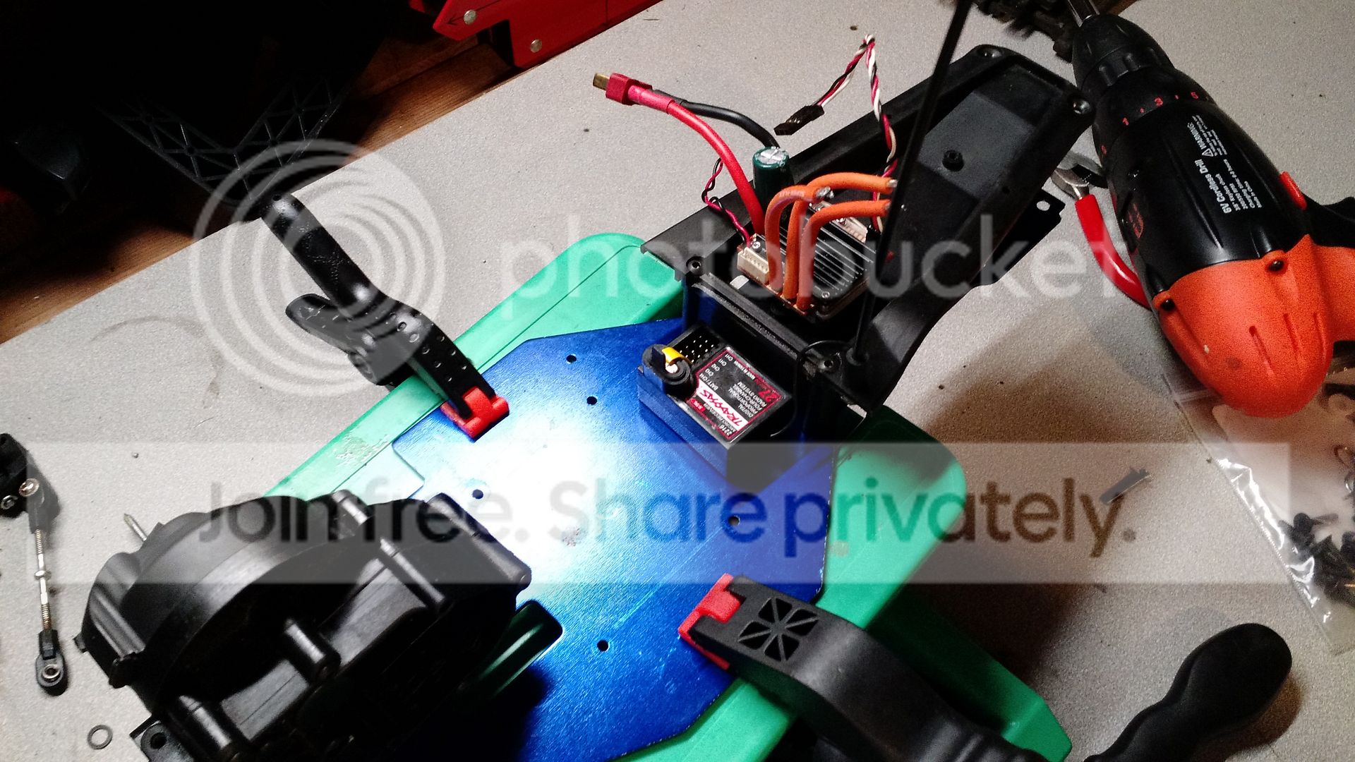

Wrapped up most of the project tonight. Just need to pick a motor out that will match nice with the Novak Edge.

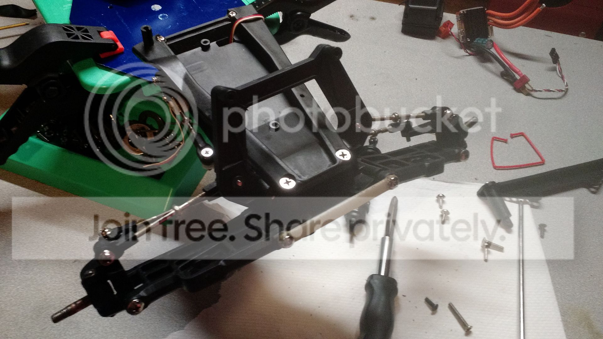

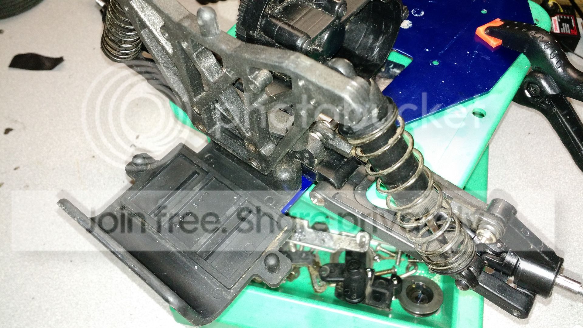

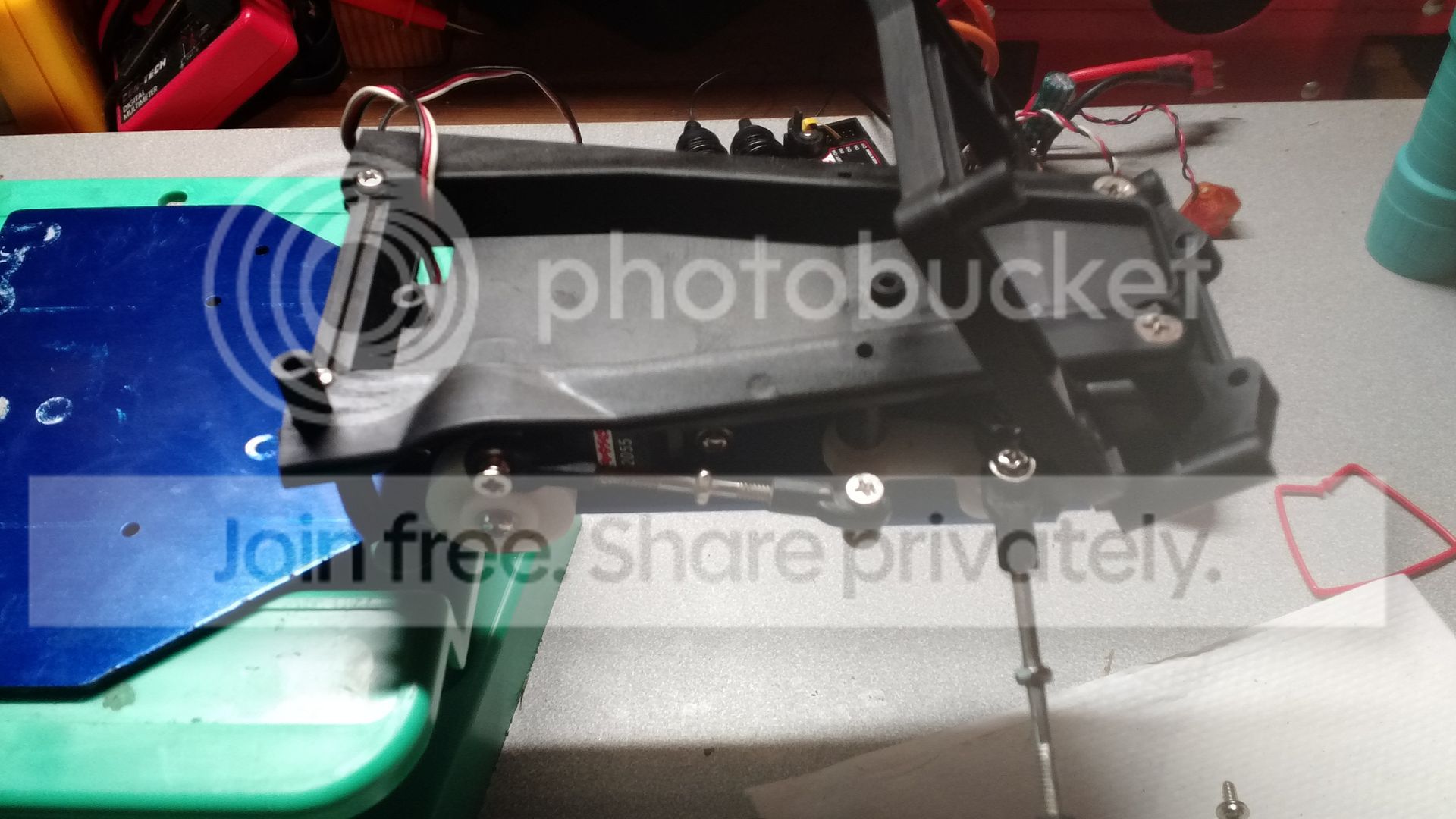

Working on the front end.

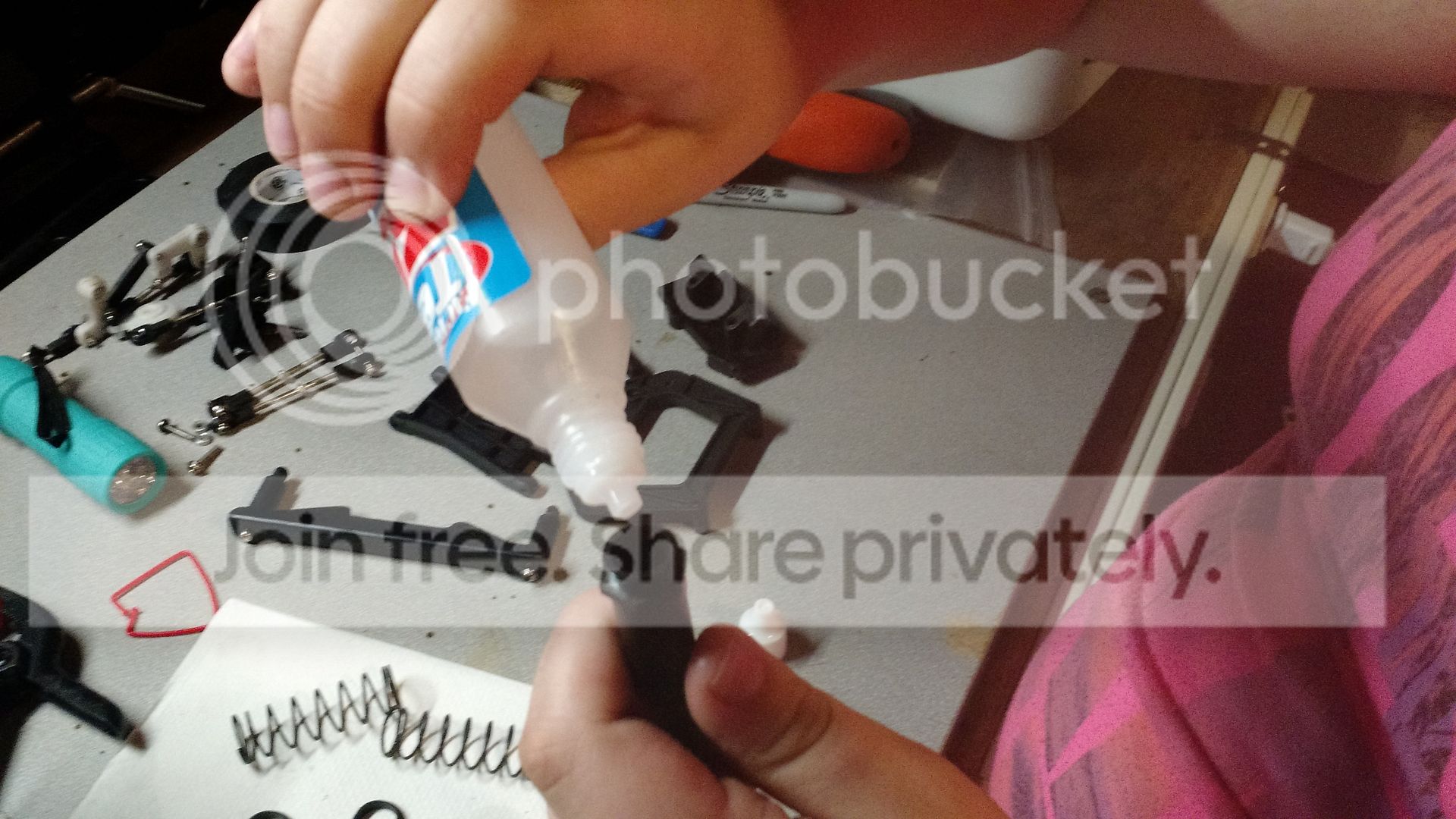

Rebuilding the shocks.
Final assembly on the front end.

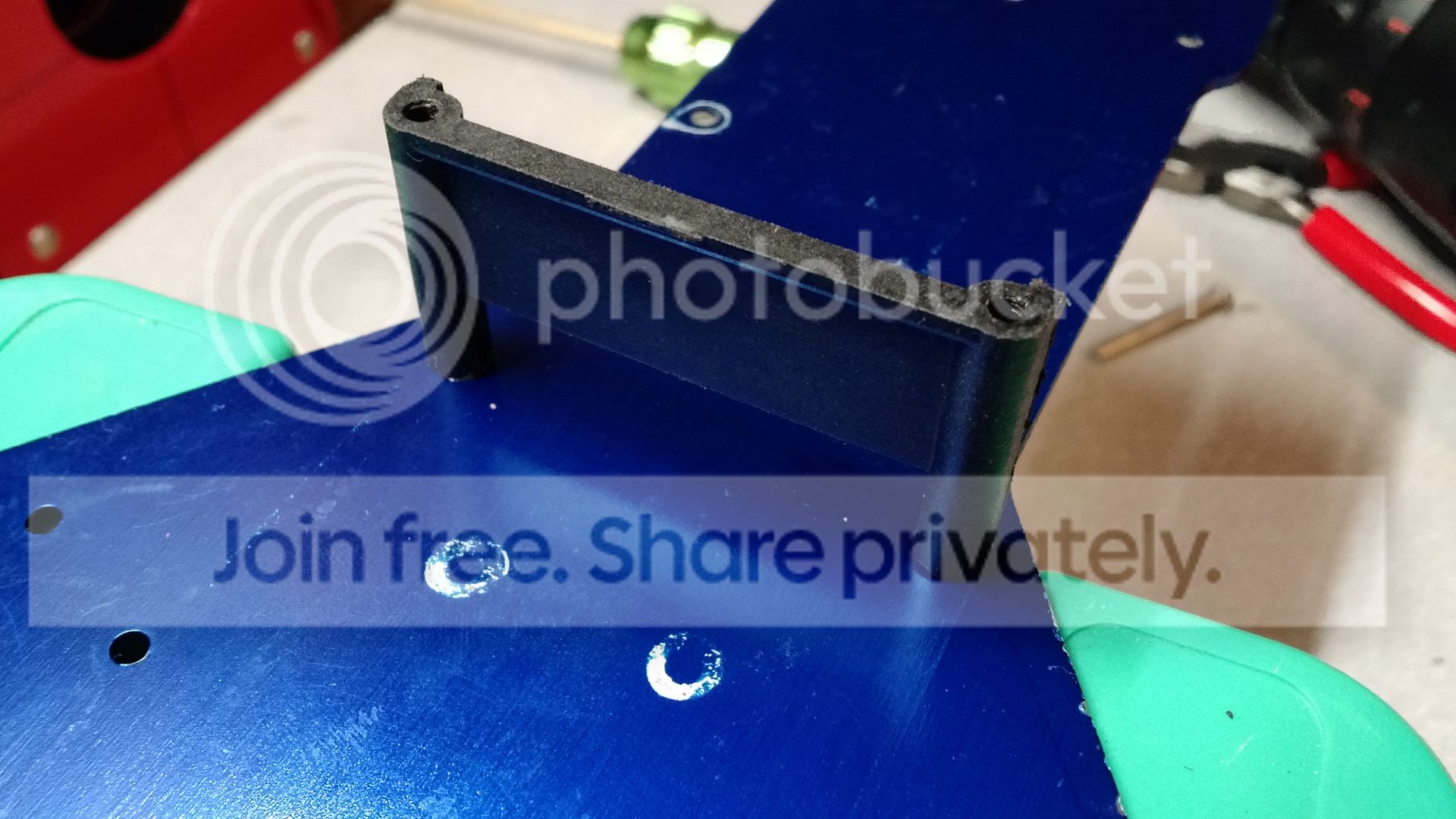

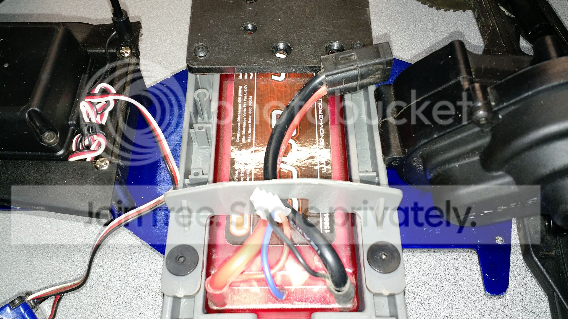

Battery box solution was a Stampede chassis trimmed down to just the battery box.

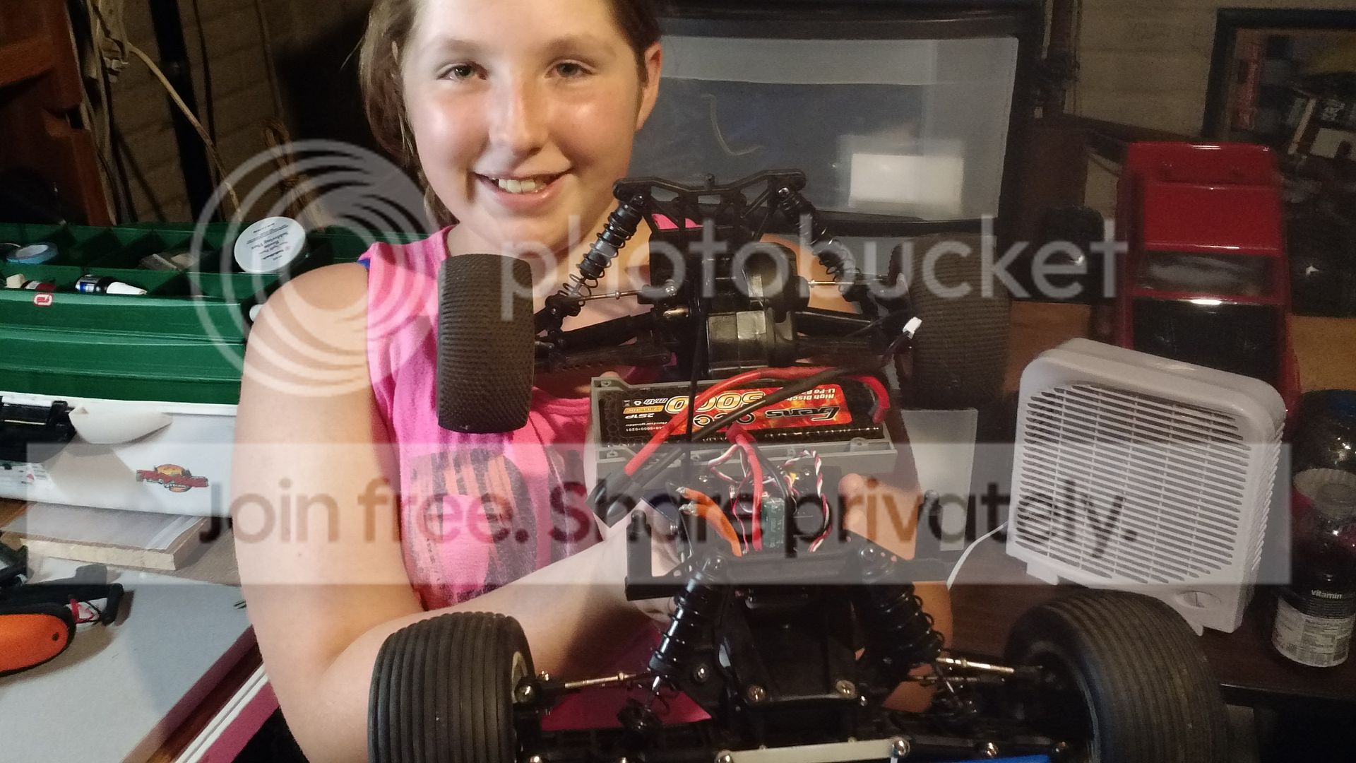

Electrics mounted up and wheels put on. How bout that smile!!?? She did a good 95% of this build herself. Just need a motor and a new lid. No doubt she will want it pink or purple.
Looks like well thought out placement/ mounting of that battery. How's the balance on the chassis? Make sure you get some video of her taking it out for the first run!
It is balanced well from side to side and front to back. Obviously lighter than its former nitro self. Mounting the battery the we did kept the weight pretty much dead center so I don't expect any chassis roll.
The one thing we noticed is the rear end when sitting still has no upward travel/ downward sag. Little concerned how that will handle cornering and bumps if the shocks run fully extended under throttle. My suspicion is the nitro weight isn't there anymore so it's not allowing any rear end sag with a lighter rear end and nitro springs. We will have to see how it handles but I think a softer spring will be the answer. She used 35w in all the shocks so I think that will be ok.

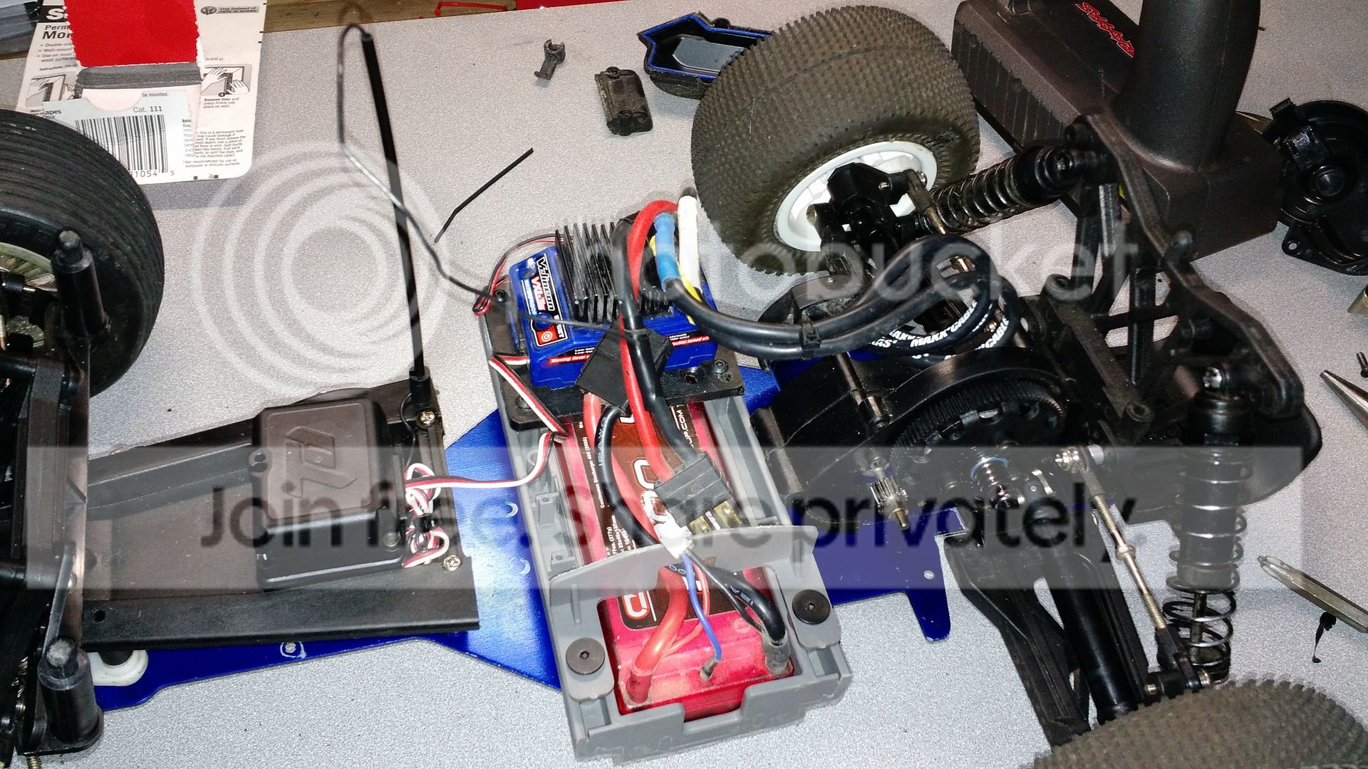

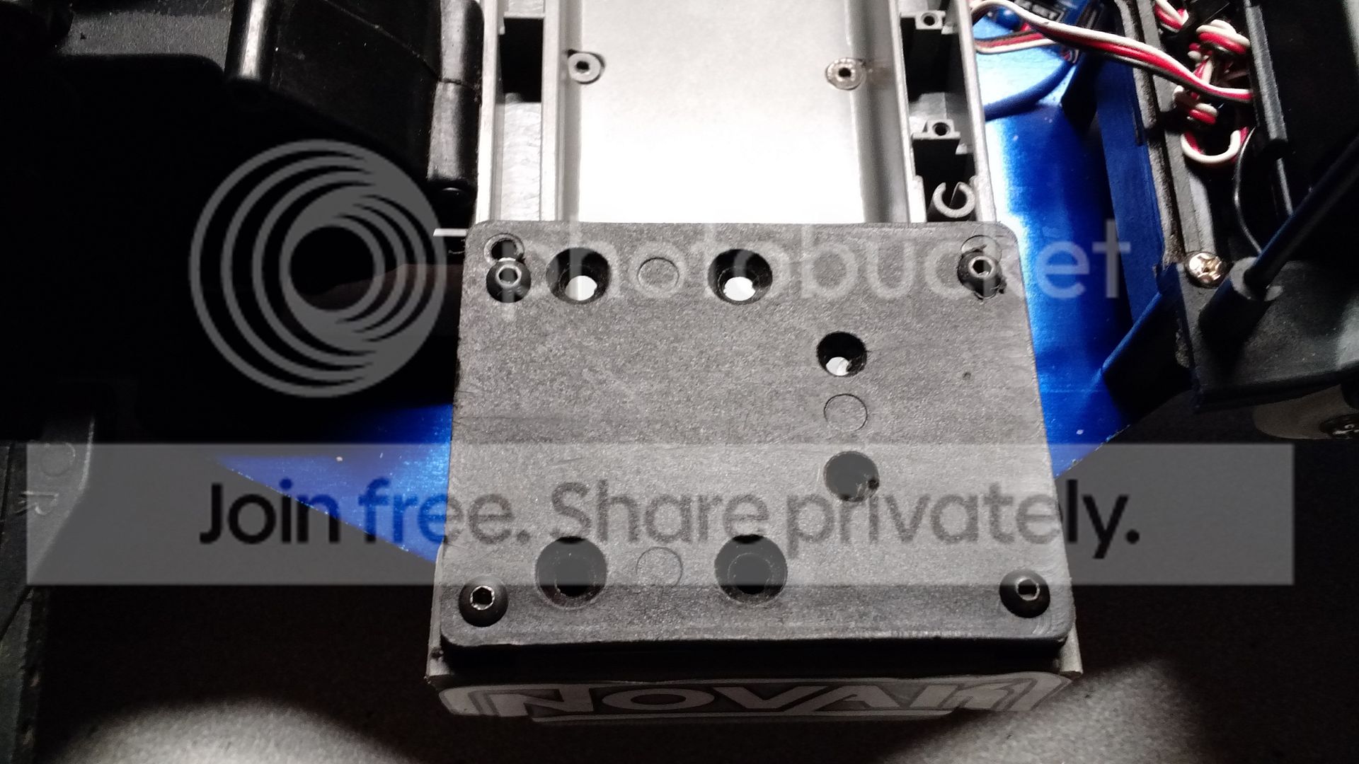

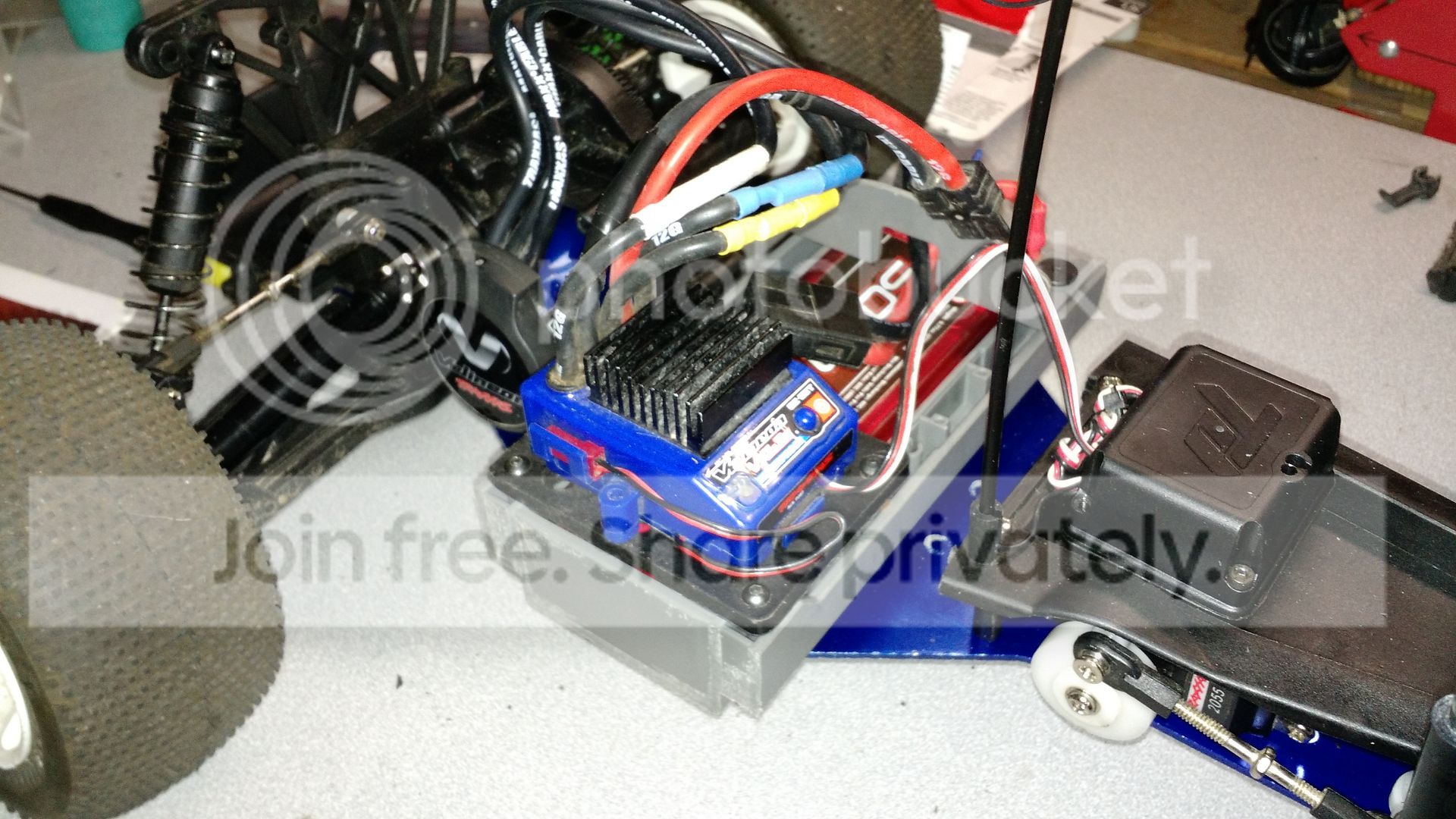

Well, tomorrow the youngster turns 11 and I would really like to get this puppy ready to run for her so I snook off to the shop and worked on the last few details for her. Found the VXL-32 esc to be too big to fit in the space in front of the radio box so had to get creative.

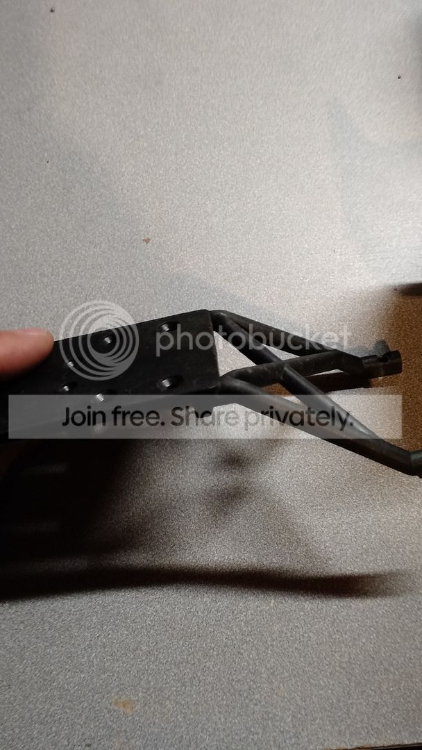

If you are not familiar with trx parts this is the front skid for a 2wd stampede.
Whack off the x brace and you have a flat plate. A couple ofna spacers and button head screws.....
and boom...you have a mounting plate.
Put all the pretties on and it's almost ready to roll....Had to switch to a venom battery cuz the gens ace was a little to thick

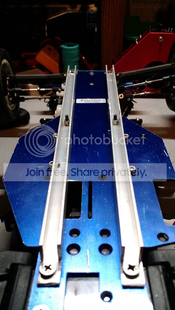

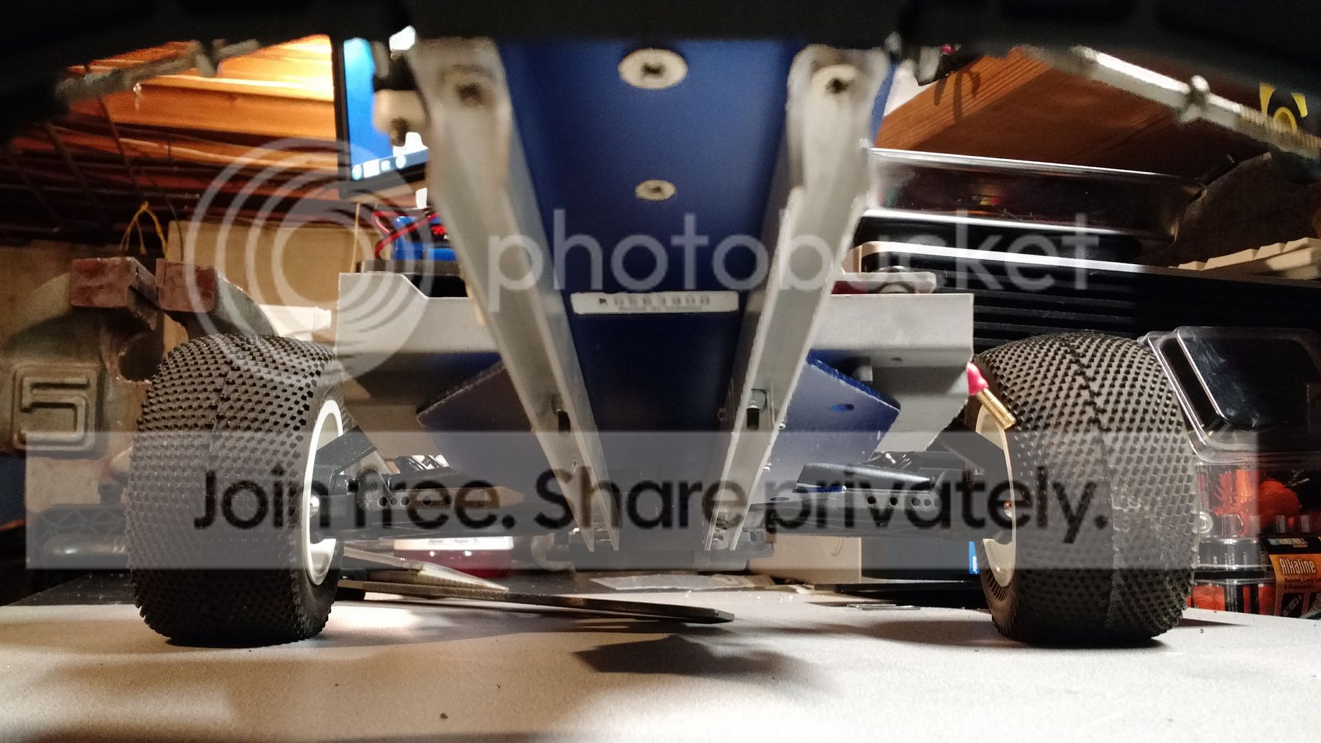

Final day of the build. Since we took off all the nitro parts that supported the chassis there was a lot of flex in the middle.
Corrected with some 3/8" x 1/4" aluminum c channel. Used the existed chassis screw mounts in the front and rear then drilled a hole through the chassis and c channel and put a bit and bolt to suck everything up tight.
