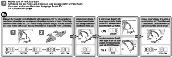

have you disabled the LiPo cutoff, you will not need it if running NiMH batteries, sounds as if it is kicking in and stopping your rig from operating......

I'm pretty sure this is going to be the LiPo cutoff issue. When you put a load on a NiMH the voltage drops way more than it does on a LiPo, so it's more likely to trip the cutoff.
