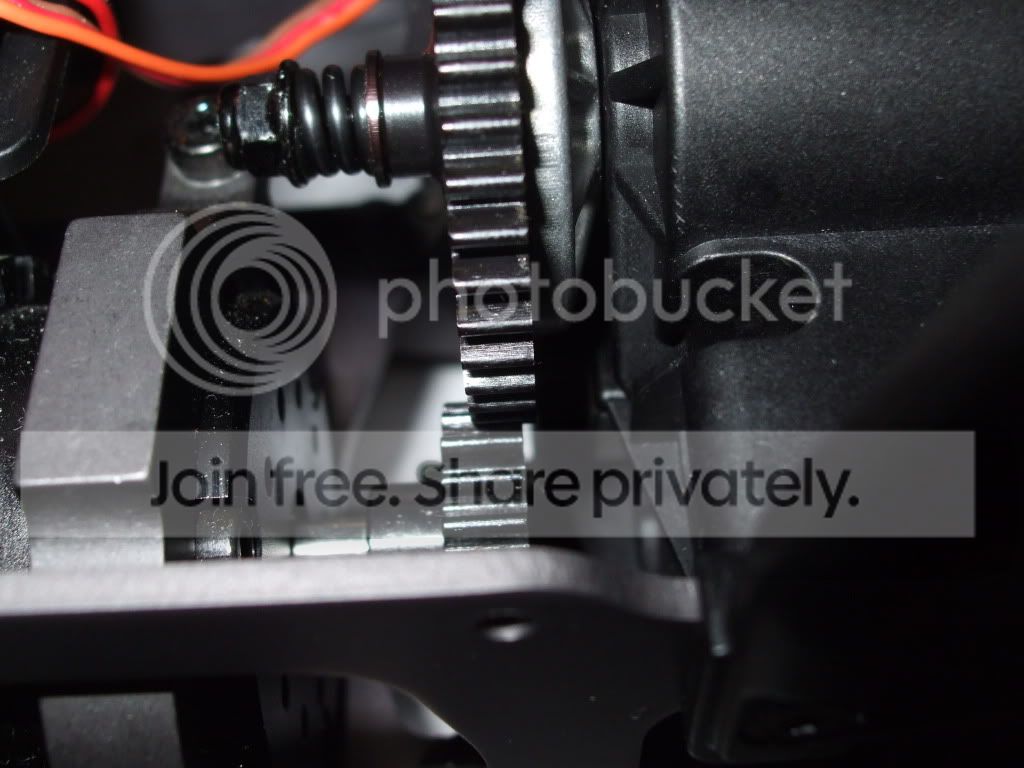

Is this OK

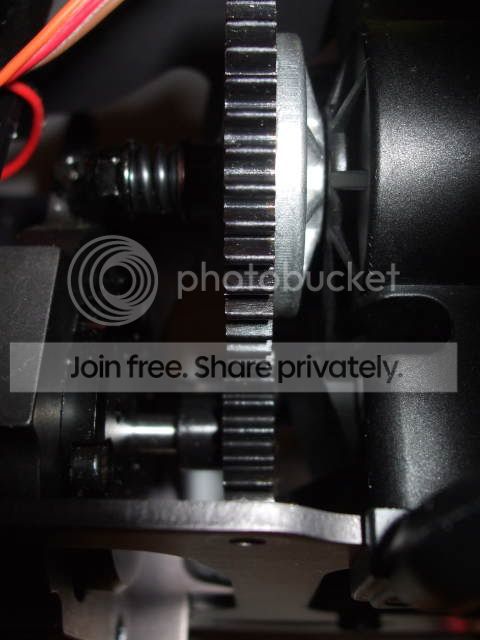

glad you fixed it cuz otherwise its no good, with just half the tooth meshing you will be more pron to striped gears.
Good work, You even did it the best way, Moving the motor forward instead of sliding just the Pinion forward.
