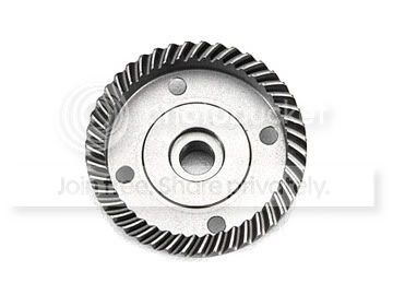

Here is the D8T ring gear (incase people don't know what we are talkig about), they look nice, but prolly won't cut it.
