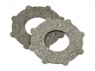

I have a hard time believing the slipper pads have glue on one side. But I really wonder how else the very sticker glue like guey that I found in between and around the slipper plate and the spur gear have ended up there.
Just another odd thing buggered up by the nutcase who had this car before me.
Well, one day I will hopefully have found all oddities and fixed it :)
I assume they are the same on both sides, and it doesn't matter which way you turn them when installing. Or?
Perhaps it's some kind of belt spray or something alike he sprayed onto it, when it was actually the clutch that needed maintenance. That was faulty put together as well, the clutch, both roller bearings was inside the clutch bell.
all the pads I have seen have sticky on one side. if it is missing I suppose some contact cement could be used to stick it to the backside of the gear.....
Aha, so it really was like that. Thanx for the info! In that case, someone, HPI, or the previous owner, put the slipper pad on the wrong way. I am guessing the previous owner.
The one I am from now on calling the nutcase.

Considering the forces in act here, a sticker/glue must be mostly to keep the slip pad in place during assembly. There's also a mechanical design to keep the slip pad from slipping against the spur.

The pad is designed to go into recesses to keep it in place on a gear the sticky side is just used to hold to the spur while assembling it....

I read all your posts and am still scratching my head as to why you would even consider using j b weld for that application. Just a little something sticky to hold it in place for assembly is all that is needed.

don't get me wrong, JB Weld has its uses to be sure, but just not in this application.... there has to be some kind of slip built in to allow stresses to be released safely and the slipper is useful for this... I run mine mostly locked down and even running it this way there is still a bit of slip allowed to keep from stripping gears in the tranny and spur pinion also....
this post is a couple of years old but i am upgrading the clutch on my savage 25 i have a new Graphite Slipper Clutch Kit, this pad had nothing sticky on it like stock pads. if i can assemble it without clue it will work?
