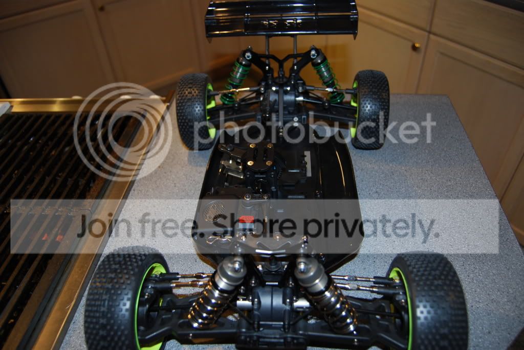

Hey,

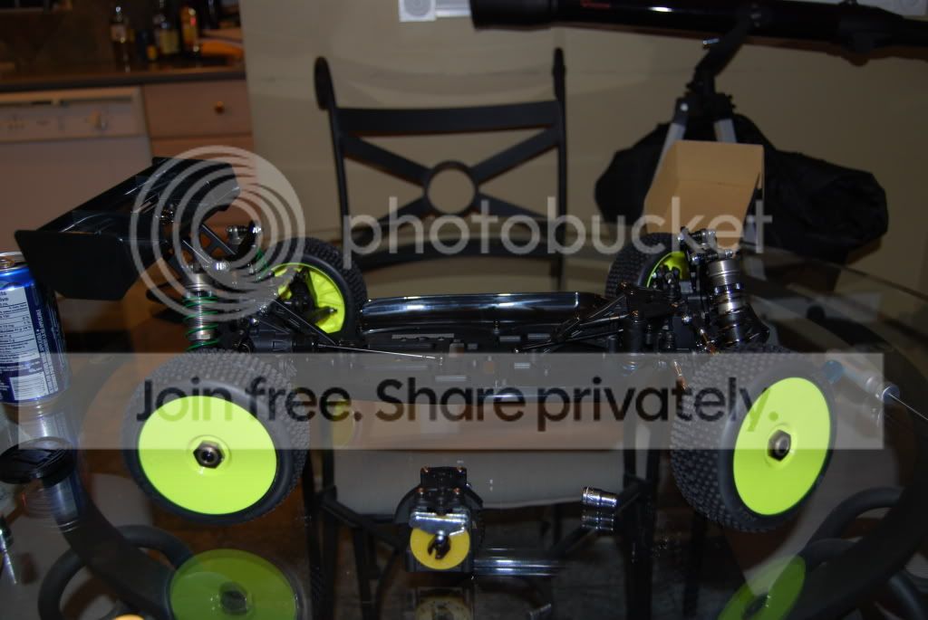

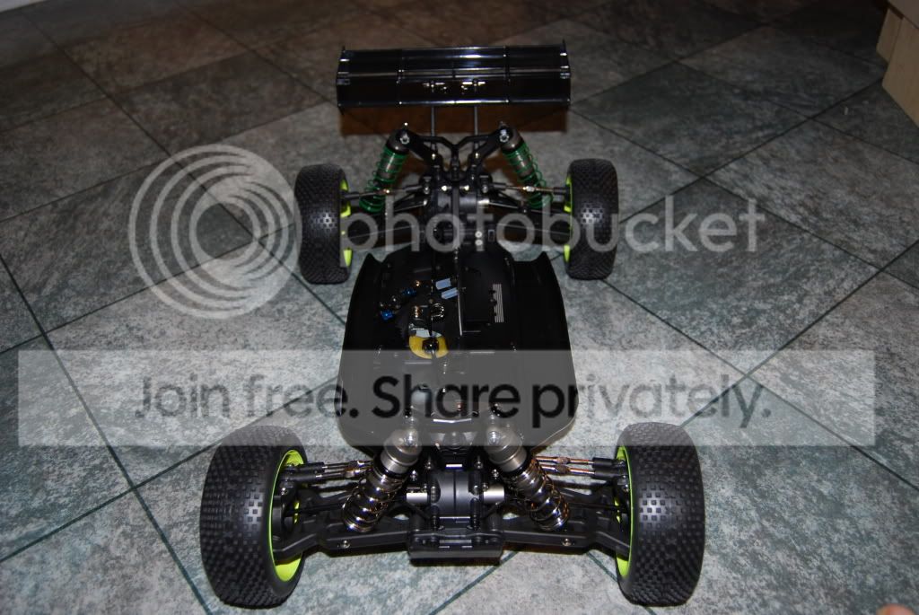

I had some people wanting me to do a thread on my 8ight 2.0 conversion so here it is. I will try to up date it as much as possible. Here is my 8ight as of last night. The tank and radio box is already out.
The next thing I did was take out the throttle linkage, and pull off the brakes for the obvious reason of not needing them with electric.

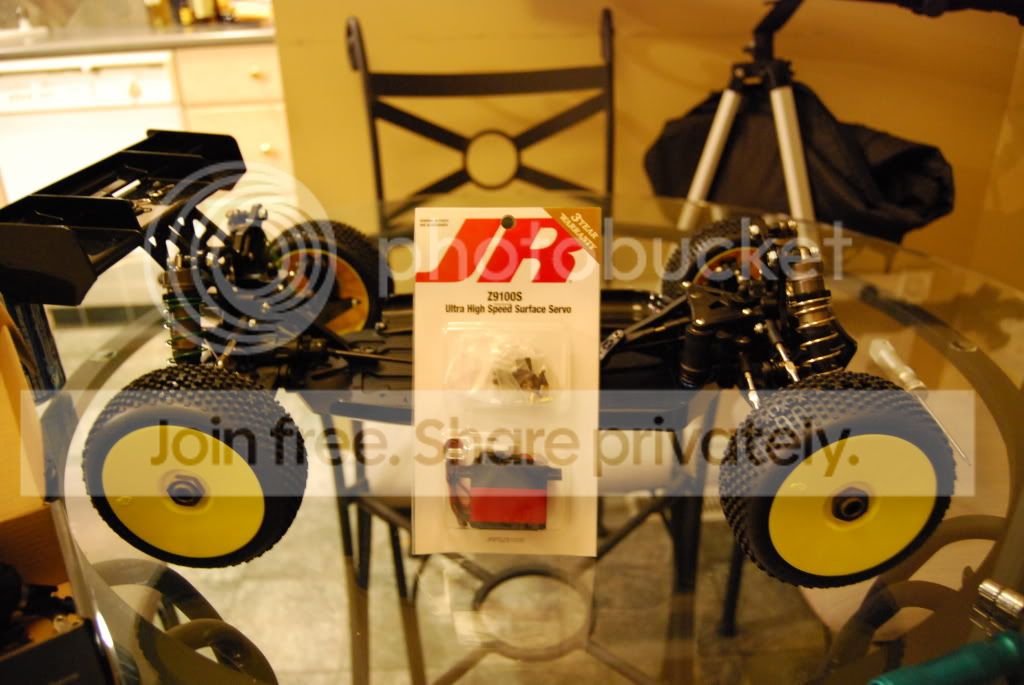

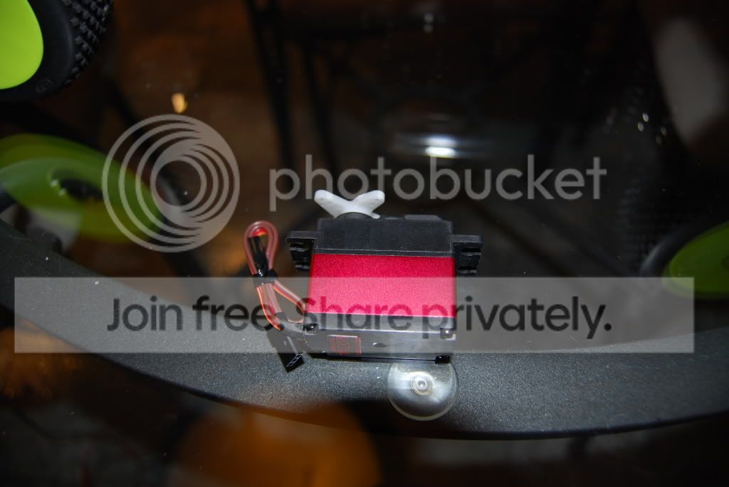

Today I was able to pick up my steering servo for my unit. Its a JR Z9100S Ultra High Speed Servo. Specs are as follows, Torque 180oz/in @ 6V and Speed 0.06 sec @ 6V. I heard some good reviews about the servo, and the fact that it has a 3 year warranty no questions ask is a bonus.
Thats all as of now, will be updated as soon as more stuff gets done.
wow how much is that servo? looks expensive lol nice buggy, i wish i had enough money to have an 8ight
I was able to get the servo it self for $130 CAN. It was the most expensive servo I have ever bought so we will see if it was worth it. I know alot of people who swear buy these so we will see. The biggest reason I bought the servo was because I average about 1 year on a servo, so if I get three years out of it I have saved money going this route.

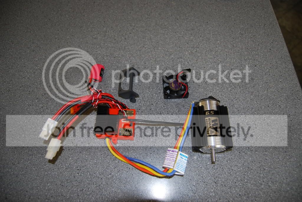

Today I went out and bought the motor and ESC that will be going in. Its a Novak HV6.5 Brushless System. Here are some pictures. The ESC comes with Tamiya plug on it, but I will be changing them out to Deans. I will also wire up the ESC so there is only one battery feed coming off and not two. Novak gives instructions on how to do this.
That motor will be a good choice for the buggy. You many have said this already but what battery's are you going to run in this thing?
Also, you will have to let us know how difficult the programing is on it.
Looks fun and can't wait to see the rest of the build.
I will be running a trackpower 4s LiPo. If the programming is anything like the 1/18 novak mongoose then the programming should be fairly simple.

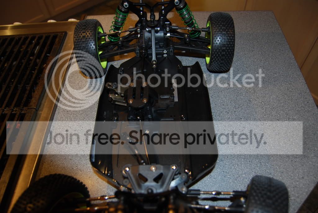

I took some pics of mine last night. Motor mount as I said is done. Battery tray will need to be secured once I know where the best place for it is balance wise.

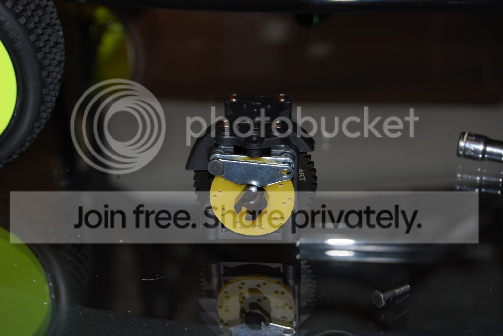

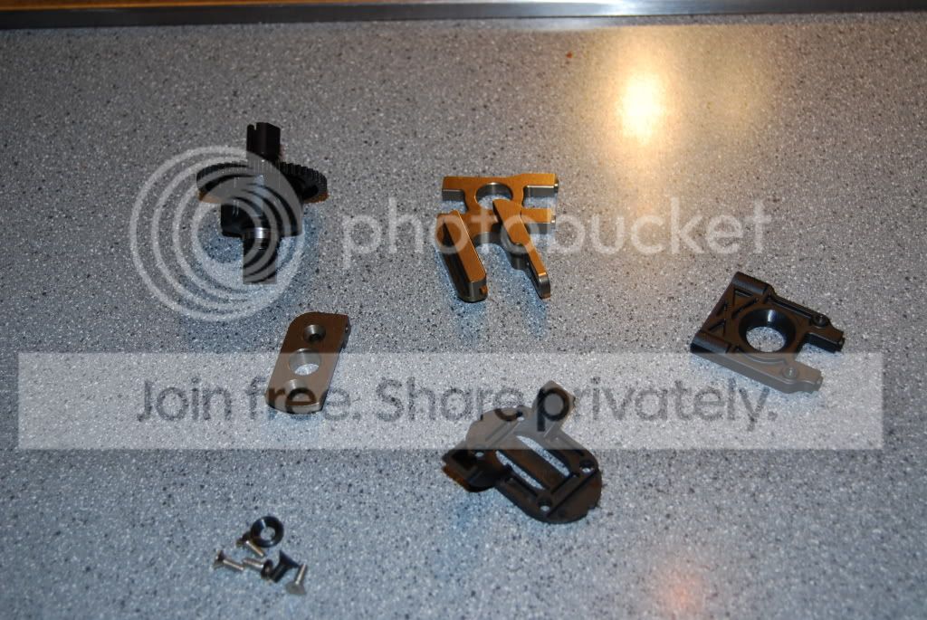

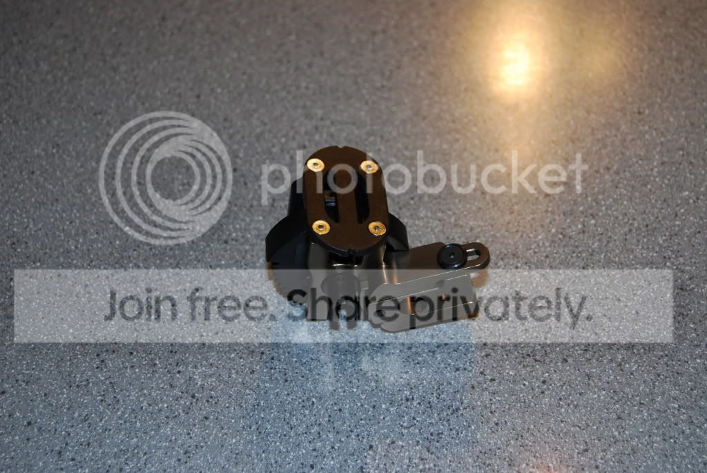

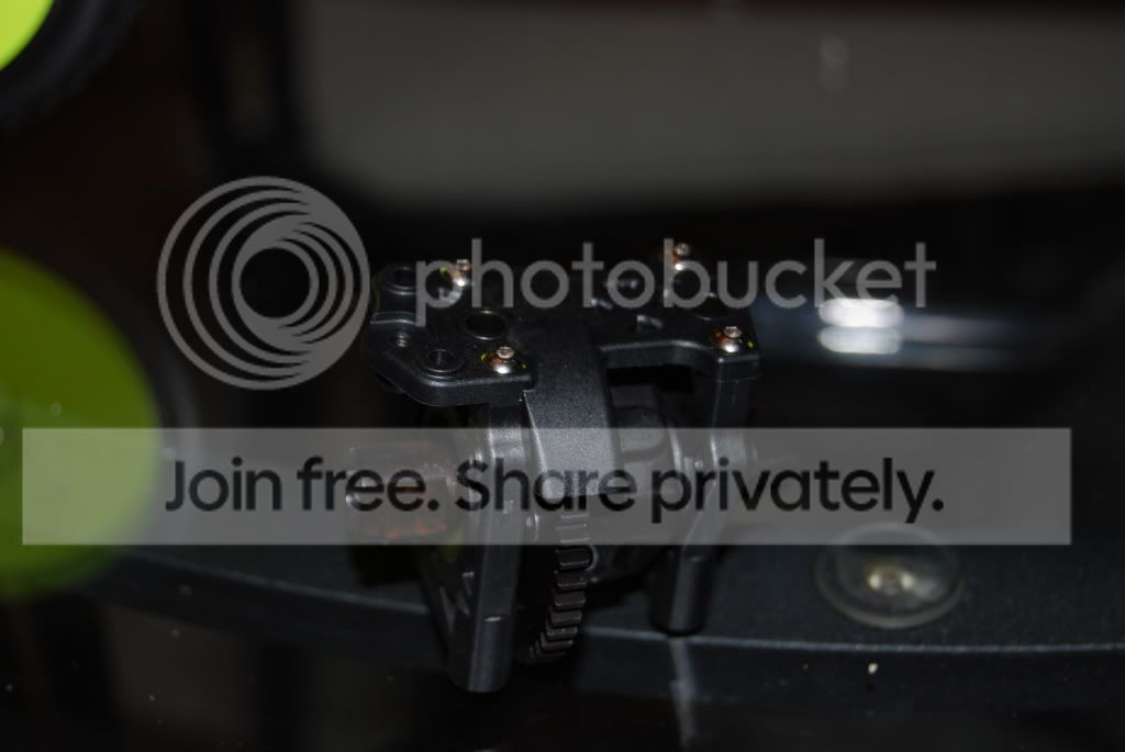

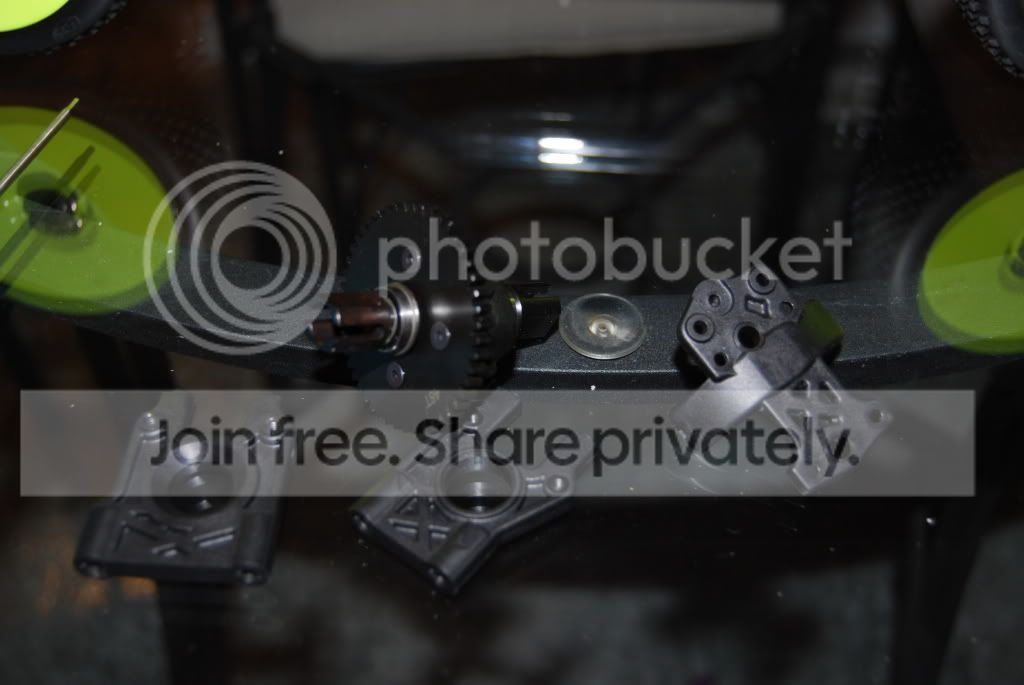

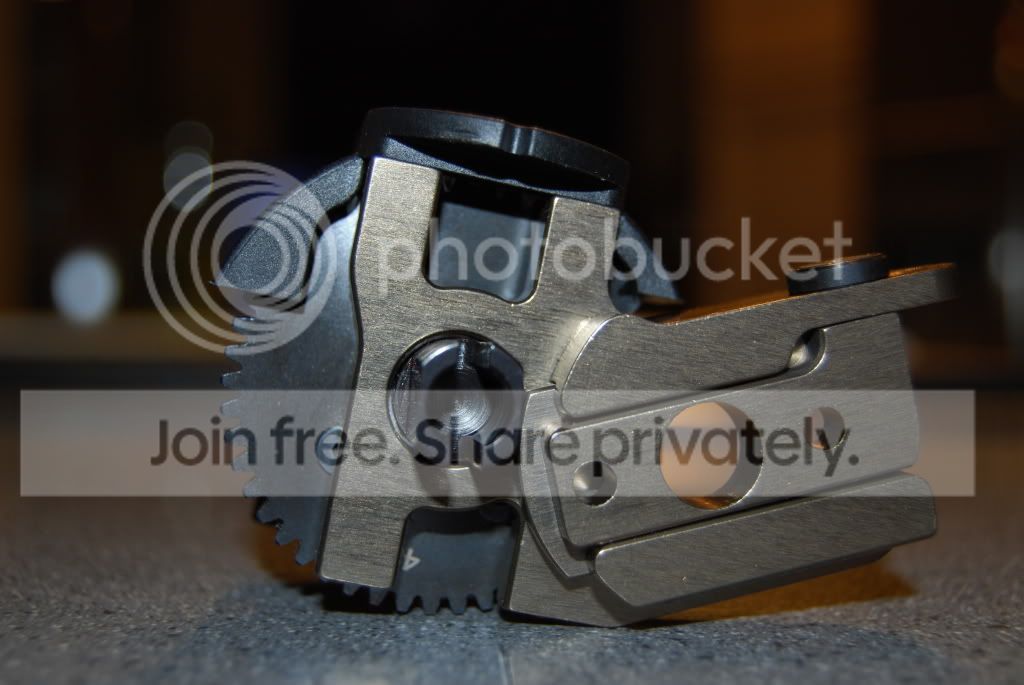

With the conversion kit you have to rebuild the center diff case. The new rebuild puts the engine mount on the side on the diff case.
Now the center diff is put back into the car. I forgot to get a picture, but the conversion kit shimmed up the diff a little bit, by putting a cover to get rid of the holes that the nitro's needed for the flywheel etc.

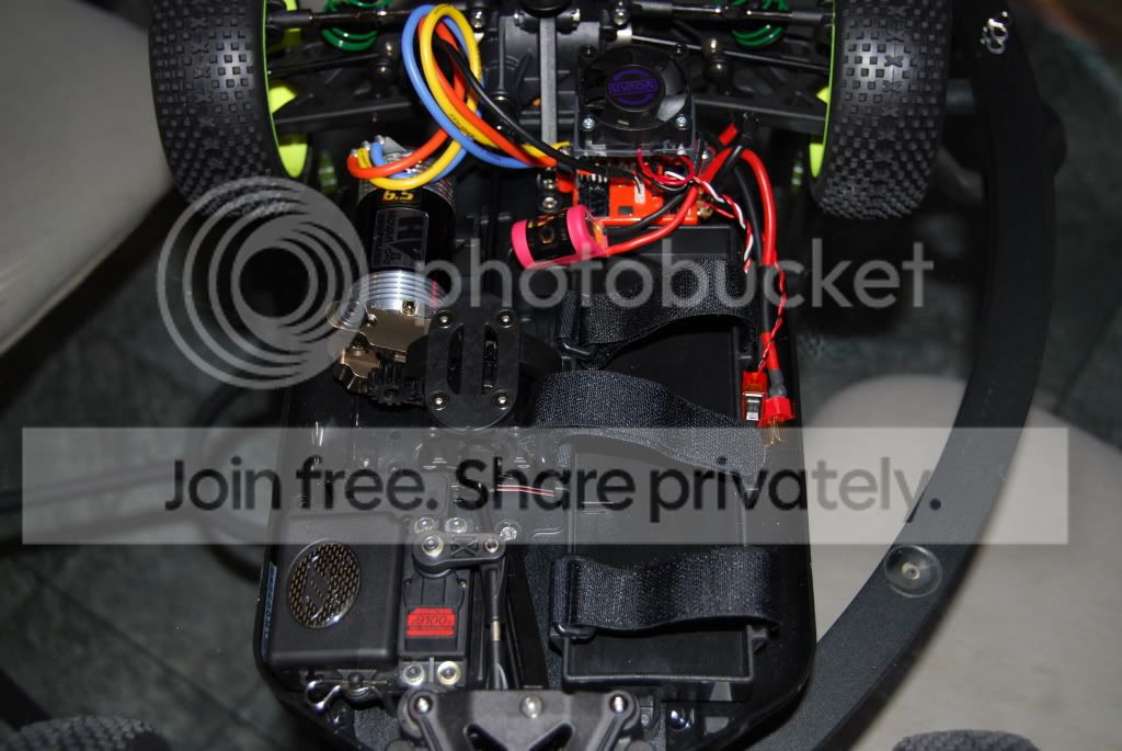

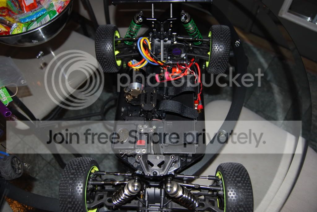

Next step I did was mount the battery tray and ESC tray. The battery and ESC try are all one piece. I don't know how much I like the three strap design. I most likely well end up putting a large strap going length wise. The reason why I would do this is because if I have to pit in a race, it should take less time to get the battery out. And I was done this, I put the motor and esc into place. I did have to take off the heat sink on the motor because the fins were just barely touching the rear dog bone. Depending on the temps on the first time out running will determine if I will mod the heat sink to make it fit. I still have to tie strap the wires to make sure they don't hit anything but you get the idea.
Overall is was a pretty simple build, and the conversion kit Losi has out for the 8ight and 8ight-T work great. For those who didn't know, the 8ight-T will accept this same conversion.
