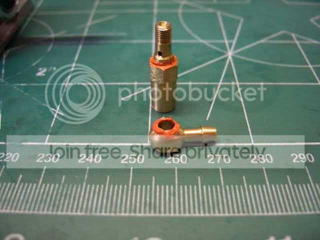

While i was sealing this part i notice that there is a hole (the tall one) do that hole have to match up with the part that the fuel line connects to?

As far as the hole in the HSN, it doesn't have to line up. See how the needle necks down before that hole? It lets the fuel flow all the way around inside the fitting.
