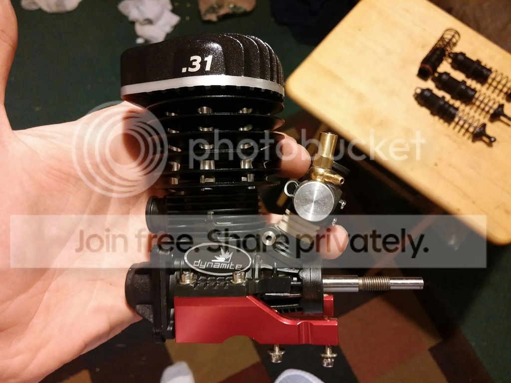

The star of the show the dynamite .31 ahhhh what a beauty

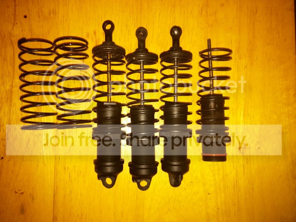

Some losi lst xxl shocks I picked up used and broken. I need to rebuild these.

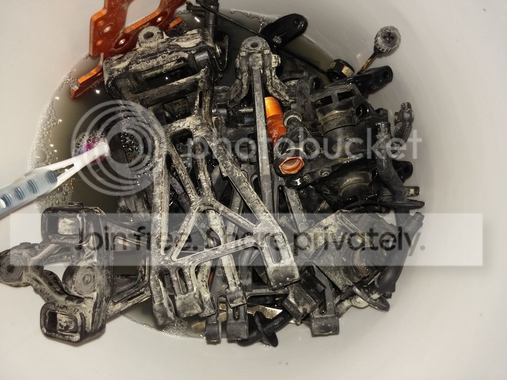

Next we have, all the plastic bits soaking in some soapy water. (Dawn)

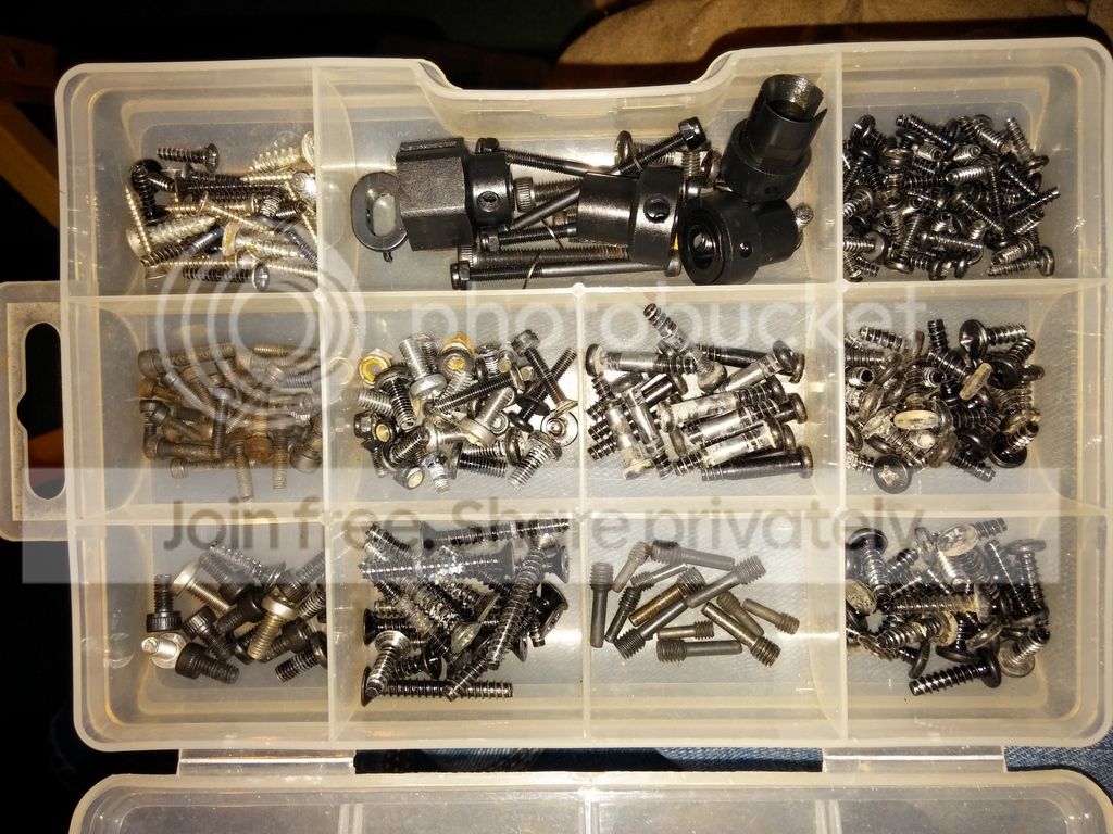

Then all the screws n those bits

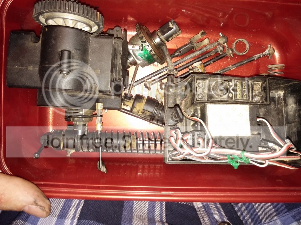

The transmission, electronics and metal bits I didn't want in water.

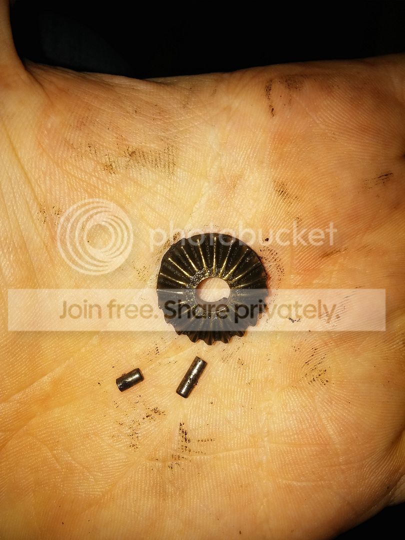

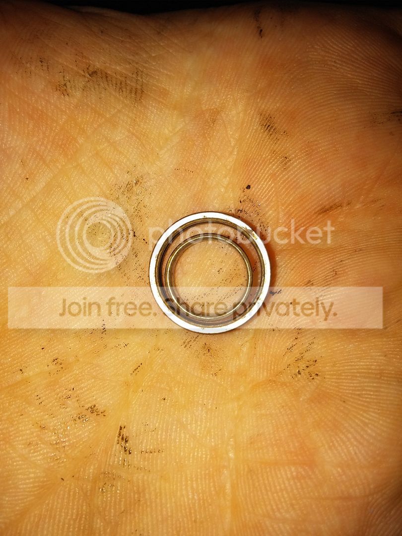

During the dismantling process i found the reason for the rear end grinding

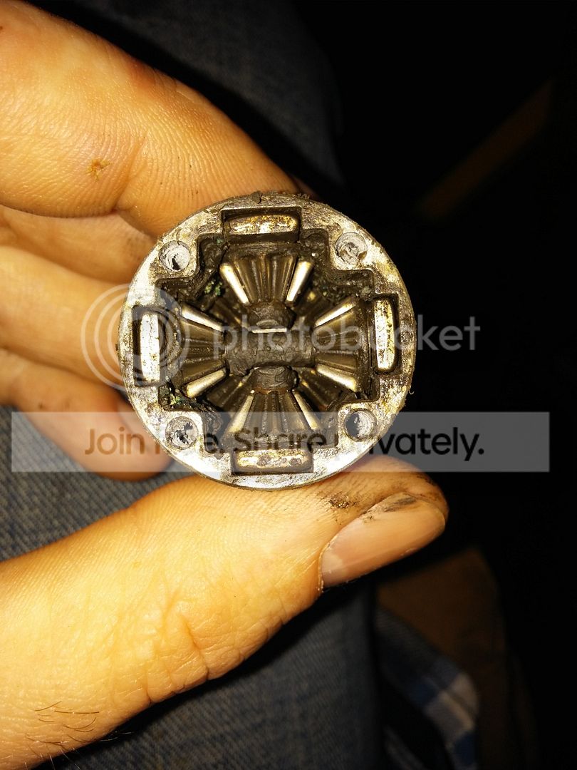

That's a bearing!! LoL And while I was looking, the diff seemed a little loose so I took it apart to find it almost dry inside, with a damaged pin!! Oh!! The neglect!! Forgive me!!
So the first steps are to get all the plastic parts cleaned and dried, rebuild the diffs, get a complete set of bearings for her and wait for the other parts to arrive.

Ok!!! Got all the plastic bits cleaned. That was a total pain. It took more effort than i thought To get the plastic back to it's original black color.

I do have a question about the flm stuffs. The TVPs are thicker, so am I going to need longer screws?

You don't NEED longer screws for the FLM. That said, the stock screws suck, most are coarse threaded, and all are weak.
Nice, I've been thinking of this myself! Glad to see you documenting it.
Any recommendations on a better screw set?
Back in the day, I used an RC Raven kit, it was pretty complete.
Lately, I used the guide Woody has posted here on the forum and McMaster-Carr to order a ton of 12.9 black oxide hex heads.
It's hard to go wrong with any replacement really.

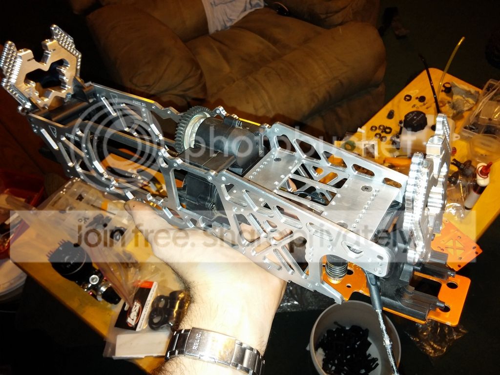

Ok i got a few things done. I shimmed the diffs and the bevel gears. Then i partially assembled the chassis to see what obstacles lay in my path. The first thing i notice is, to put the gas tank where i want it (where the stock electronics box was) and to get the has tank lots enough in going to have to get creative with the servo locations. I really want to keep reverse so this is going to be interesting.
2nd thing... and i kinda assumed this. I'm going to have to completely fabricate an engine mount. Hmmmmmm.......

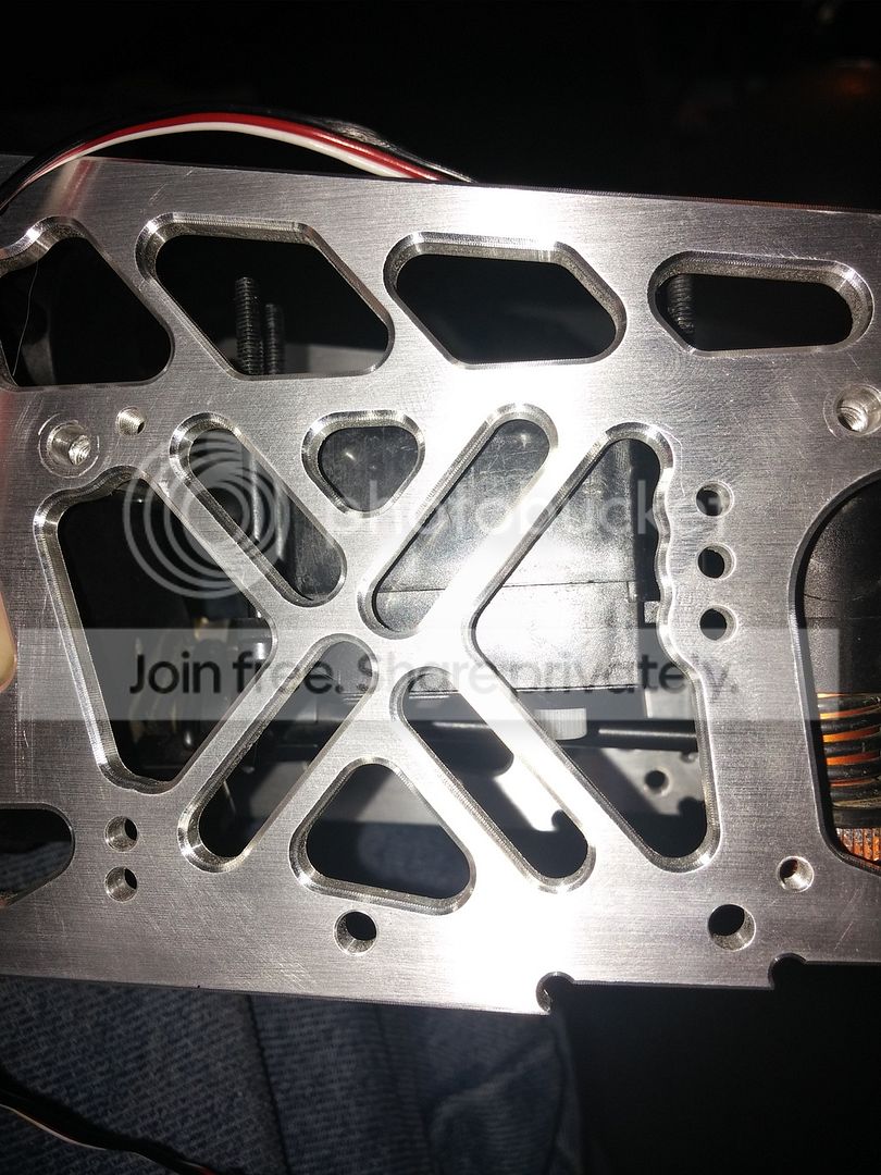

Are you using the Fastlane servo plate with your TVP's? If so, it allows all three servo's to be mounted, with a tank on top.
I'm assuming... The Dynamite doesn't have the standard Big Block bolt pattern? SO it won't bolt to the Stock mount? If so, what about using the Dynamite mount? Then it's just a matter of marking and drilling holes right?
I am using the fml servo plate. problem is, i want to use the savage octane fuel tank. If i mount the servos on the plate where they should be the gas tank will be sitting way to high for my liking. I want the tank during just above the servo plate. So I'm going to move the servos. just need to figure out how.
The issue with the engine is its longer by about a half inch, giver or take.
Long, as in the ridiculously long crank is sticking forward and hitting the spur? Have you put a clutch on it and determined where your clutchbell will land? Because you can trim the crank end down.
Yea, i put the clutch bell on it. I'm possibly going to order a savage flux plate and modify it. The other problem with the fit, is the fly wheel is so big it actually lower that the engine mount and prevents the engine from sitting flat. Looks like I'll need to figure that in as well

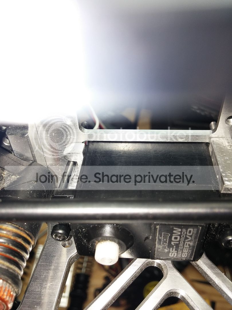

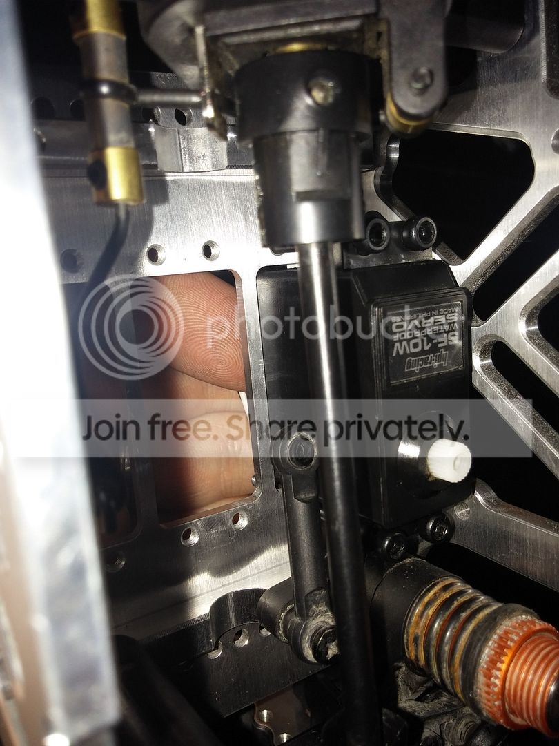

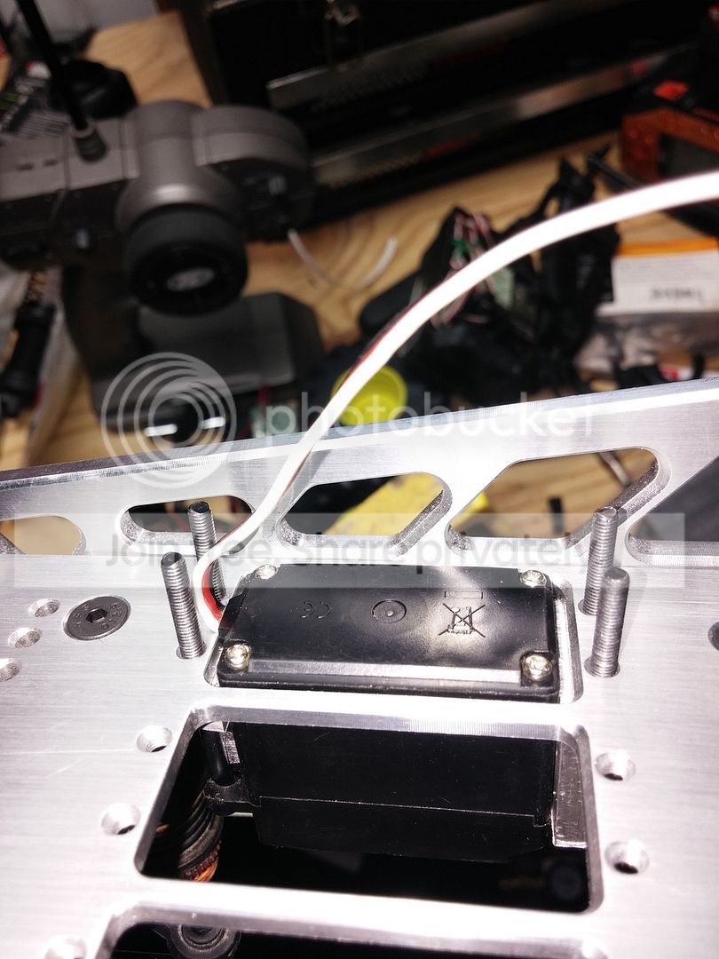

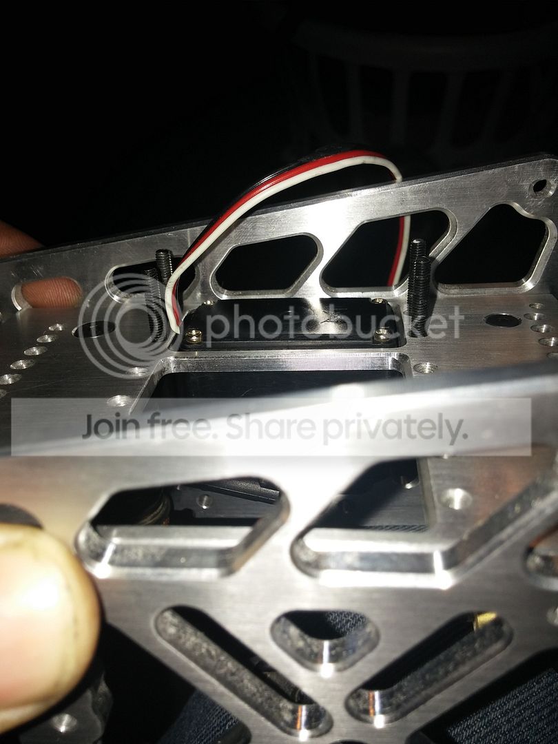

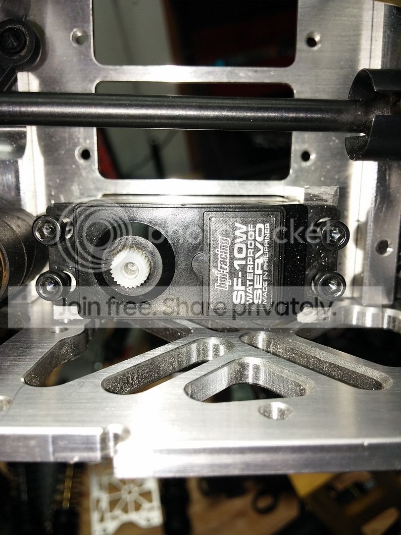

Did some tinkering today. I figured out how I'm going to mount the servos, keep reverse and have the gas tank low enough.
This is just a mock mounting i did too make sure I'll have enough room.
So, I'll have a servo on each side, one for steering one for the reverse. And ill mount the throttle/brake servo towards the rear of the truck.

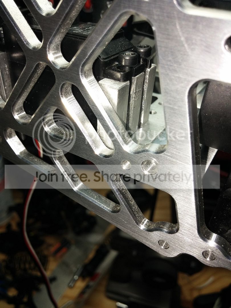

Update!!!!
i got the servo mounts started. (This isn't the servo I'm using for the steering I'm still waiting on that one to show up). I still need to make a set for the other side. I made them out of some little aluminium blocks. Cut in some notches. And boom done.
That actually makes sense, can you notch the plate and let it ride in the notch?
