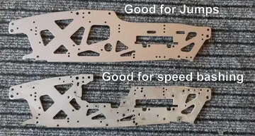

Yesterday was in a hurry and completely forgot some stuff: getting the XL chassis is probably needed, I'm not sure if the chassis you have will handle the jumps, and also there's the dogbone size situation... You have a few options, Alza sells a good one, the V2 XL Flux one, and the GTXL-1 option, I have the GTXL-1 chassis, Jennys sells it for 20$, but originally the right plate is different from the left one, one is stronger than the other, so you need to buy two sets of chassis to make things work, the plus side is you keep two plates to do another built if you want.
GTXL-1 chassis:

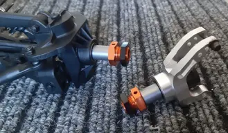

The HPI-160141 Savage XL 17mm Hex Hub Conversion Set with aluminum rear hub:
