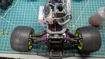

I'm using an inline tuned exhaust system #0702, with the manifold from STS for the savage. It's held together with springs rather than a silicone coupler (that always worked perfectly well back in the day I might add).

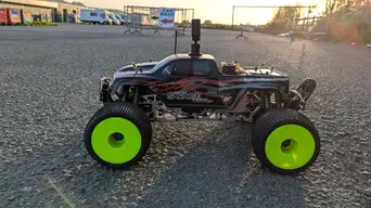

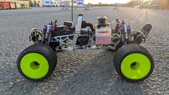

You've done a great job - I love the blue and fluorescent yellow combo!
I highly recommend you make one small modification:
Put a bend in the brake lever that operates the brake cam - as per the orange line - so that your servo has optimal mechanical advantage at the point the cam is pressing against the brake pads. It increases braking force significantly.
You achieve greater leverage with your servo. See this exaggerated image - it's probably the best way to explain why.
