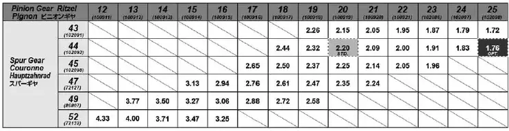

I bought a new Hpi 16t pinion but the motor wont move in far enough to set the mesh tight enough?
Hi,
I checked the HP manual.
The lowest pinion that can be used with the 44T stock spur is 18T. For using 16T you will have to use 47T spur. This is because of the brackets limited movement.

I am using 15T pinion with 43T spur (twin slipper clutch) in my larger size Savage but do not have the twin bracket type motor mount:
Inverting the brackets will allow the motor to get closer to the spur but the outside brackets ends will get into the battery box (so you would have to extend the battery mounts by using longer screws...). That´s much more work than fitting a 47T spur.
