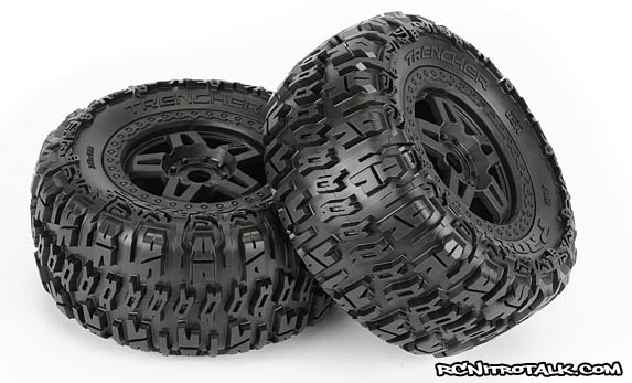

Hi. I'm using in my savage with gearing (44/25) and battery 2x3S
I have two wheel pair... an ON-ROAD wheel and another OFF-ROAD (Trencher)
I'm having a problem, it is the third time my DEANS connector melts a bit and lose the connection. This occour just using the OFF-ROAD Trencher proline. With on-road tires have no problem.
Changing to bullet connector solve this problem? Or 44/25 with trencher is to high for esc/wires/deans? If I change the connectors, my esc can burn? It has temperature protection?
THANKS!
are you running on the same surface?? because that will make a huge difference as to load....
I doubt if a bullet connector is much tougher than a deans style...
That connector needs to be changed for sure, are you proficient with a soldering iron?? possibly switching to a slightly better connector like maybe an ec3 or something.....
On-road 90% on road/asfalt... off-road on sand/clay
