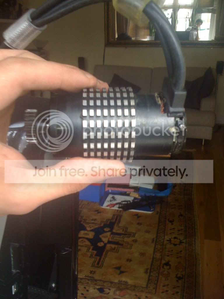

... but the main damage is that the motor has cracked and it looks like all the internals have been slammed forward and forced its way out of the case!!!
I am in the process of ripping it apart again and seeing the extent of the damage!

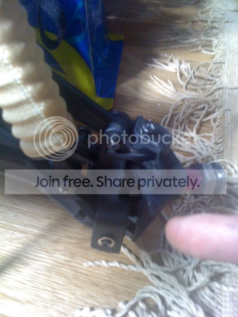

- Motor Broken
- Tie rods all broken
- Front metal plate (under plastic skid plate) has bent upwards.
- A arm hinge pins all broken
- 2 LiPo batteries destroyed
- One upright is broken (Tie rod ripped off the point is was connected too)

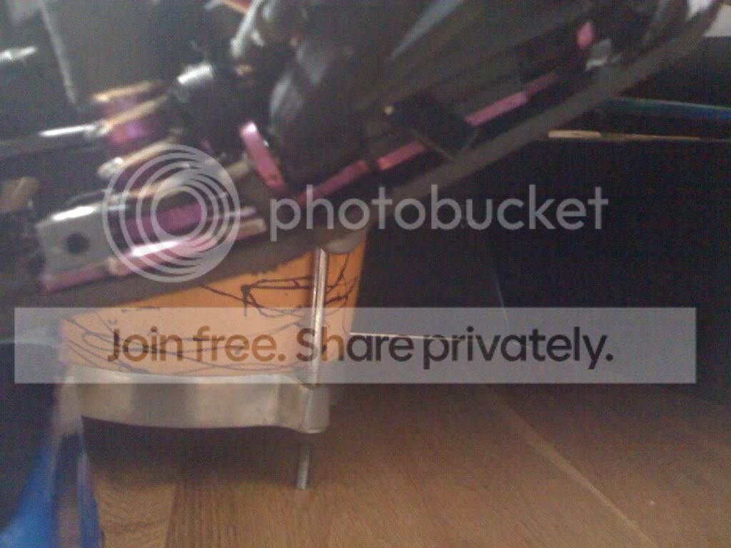

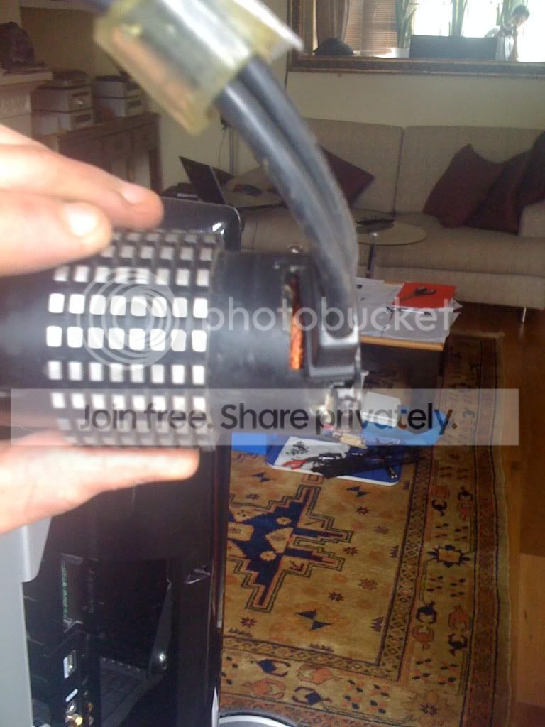

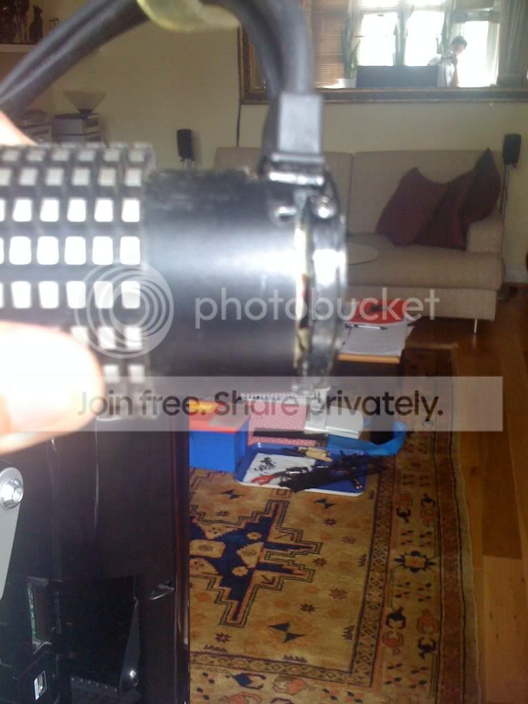

PICS OF THE CARNAGE:
motor destroyed...
Some minor plastic bits
Metal base plate and all a arm pins bent...
ARGHHH HELP! just got this baby together and now its all apart again!

I would call Castle and talk to Jenny in repairs and see what she can do for you. That is a Castle 2200 so I am sure it wouldn't be a problem. I would stay with the 2200 imo.

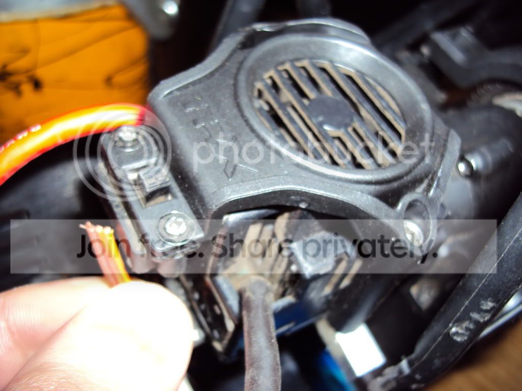

I also found out that i cant test my ESC because the wiring has been split! What should i do about this?
Would i have to resolder new wiring on it???

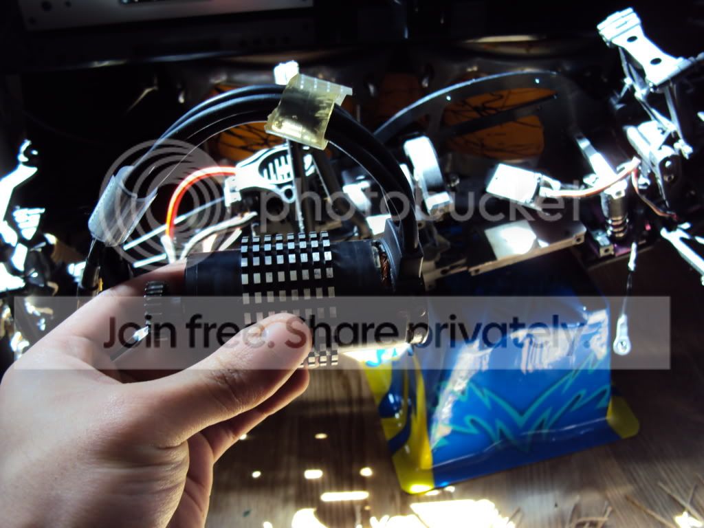

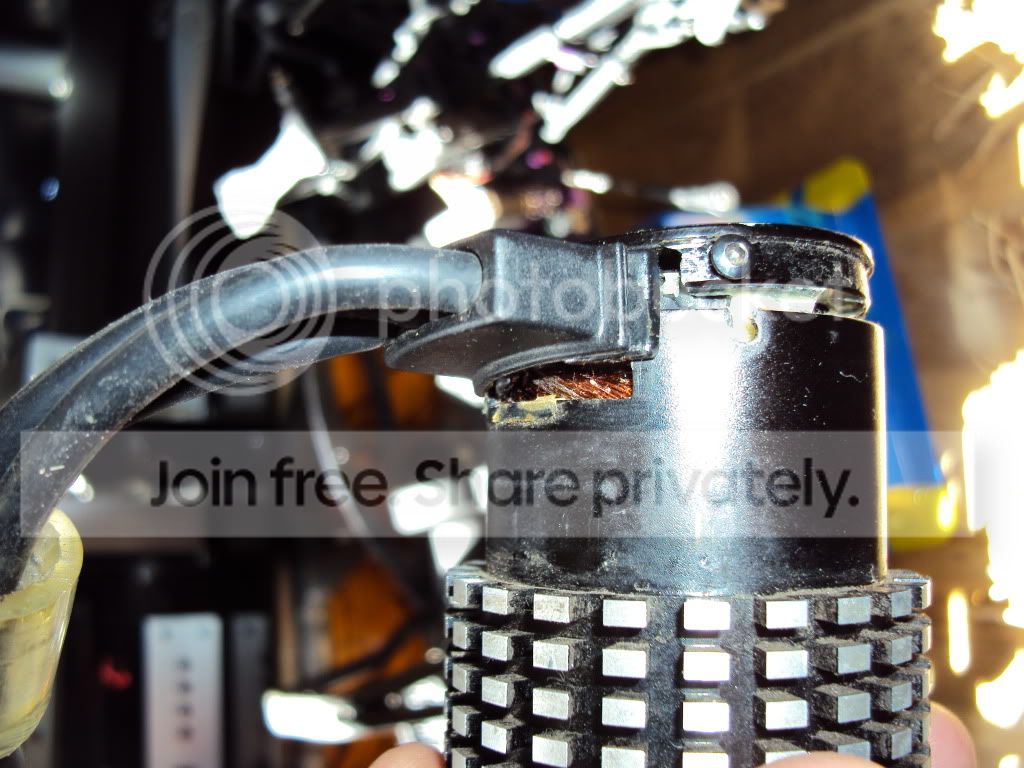

some clearer images

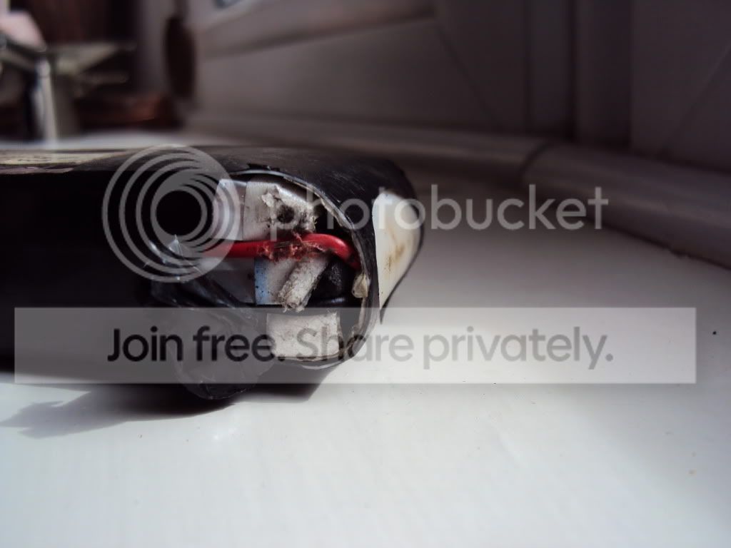

Also... this battery got flung out and scrapped along the road... Is it repairable? could i just cover the wire with tape properly?

id just get another tork 2200 honestly, its a good motor and it fits in the motor mounts. most other motors you will have problems with that.

you can resolder those wires for the esc. just make sure you connect the same colors together. and like i sad, get another tork 2200
You could redo that pack but I would take it fully apart and inspect everything first.
and be VERY careful. lipos are no joke. that sucks to see thats a lot of money. i agree with Bad, go with the tork, they are good motors, and your mounts are designed for it.
I think i will just go with the tork then...
I will take the battery apart and see if its ok... Should be fine i hope.
Does anyone know where i can get new wiring with the Receiver attachment to it so i can re solder the esc wiring?
how bad is the other side of the wiring that was cut off? you should be able to just strip the wire back put shrink tube on then twist the 2 ends together and solder. then take the shrink tube, pull it over the exposed wire and use a lighter shrink it....
its not bad... its possible to reconnect them... but i want an extended wire as i have a new idea of mounting the receiver and its a little too far from the esc.... What extended wiring would people get or where do i even buy them from? never something i have really looked for...
use a jr servo exstension once it is soldered. they come anywhere between 3" and 18" and are $5 or so. Avalible at almost all lhs
