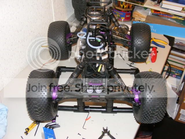

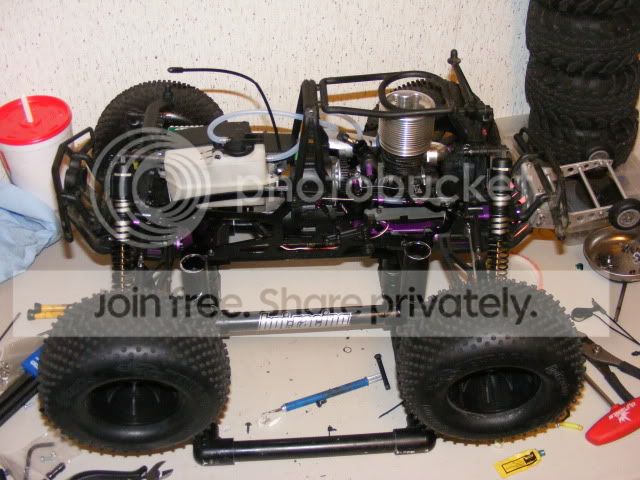

Just thought I would post a few pics to show that the forum mascot's parts have found a new home. I just installed the mid-tank and throttle setup that Soulja put together into my Savage yesterday. Just got to find some time once this weather breaks to get out and do some test runs with it. Oh, and the XL tires are from Soulja as well. I really think they make the truck look meaner.
Ignore the mess, really did not feel like cleaning up after I got done.

Finally, took the truck out to run tonight. It seems to respond well, just got to work on my brakes as I had very little to slow the truck down. Going to have to go down to my GT tires as the XLs are a bit large for my gearing. It seemed the clutches would not pull at low speeds but once I got up to 3/4 or above the truck picked up, but was still straining a bit to go through the gears. Might look into some new clutch shoes to see if that helps out some.

naw dude.....the shoes are fine......it's all in the gear. you might have to move to a 16 or 17/52. 16/52 will cure the problem if you want to run those tires.
ryu, i forgot to ask (and forgive me if you already posted ) but what tvps you got?
I'm diggin the the black tvps, gives it an evil look!
They are the LCG plates the HPI had put out. I think HPI has discontinued them. I love them, it does give the truck a very mean look.
