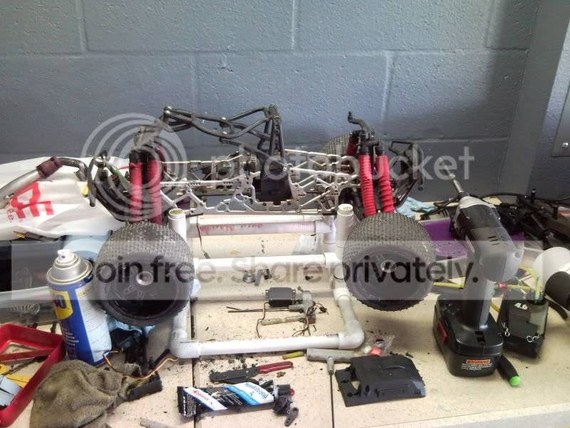

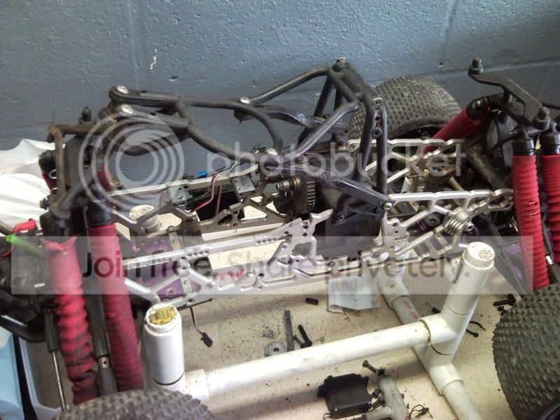

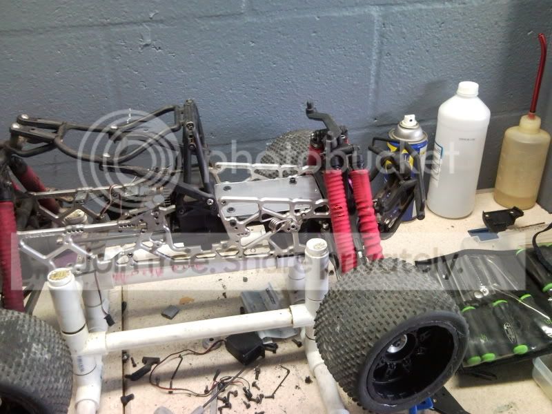

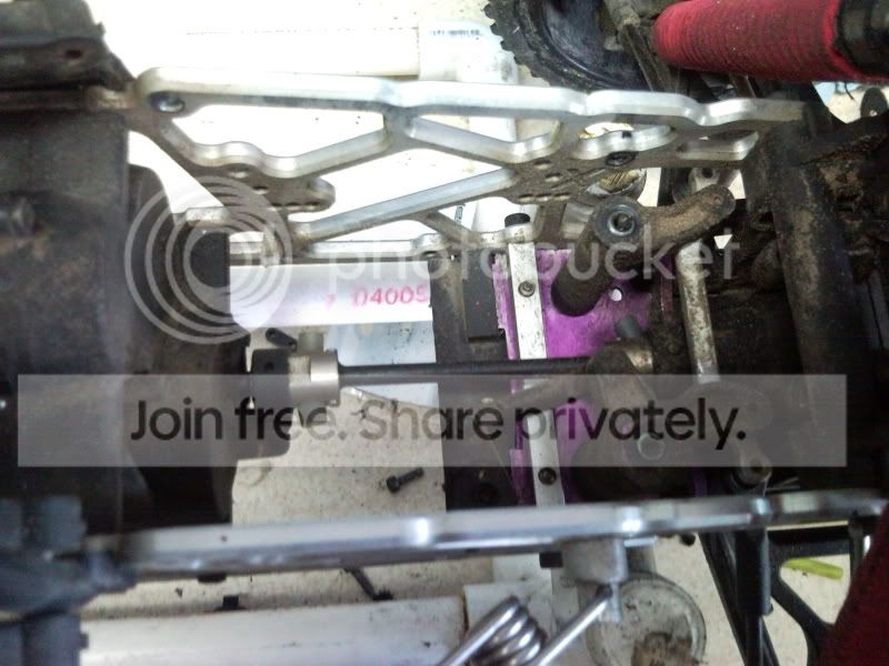

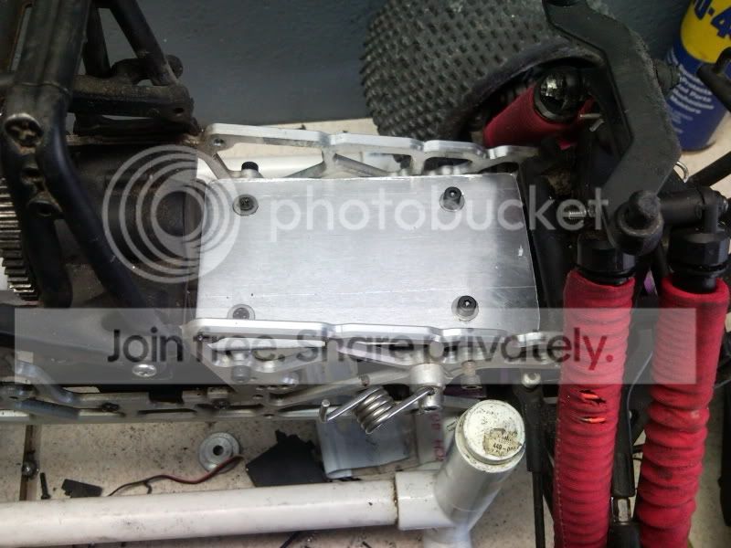

Well I have officaly gotten tired of the shorter runtimes of the ofna tank. Now I am going big. Ofna 250cc tank. I know there is plenty of people who sells parts to the build, and I know they have quality stuff, but wheres the fun of the build when its all done for you? I basicly am trying to build this using mostly parts laying around my garage. only having to order what I cant make.
here is a list of what I am doing
Throttle Servo mounts using old motor mounts
FLM cross braces, left over from my flm build
sheet of alum I got for $5
Ofna 250cc tank
RPM Radio box
Rc10 servo mounts
Here are the pics of some of the dissasembly and fitment tests
