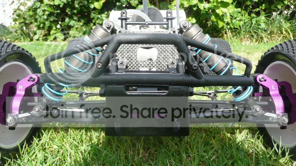

i am wondering which differentials you are running?
also, have you found a sway-bar that is a direct fit or are yours a
custom-bend?

I'm running flux diffs and the sway bars are a custom bend i made up 5 sets 2.00, 2.25, 2.50, 2.75, 3.0 piano wire bent to shape and i use the 2.25 front & 2.75 rear's, glad you like the video guys and the brushless one will follow to and the basher soon enough lol

here is the 16mm jammin big bore shocks fitted also :

Did u make the custom sizes on the losi shocks, or did u get some one to make them for u???
I really like the losi shocks, but with the shocks being so big, I didnt get them. Until I saw ur vid here.
If its ok with u, can u tell me what I gotta do to get the losi shocks that way, and what size (in mm) the front and rear are plz and thx???
