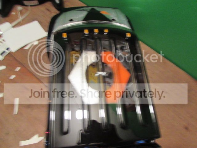

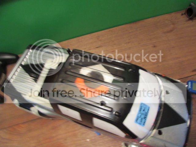

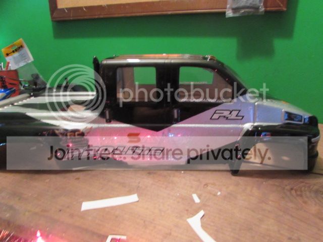

so, as jam brought up earlier, I forgot to post pics of my body. I tried to paint it, but the latex in the paint clogged my airbrush. so, I un clogged it. then it did it again what am I doing wrong? I'm using standard paint thinner. u can see the pattern it made when it clogged. IMG_1689.webp IMG_1686.webp

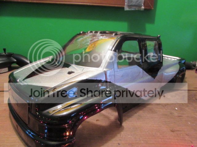

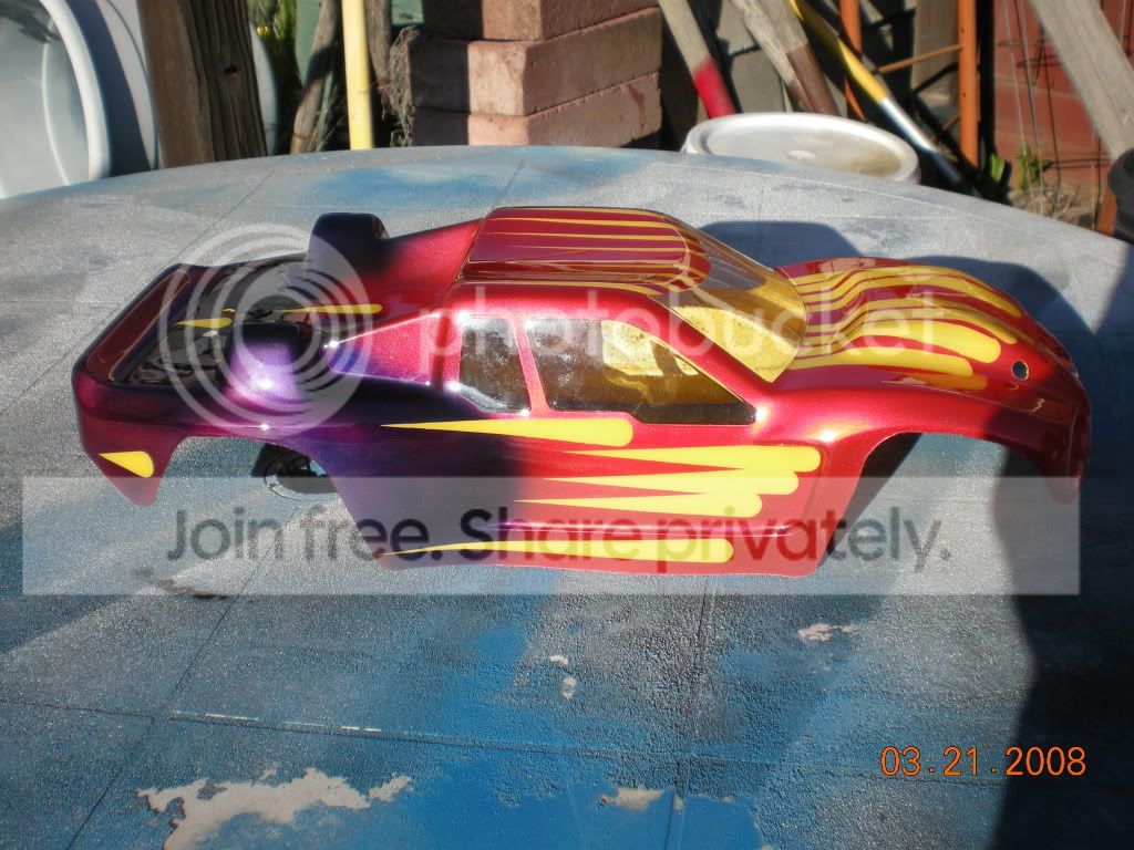

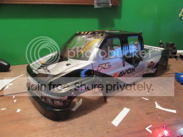

"spray paint lines" ?? are you referring to a fade from one color to another ? if so it is pretty easy to do, this one goes from black to purple

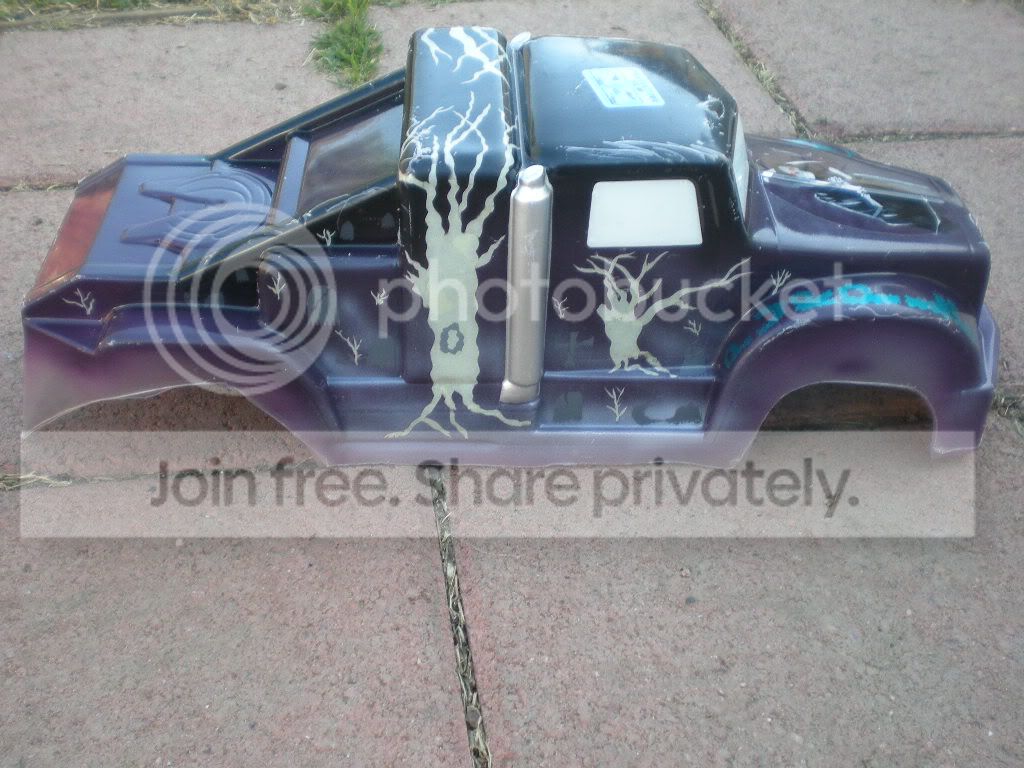

this one is from red to purple, funny tho I used no purple paint at all. I based all the purple with a blue candy and sprayed the red over it. turned out kinda cool....
Painting fades is always a change up and fun to do.....

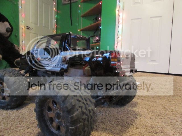

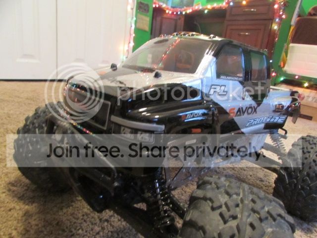

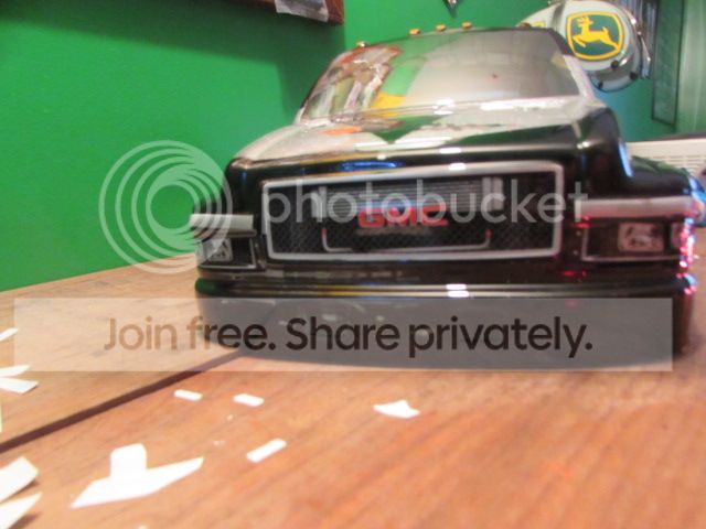

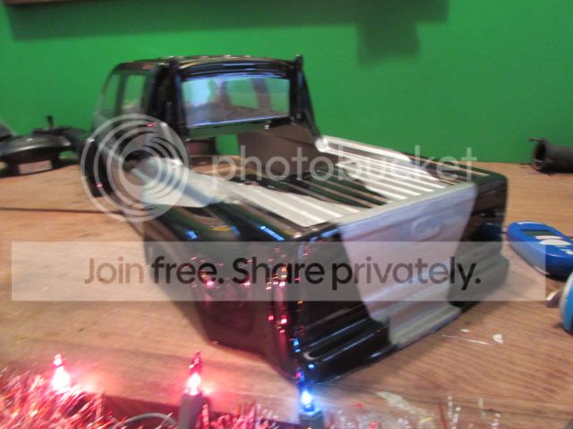

Nicely done nut. If you haven't seen a GMC Topkick in person then you need to. These things are a BEAST of a "truck". A commercial truck with a standard truck bed and interior. Pretty dang sweet trucks.
