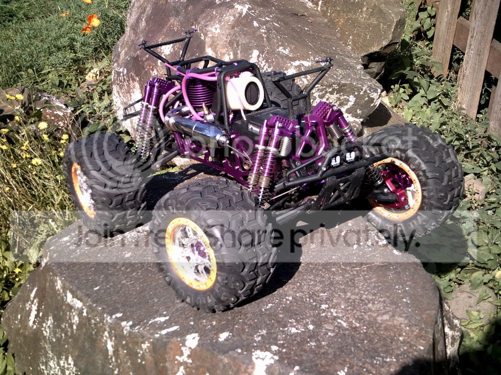

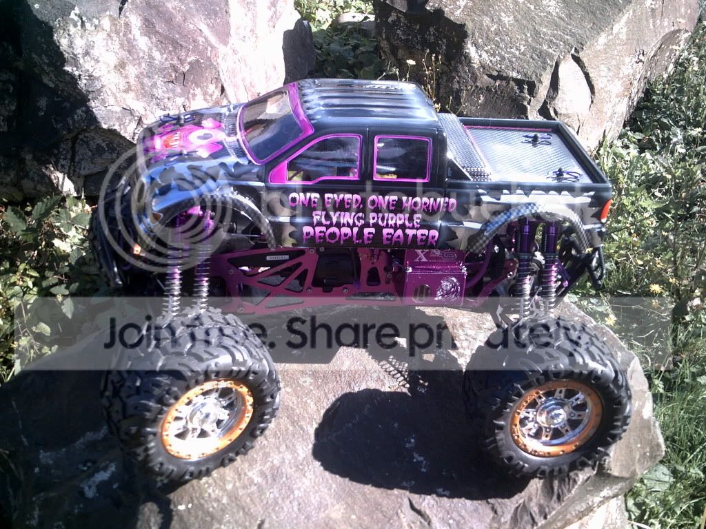

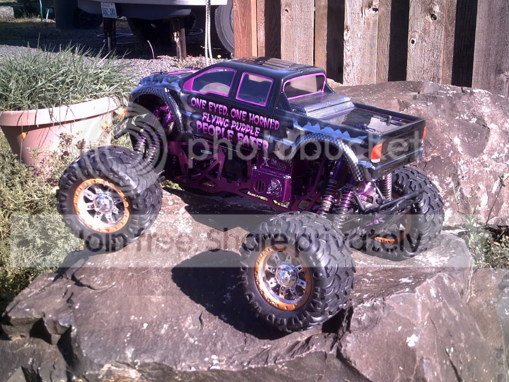

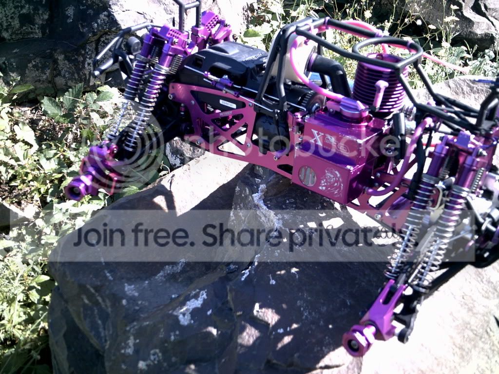

This has been a fun project and I think everyone will like:).

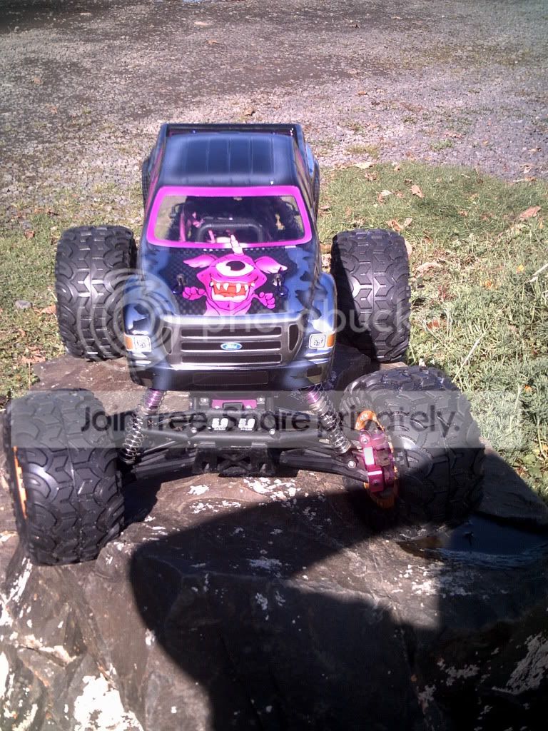

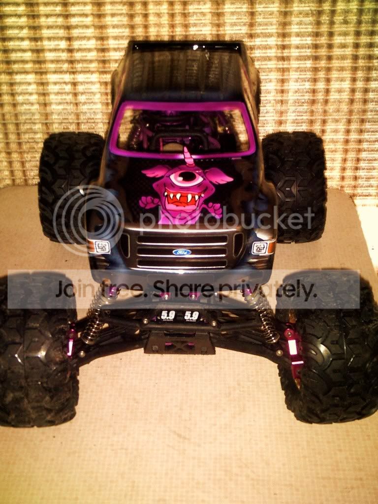

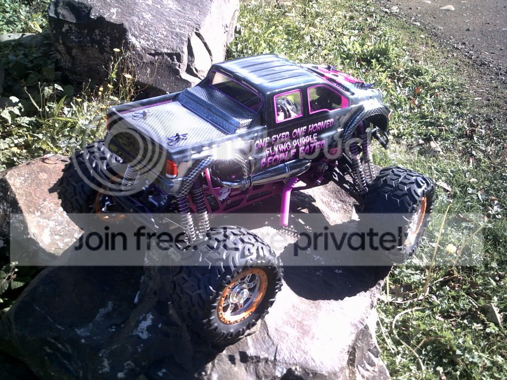

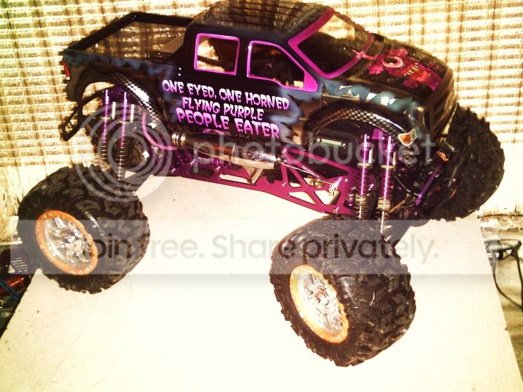

It's a Show/Basher Savage XL.
OK Here is the parts list.. I am just ganna copy and past from the invoices to make it easer for me.
Savage Hop Up! Brake/throttle linkage upgrade
DE Racing Tank Pull Kit PURPLE
HPI 308 Savage X Battery Level Indicator
SAVAGE XL 6 VOLT HUMP BATTERY & CHARGER
SAVAGE XL BATTERY / RECEIVER BOX
Airtronics M11X
GH 02058P ALUMINUM STEERING BLOCKS/C-HUBS
INTEGY C22388 23 mm WHEEL HUB HEX ADAPTER
RRP 7246 HARDENED/HARD STEEL 46-T SPUR GEAR
OFNA 51232 PICCO P3 .28 TRUGGY BLOCK 9 PORT ENGINE
Cheyenne Narrow Bead-Loc 40 Series Wheels
PRO-LINE 1117-00 MOAB 40 SERIES TIRES
LOSI LOSB7203 SAND WEDGE TIRES
LOSI LOSB7204 SAND RAZOR TIRES
iNTEGY 4mm Chassis Plate(2) - Savage XL
Dynamite Throttle Return Springs
HPI SAVAGE XL 5.9 Dogbones Center Heavy Duty
HPI SAVAGE X Front Rear Sway Bar Set 102538
HPI SAVAGE XL 5.9 FRONT REAR BUMPERS
GH Aluminum Bulkhead Purple
GH Alum Throttle Mix Arm Set Savage
Golden Horizons Alum Servo Saver Prpl Savage
HPI SAVAGE XL HEAVY DUTY OUTER DOGBONES
HPI SAVAGE XL EXTENDED DRIVE AXLES,SPACERS
1/8th Scale Translucent Purple Heavy Duty Body Clips
Purple/Clear Deluxe In-Line Fuel Filter by IMEX
Integy Purple Anodized Aluminum Shock Tower
XL SAVAGE DRIVE CUPS DIFFERENTIAL JOINT
INTEGY Aluminum MSR5 Piggyback Shocks
Upper Lower Control A Arm Set
Integy HPI Savage XL Purple Alum HD Rear Hub Carrier
Integy Purple Aluminum Spur Gear Adapter
Dynamite 086 Hi-Speed Polished Inline Exhaust Pipe
Motor Saver 3-Stage Off-Road Air Filter
Integy Purple Aluminum Bulkhead Braces
Integy HD Alum Engine Heatsink Plate
Nova Engine Mount
BP Diffs
HPI Super Heavy Duty Diff Shaft Savage XL HPI86248
3 speed tranny with 3 upgrades (high speed 3rd,SV250's upgrade and steel 44 tooth steel 1st gear) Thanks again SV250
Competition Fluorescent purple antenna tube :wink:
HPI Racing Roll Cage Set Savage XL
Integy Steering Knuckle for Savage XL
Werks Racing Adjustable 4-Shoe Monster Clutch
Purple fuel line
Axial fuel filter
RD Logics purple fuel tank

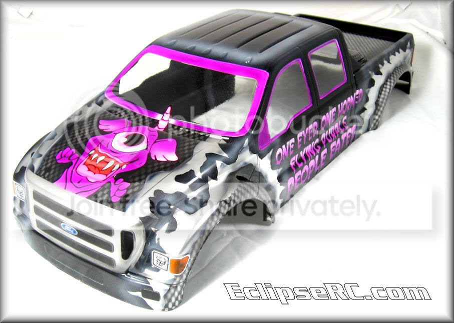

Custom Painted F650 body
Build cost so far is around $2500-$2800
I know I have left out some stuff but that is most of it.
Still a few more things to do to it like 4wheel steering with custom TVPs.
Note: I know some of these parts are not the best but I'm was goin for a certian look. And this truck will NOT BE A SHELF QUEEN..

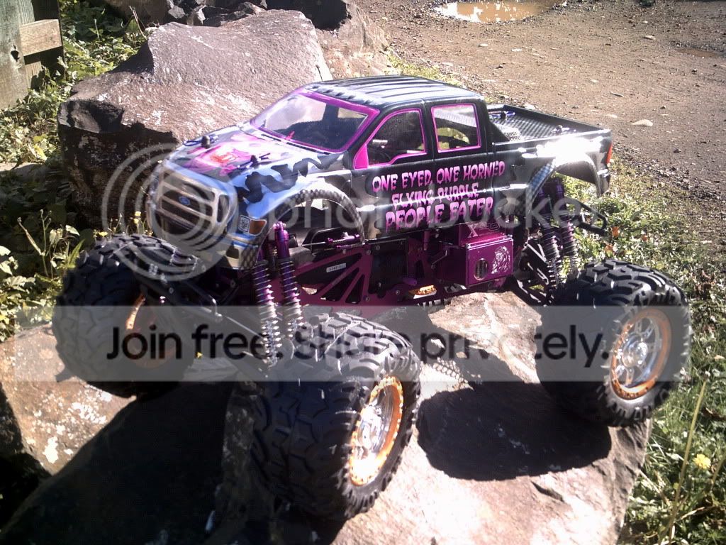

Holy Geez! that is a long list of hop ups.
Proline F-650 body is one of my top 2 favs.
Told you before its not my style of build.. but I gotta respect it 4 sure! Good stuff man ...
its a great looking truck,it shows that alot of work has gone into it!!
Love the body..... haven't sung that song since yr 2 at school... lol

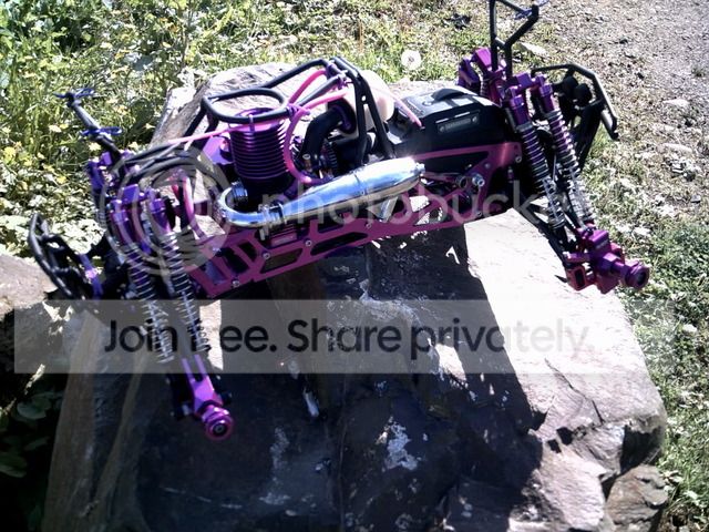

Well after the mock up last night i narrowed it down to 2 ways.
1. I can put the servo under the tank but will have to move the tank up and out a bit. (wich I don't really care for)
2. I will add in a plate above the GH servo saver and mount the servo on it so it sits right next to the bulkhead and have a custom linkage set up thats a little hard for me to explane. This way will let you use a midtank mod if you want but involves alot mor fab (mounting plate and a custom tank mount with linkage mount built in).
With both of these ways you will still need custom tvps so the turnbuckles will have room.
I will be goin with #2.

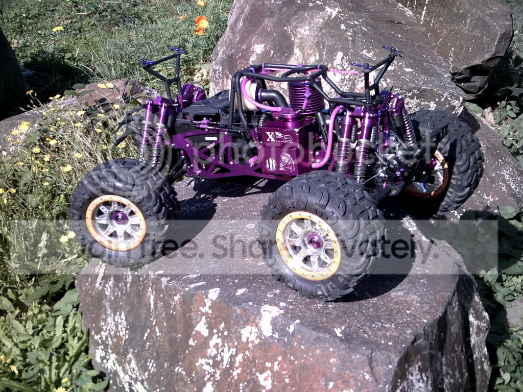

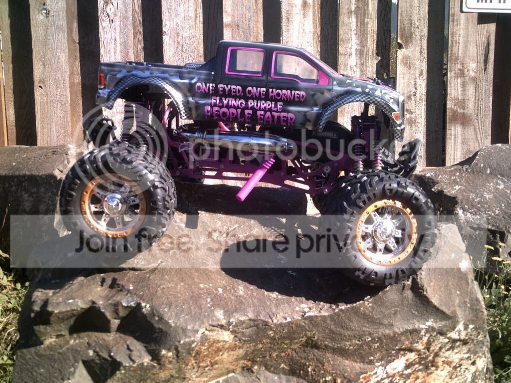

Isn't your piggy back's shocks backwards? Guess it really doesn't matter but like the piggys sticking out the other way looks tuffer
I put them in that way to protect them better.. Yes they do look better the other way but you will end up bending alot of the top bolts not to mention the piggyback will take a beating that way. Norm I wouldnt go with alum shocktowers either but to put them on this way there wasnt anough room for the stock ones to fit.
Also I 99% of the time I run on sand to so its a little more forgiving in bad landings.
