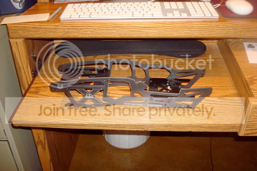

Well some of you guys may have heard me talk bout my up and coming build and well I think I am off to a good start. Here is a list of some stuff I have just ordered and already have.
-Aftershock Shocks
-Kershaw Designs Direct Drive (On the way)
-Carbon fiber arm braces
-XL TVP's (On the way)
-300mm x 100mm 2.5mm carbon fiber (On the way)
-Carbon fiber battery stop (Custom made)
-Integy rear carriers
I think that is it for now. My whole goal with the build is to have the batteries inside the chassis. I plan to put them where a nitro motor would be located.
Also the plan with the carbon fiber is to 1. Make my own mid plate to mount the steering servo and 2. To make a battery plate with it and 3. I might make a wing mount but not sure yet.

sa-weet I.H.T., i been wantin to see someone do it up with the Kershaw gearbox.
also very interested in seeing how this comes together with the batteries inside. can you get the standard packs in there or is there a different type of pack you need.
keep the pics comin, gonna be a lot of eyes on this project. :bobang:
Well you can use pretty much any LiPo as long as it fits width wise cause they are all pretty much the same length right? But with this set up any pack under 140mm should fit

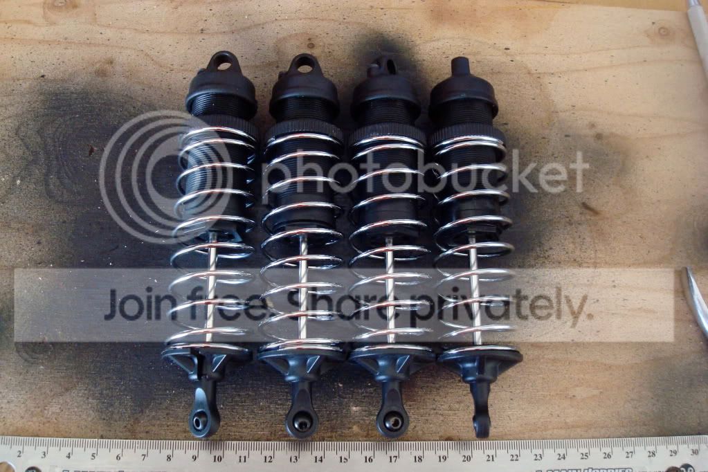

Also I have been thinking and I'm not sure if LST shocks are the way to go... Any one got any suggestions? I wouldn't mind trading for some other shocks if anyone is instrested, maybe some Flux BB's?? Shoot me a pm if ya guys have any offers.
The BB's are the way to go. They work just as well and are just as smooth as the LST's and the BB's are half the weight. However, the aluminum bodied ones are the best way to go, just my $2.
I can't get the aluminum ones though just to much money and I am trying to get the "best bang for your buck" kinda thing I still want good stuff for this build and save money in places were I can and get by so I can spend a little more on ESC and lipos etc.
