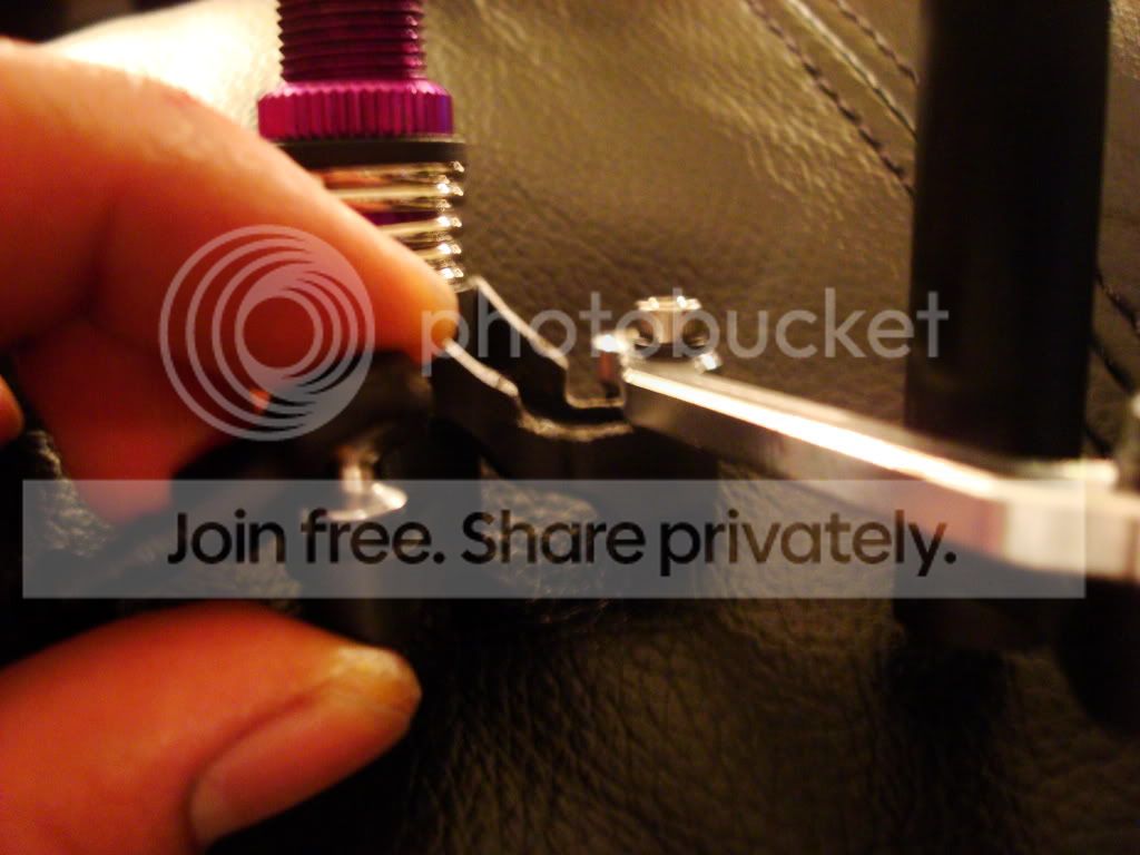

I did actually try shaving the turn knuckles just like in that link. I was hoping it would help my problems but it didn't seem to.
It could be numerous things, but if all discussed has been checked try this.
The plastic crank may be limiting the travel. I worked for me, but if you just want to take the thinking out of it. Get Golden Horizons Aluminum servo saver.
File away.
File away.
