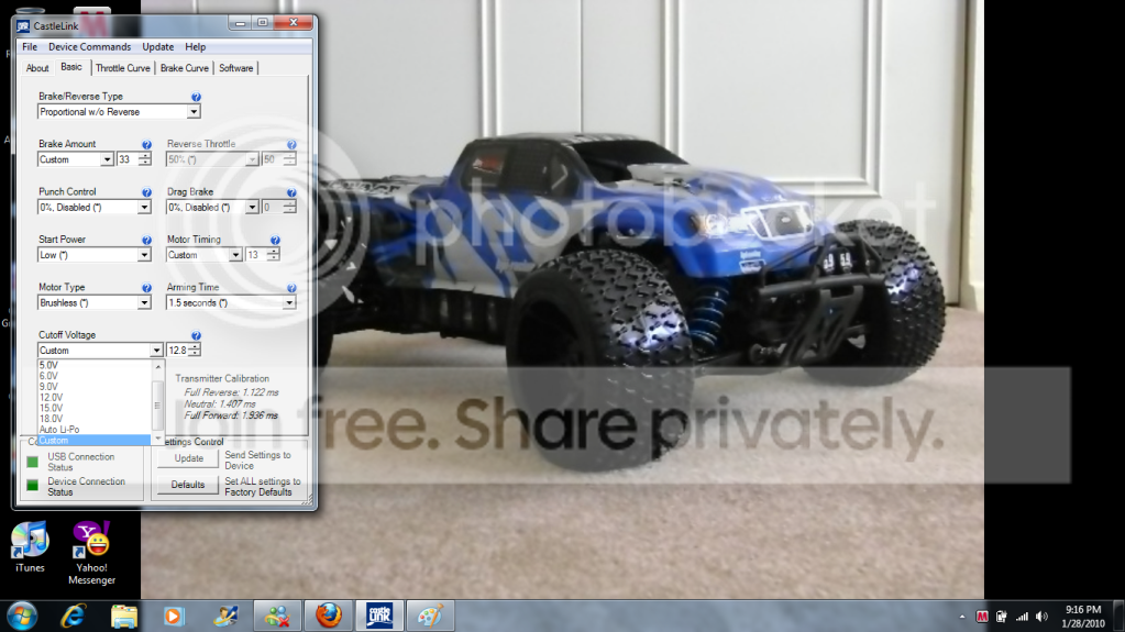

here are mine, never had a problem with this esc after 1 year on both 6s and 4s so something must be working.

Please post a screen shot & explain why you set it up this way.

the Big thing you want to do is set your LVC to you don't over dis-charge your packs and fry your system. I also set punch control to zero and just use the trigger for speed control.
i see that your gonna run stock gearing and am glad to hear it because most b/l system failures that ive seen are a result of gearing the truck too high and over working the system.
